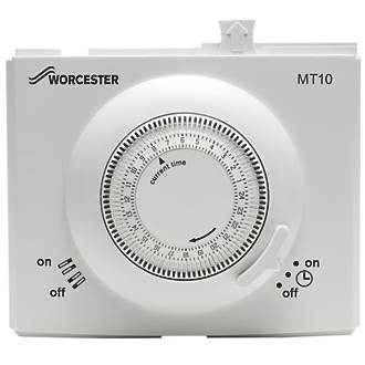

Hi,
I wondered if you can replace a digital thermostat timer with a old style analogue timer? I ask as my wireless one is not very great and i would like to set more times and temperatures per day than my thermostat will allow me. I used to have a analogue one years ago and was happy enough. My current thermostat is a RT500RF and allows you to set 5 times over 5/7 days.
So I have a Greenstar 24i Junior MK IV Combi Boiler and wondered what would be the best option?
something like this?
Also if this is possible then will I just have to mount this to the wall next to the boiler? or can i surface mount it to the actual boiler somehow? or course I will get a gas safe person to install if necessary.
yes the MT10 will slot directly in to your boiler facia, you will have to put a link in though when you remove the salus

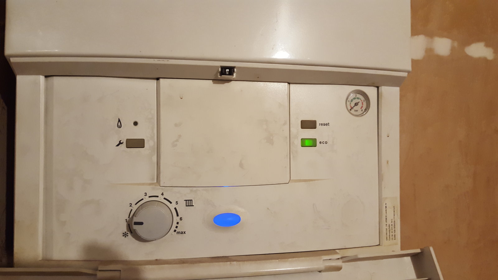

Would you be getting a standard room thermostat as well, or just replace the timer? Also your boiler looks like it has no pressure - might want to sort that as well. Do you know your boiler thermostat is low?

Thanks for this information, very useful, I will look into the bluetooth option. To be honest the boiler has a mind of its own and tends to fire up every ten minutes (even in eco mode). So the radiators were on all night even though the temperature I set was lower than the room temperature! My thought was to use a analogue as when they are wired in the boiler wont be able to fire up unless it reaches the timer slots. Not solving the problem but the main issue is the timer is rubbish on the RT500RF model.
Well hopefully just the timer. The pressure seems to drop when the boiler is off/idle, no idea why. When I turn the heating on the pressure rises on the boiler to around 1.2bar. I think something is wrong with this but will have to ask an engineer.
Thanks for that, I don't know much about the expansion vessel but I might test the pressure later against the guide in the manual.
