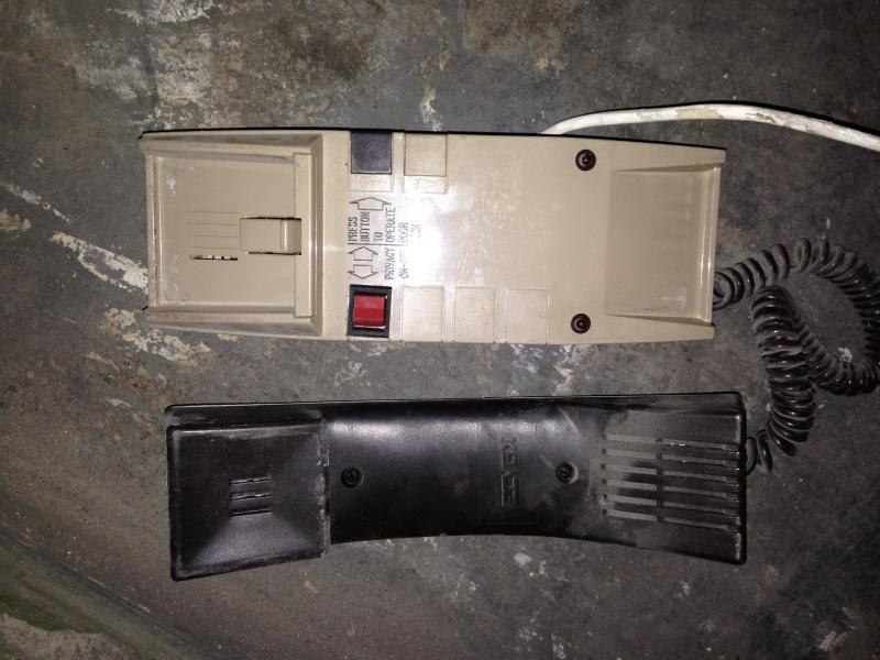

I've inherited one of these in my new flat.
It's situated 5 feet from the front door and unfortunately has 100 feet of cable wrapped up nearby.
The hookswitch isn't working reliably.
I want to shorten the cable and if possible replace the handset.
Is this a DIY task or do I need to isolate the intercom system before working on it?
Thanks for your assistance :D
That's a raytel system,does it buzz when it is called or give an electronic call ? as you can get a replacement white handset but should need to know what system it was.
Sounds like a fuse isolate system ! So you will have to be carefull if you shorten the cable , not sure if they do a replacement for the fuse isolate systems, best bet is carefully remove the front of the handset take a picture of the connections , snip off one by one but leave a bit of cable under each screw so you know where the cables came from
Google raytel security it's up in Scotland you can buy from them plus you will get the correct handset !
