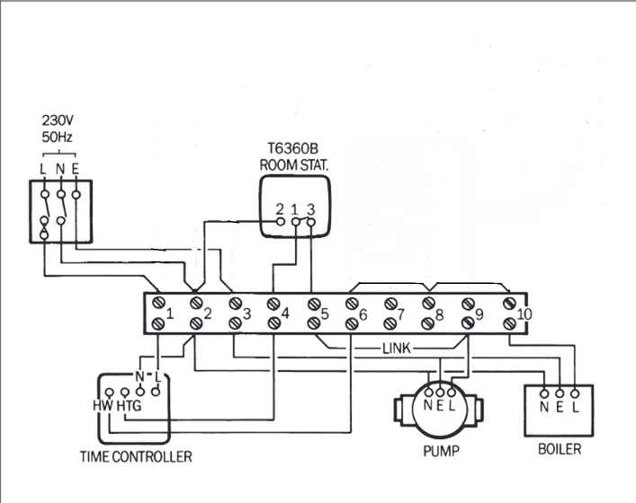

So the idea today is to combine the thermostat and programmer, this allows you to turn down the heating at set times rather than turn it off, but it causes a problem with the C Plan. This is the old C Plan.

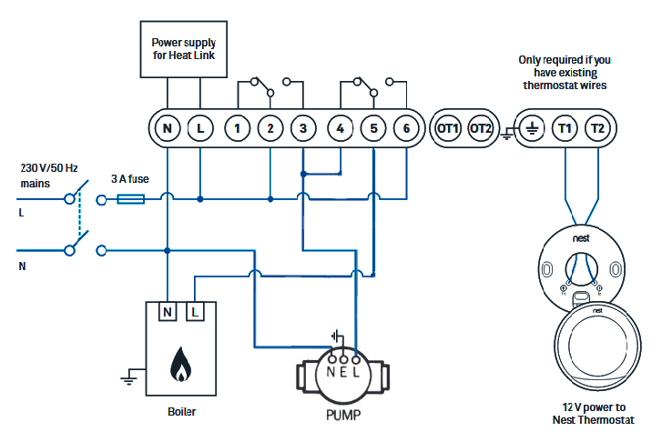

once you combine the time controller and wall thermostat you have a problem. The time controller switched on the boiler and pump through the thermostat when central heating is required and only the boiler when DHW only is required. Hive wall thermostats can be also configured internally to do this, so one output to pump and one to boiler. But Nest has no internal setting however it does have volt free contacts so this
allows it to still be done, but boiler fed from common not the normally open contact, which is reverse to normal, and often the common is internally linked to line, so many systems can't be wired to work with C Plan.

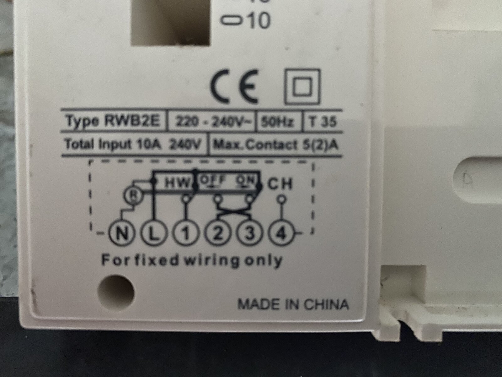

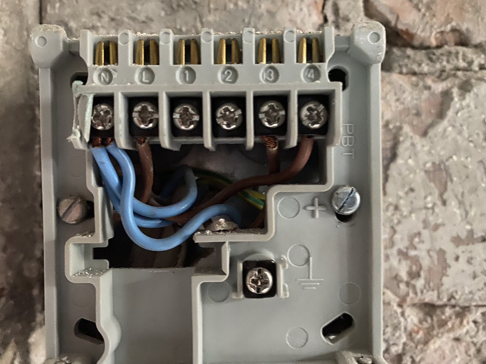

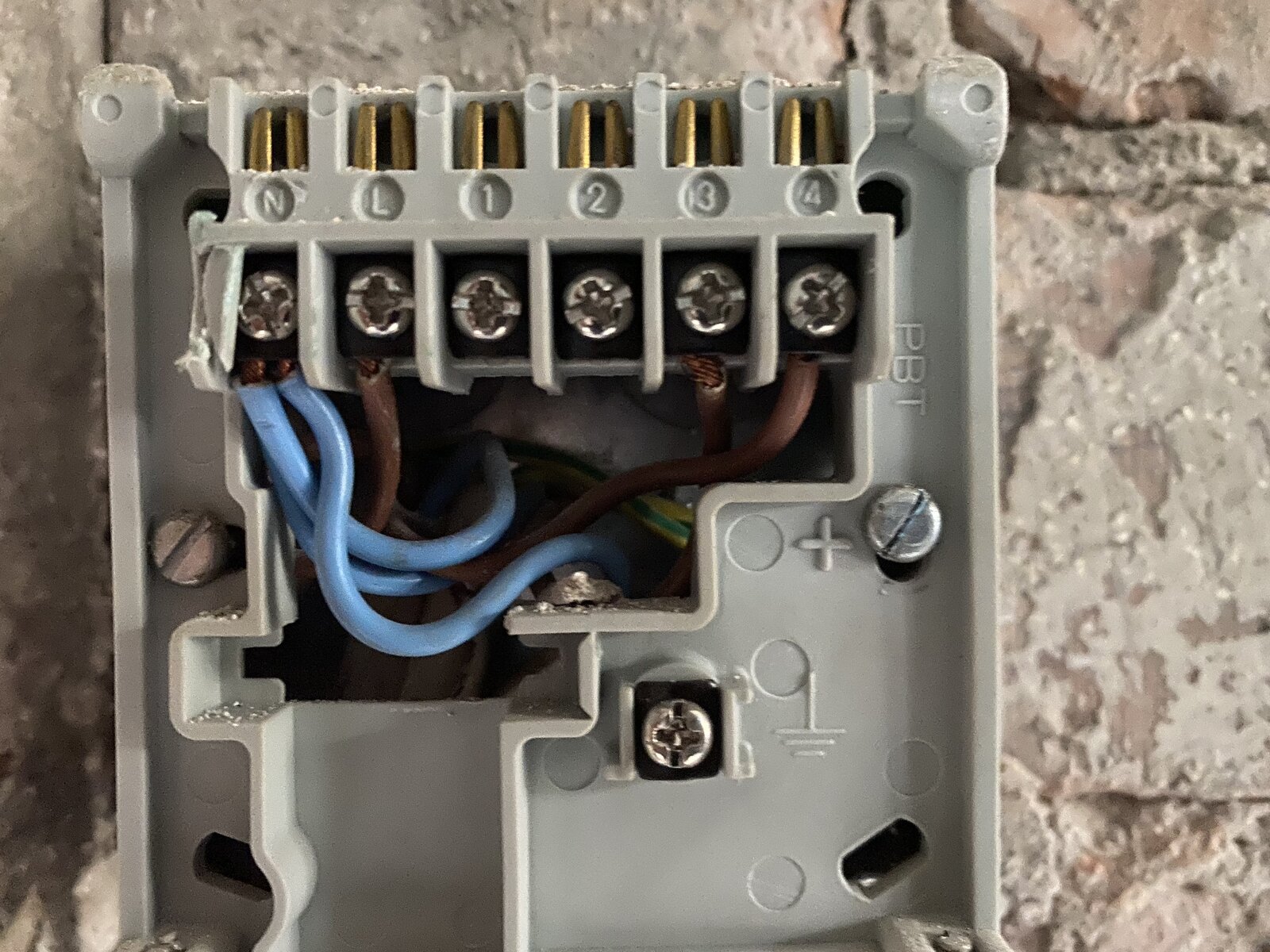

What a comprehensive answer, thank you. I have added some photos of the controller and the wiring. There is no valve anywhere as far as I can tell. The boiler itself has a control to regulate the amount of heat output but there is no other thermostat. The hot water appears to only be an immersion heater but I can’t be sure. I think if there is no valve though this is most likely??
Regards
D

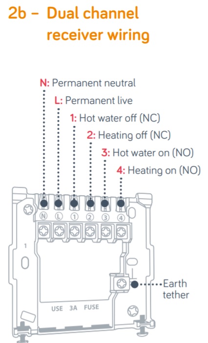

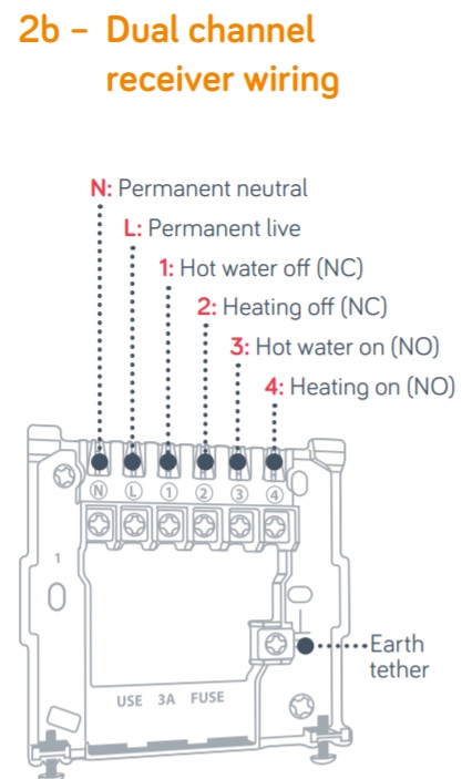

Looking at the Hive installation guide it shows a common live and then CH ON and CH OFF are at positions 2 and 4 (see image attached). In my set up it shows that there is a live at position 3 and position 4. One of these goes to the boiler (position 4 I think) and one goes to the pump. Would I therefore have to rewire this to take my position 3 to their position 2 and keep my position 4 going to their position 4?

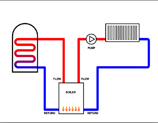

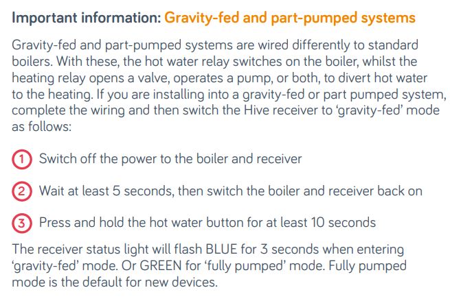

If you don't have motorised valves it's likely that you have a system with pumped central heating and natural circulation of hot water around the cylinder like the diagram below. This type of system is much more common than a C Plan.
With this type of system, it's not possible to have the heating 'on' without the hot water being 'on' at the same time. A Hive Dual Channel version can be used, but it would need to be set to operate as below:
As you have wires in both terminals 3 & 4, it would appear that both heating and hot water are connected to your existing programmer. Terminal 3 is for the Hot Water and terminal 4 is for the Central Heating....
....which as you will notice, is exactly the same as the Hive Dual Channel diagram that you posted. Terminal 3 will control the boiler to heat the hot water by natural (gravity) circulation. terminal 4 will start the pump to heat the radiators.

One of the usual clues is the number of water pipes connected to the boiler, if yours is the type of system I described, then there will be 4 pipes. 2 for the central heating and 2 for the hot water, as per the diagram.

No follow the pipes, I have a C plan or thermo syphon or gravity which ever name you like, there is no electrical connection to the cistern other than the back up immersion heater.
If not sure turn off the immersion heater and see if you run out of hot water.
I am an electrician not a plumber, I employed a plumber to alter my system, he tells me if the pipe work is done correct, then the pump starves the thermo syphon and you only get central heating, but at least with mine this is not the case, in summer I have it set ½ hour every other day, four days a week, and in winter turn off the domestic hot water (DHW) and it heats it anyway.
