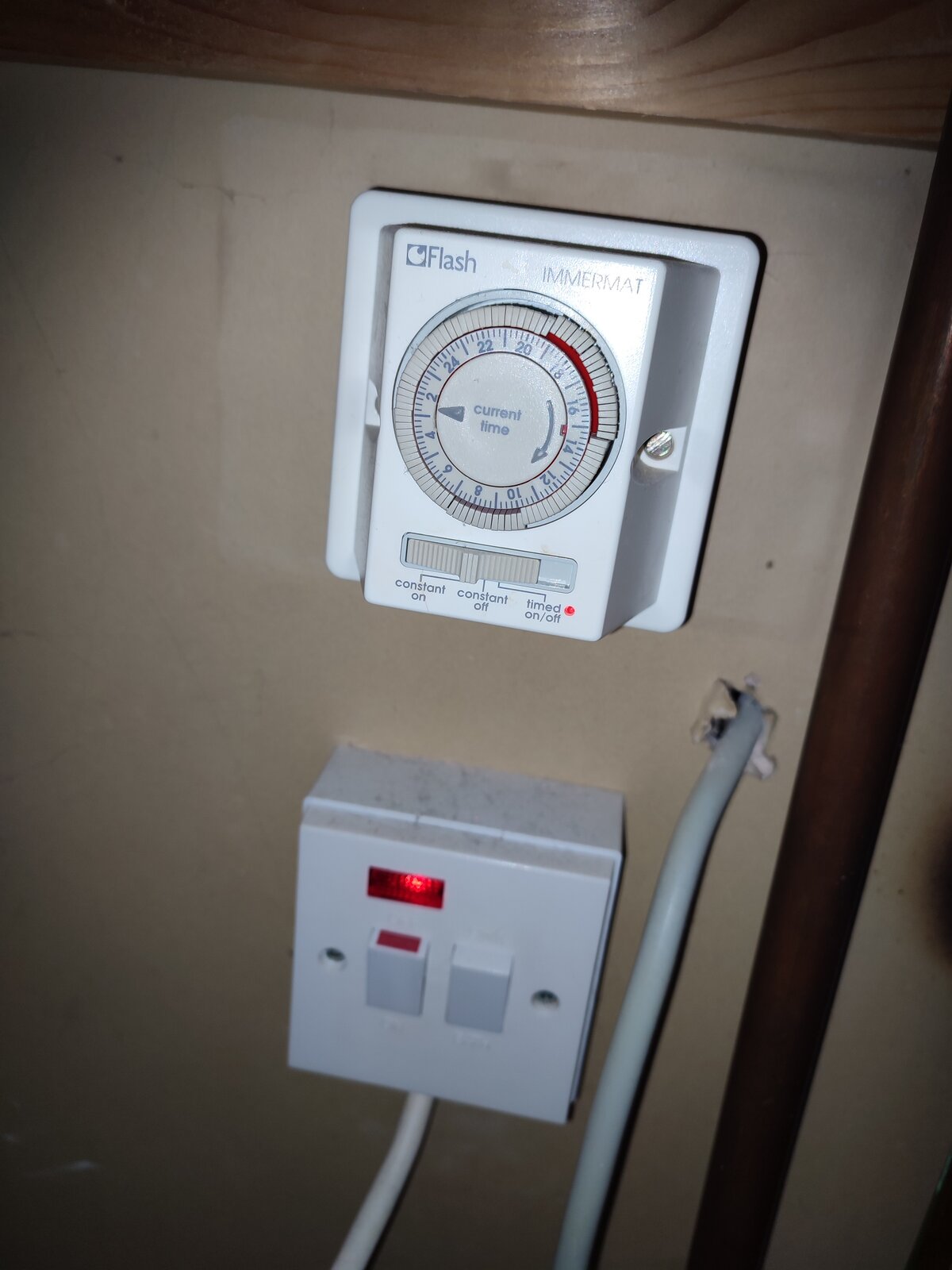

I'd like to replace this flash immermat programmer with something smart that can be controlled/programmed remotely. It only controls the immersion heater, and should be rated at 20A (Ireland).
Can anyone recommend something reliable/safe?
Could you elaborate on why? As a non electrician, i'd expect a fused switch to be a safer option than a non fused?
For a start it is not needed on an immersion heater circuit, and
fundamentally because (a lot of) the 13A fuses and fuse holders in FCUs and plugs do not like being fully loaded (12.5A) for hours on end - they heat and become loose.
Having said that I have known one which has lasted 'forever' as they should but you cannot tell which will and which will not.

A workaround, would be to use a normal, cheap smart plug or switch, powering a small contactor, or relay, rated at 20amps. They tend to rate immersion heater switches etc., at 20 amps, because they tend to be on for extended amounts of times, and fairly regular.

I did ask in the non-UK forum but it doesn't appear to get a lot of traffic!
As for why I want a smart switch? Why does anyone? In the winter the heating looks after the water, but in summer when the heat is off the water is usually only heated as needed, for showers etc. I don't use the clock timer function on it because my bedroom is on the other side of that wall and I hear the damn thing ticking away. So we manually switch it on/off, and I've forgotten to turn it off too many times. If it even just had a boost button I would be happy. But in this day and age, if I'm going to go to the effort of swapping it out, I may as well get as many bells and whistles as I can, so remote control, ticking-less timers etc.
