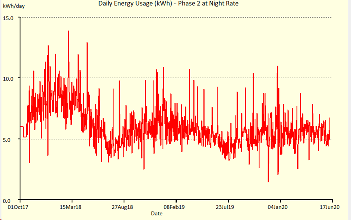

As I said, in my case with the manufacturer's insulation (not sure how thick) plus ~200mm more of mine, my cylinder was still losing a lot more than a 'miniscule amount of heat', since loss reduced appreciably when I upped that 200 mm to 600 mm - using E7 electricity, that change alone reduced water heating costs by £5 - £6.50 per month, so the saving relative to 'the cylinder alone' must be much more than that.

Thanks. That's a fair bit more that I am (now) using - which averages out at 5-6 kWh per day. However, as you can see from the graph below, before I upgraded from ~200mm to ~600mm in around May 2018 I was using not that much less than you (around 8-9 kWh/day. I therefore would imagine that before I had even that extra 200 mm of insulation, I was probably using at least as much, if not more, than you ...

Yep, deadly serious :) It is a large cupboard with a 'floor area' of roughly 2m x 2m, and at least 2.5m tall. The cylinder is sitting on a slatted shelf a couple of feet about floor level, and behind a slatted door (seperating it from an 'airing' area, which still gets reasonably warm!) and the entire cupboard, is crammed (around all sides of cylinder, and above and below it) full of insulation - basically everything I had to hand, but mainly rockwool and fibreglass etc.

No, but it's in a part of the house which is not heated all that much - as you can see in the above graph, there is, even now, still a fair bit of seasonal variation.
Is your electrical monitor reliable?
Extremely reliable. Over the period since my electricity meter was last changed, it has recorded a total of about 32,000 kWh, and the total recorded by my monitoring system during that same period differs from the meter by only about 30 kWh (i. an error lf less that 0.1%). Although probably not clear from the title of the above graph, it essentially relates to just the immersion circuit.
