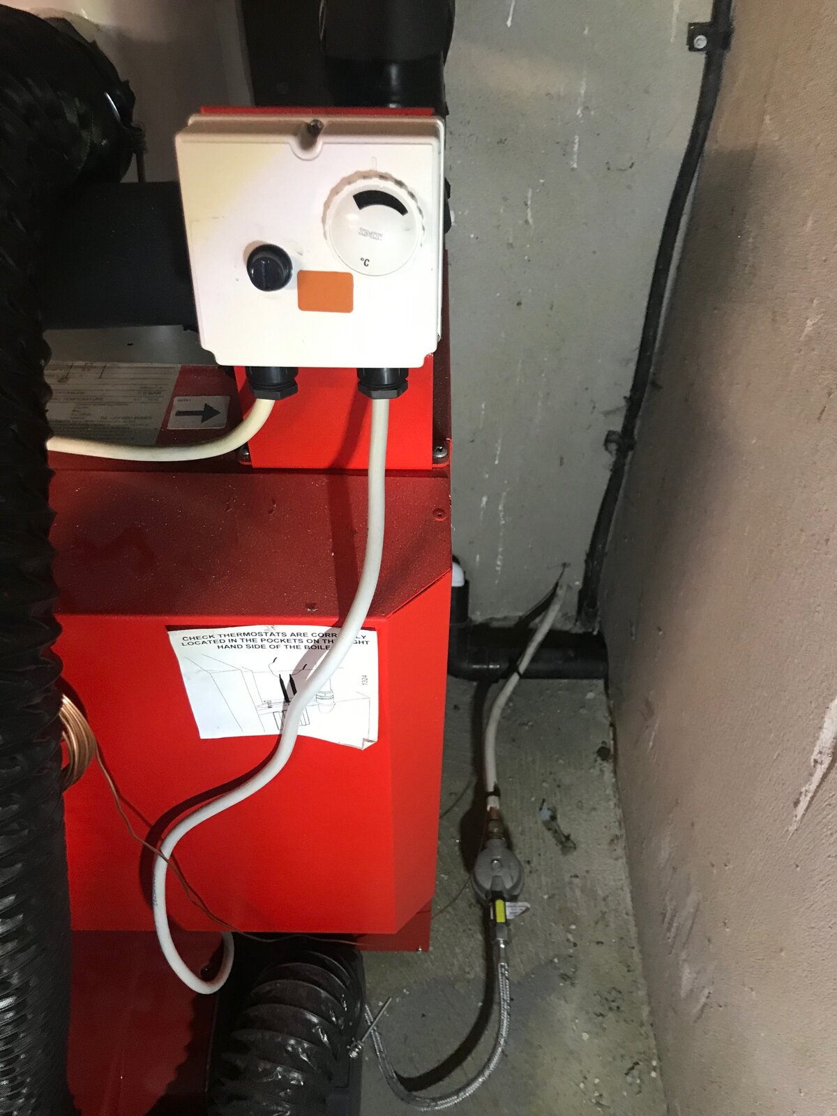

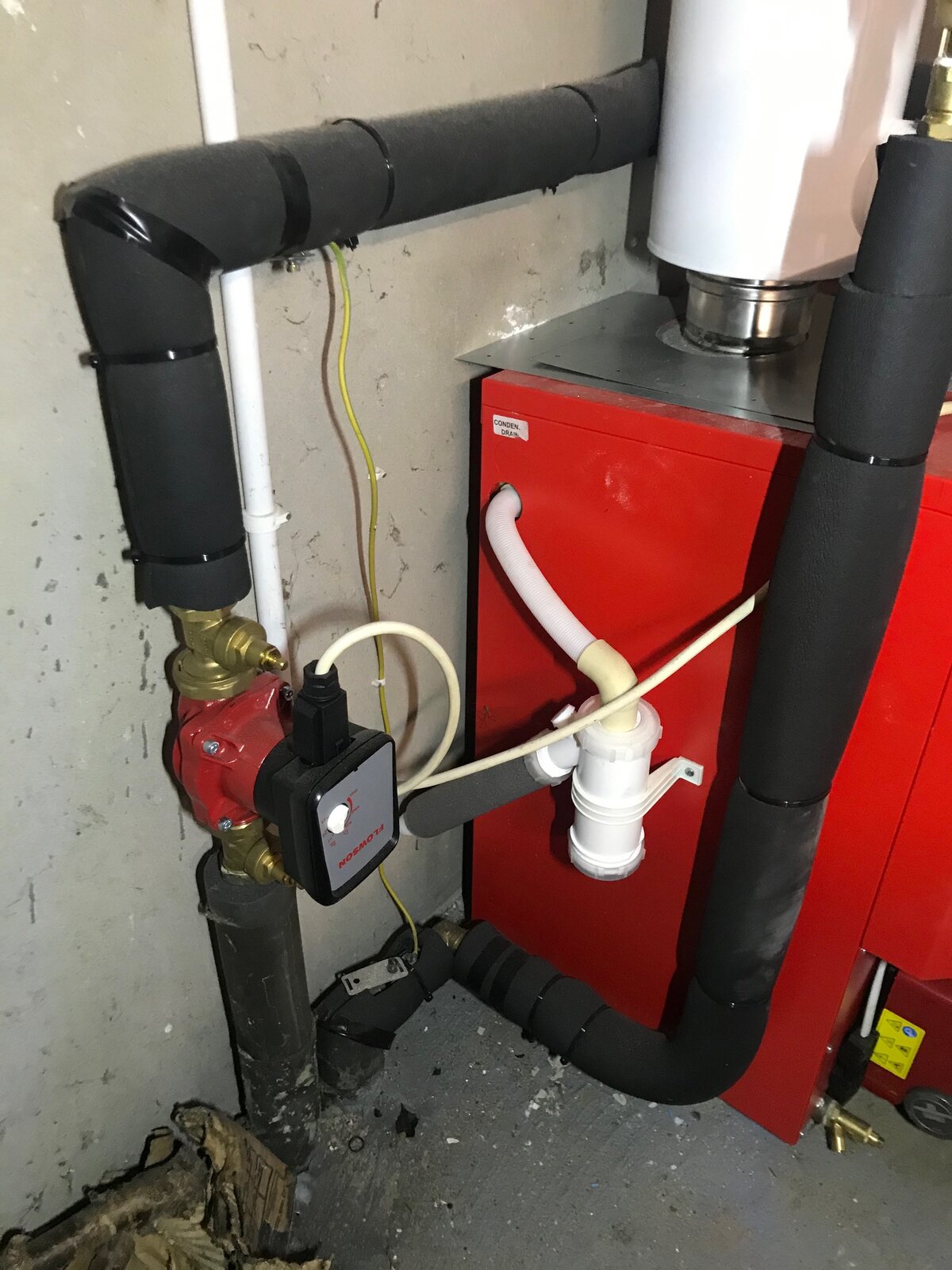

Pictures of the oil boiler attached. It's a Grant Euroflame Condensing Boilerhouse 90-120. We replaced the original boiler with this around 3 months ago. I'm all ears if there are any suggestions to control the heathing and hot water separatley but I don't think it's possible from what the engineer said.
There presumably must be some sort of 'control unit' in addition to what you've shown us?
Kind Regards, John
Sure. See attached. That's pretty much everything in the garage surrounding the boiler.

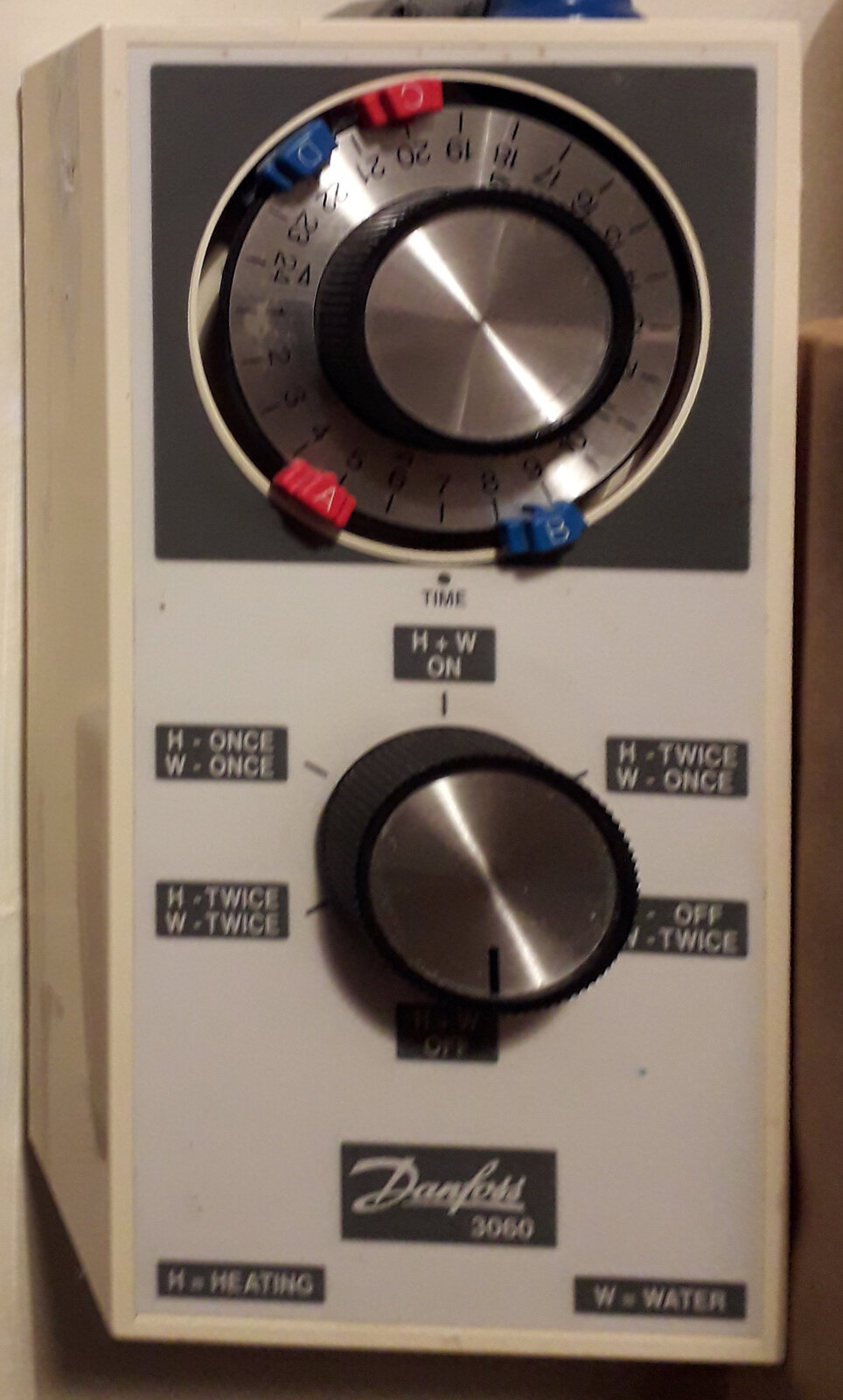

I asked my plumber about my oil boiler, in my case a Bosch, and he said there was no run on built into the boiler to cool it after flame had extinguished so to put a motorised valve on the domestic hot water (DHW) would but extra strain on the boiler, the only option is either the old C plan or the Y plan as in both cases the default is DHW open so thermo syphon will allow the circulating water to cool.
The C plan had three stages, as time went on.
Stage 1 was really where the central heating was simply to have a warm bedroom to get up and go to bed in, it was traditionally on a timer and would fire up twice a day, morning and evening, and the open fire would be used during the day, they used a timer like this Danfoss3060programmer.jpg so you had an option of once or twice a day, DHW only or DHW plus CH. The method of stopping the central heating working was to simply turn off the pump, but often the water would thermo syphon through upstairs radiators anyway, but they would not get to full heat, minimum time was around 2 hours a day, and we found that was a lot longer than required. I could result in either water not hot enough in summer, with legionnaires being a worry or getting up stairs radiators hot in the summer.

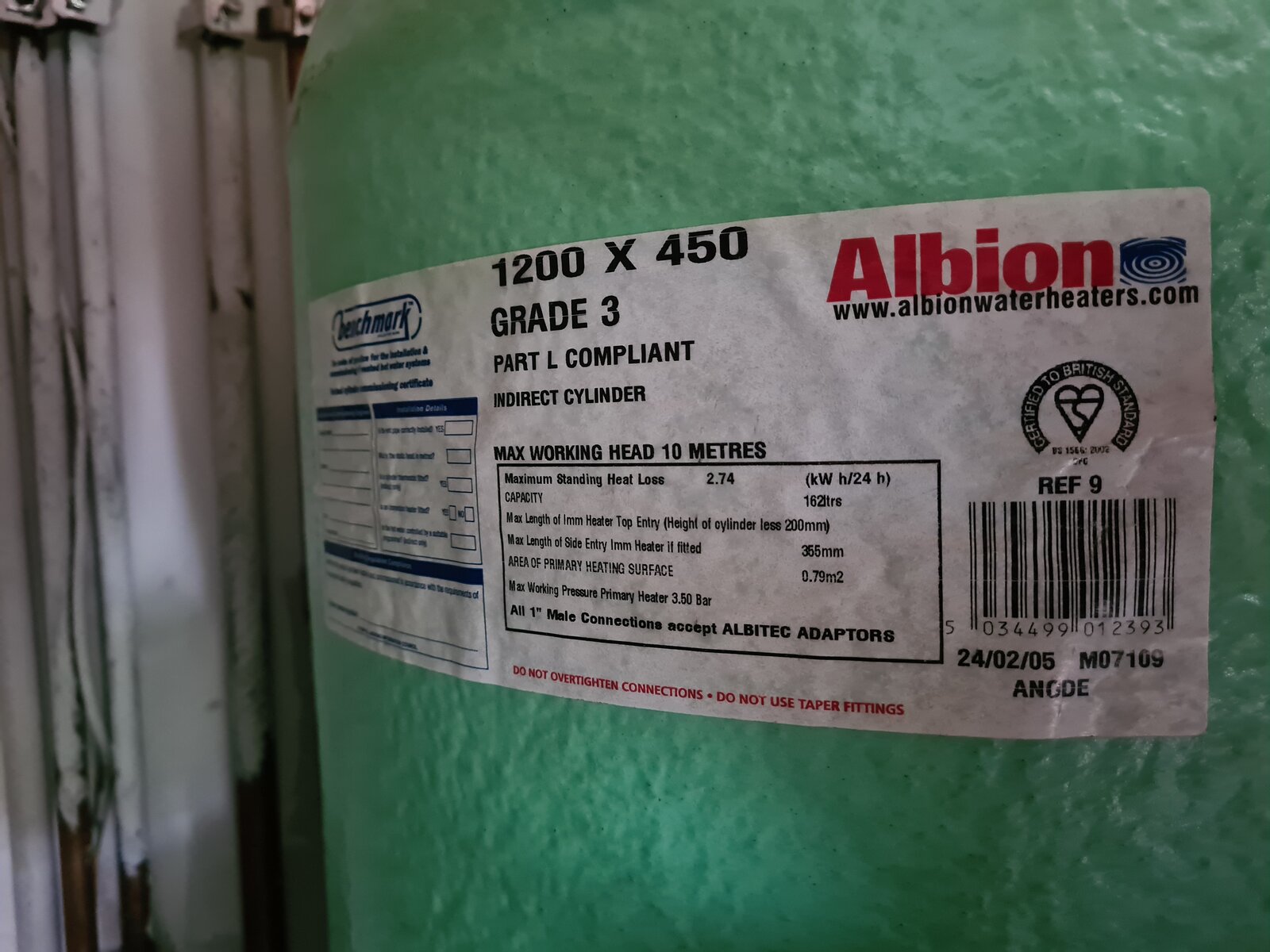

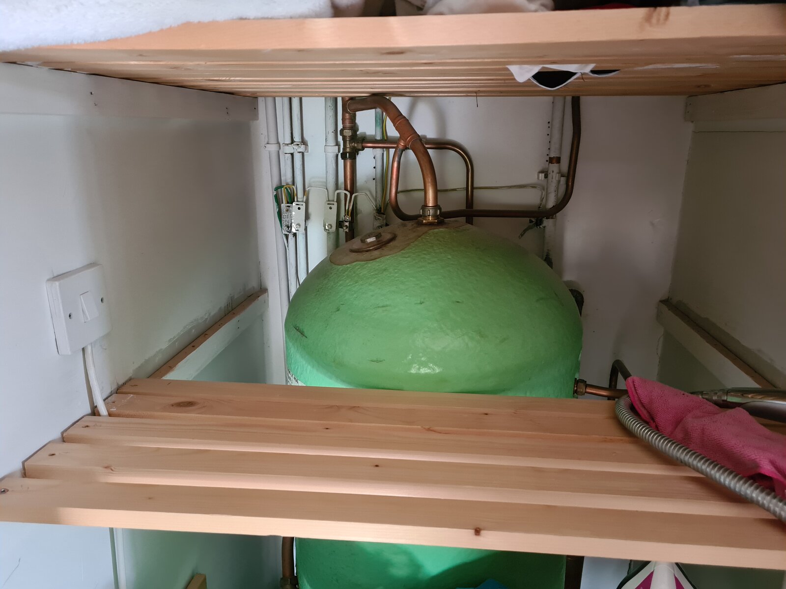

I suppose its possible the system isn't zoned but it is unlikely- yes please to pics of the airing cupboard and whatever the controller was

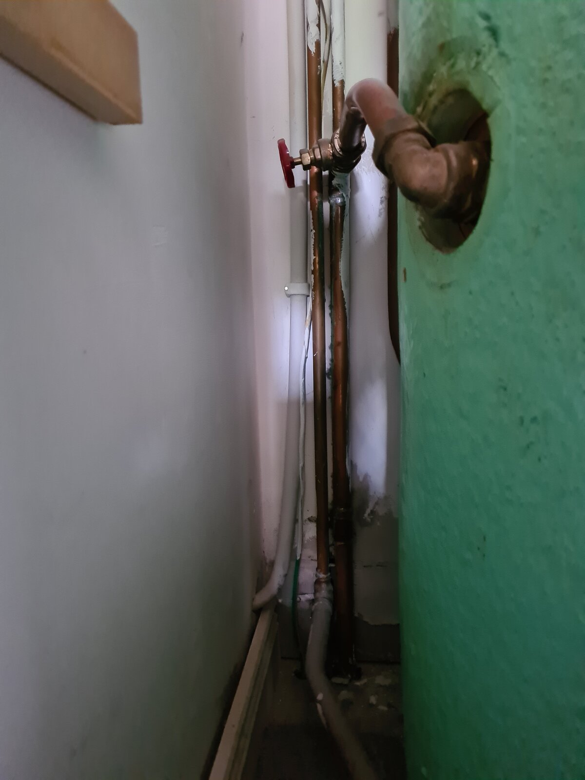

Ok, no sign of any zoning there, the hot water cylinder is just connected as another radiator.
There appears to be a gate valve on one of the coil connections (prob flow but no guarantees) so replacing that with a 2 port motorised valve and some wiring and control gear would allow heating only or heating plus hot water (not that useful i know).
Having hot water only depends on the layout of the pipework. Can you do a topographical map (like the Tube map, doesn't have to be to scale, just needs to show the sequence of devices on the main 22mm circuit from the boiler

Why is that safety valve outlet on the boiler not plumbed in?

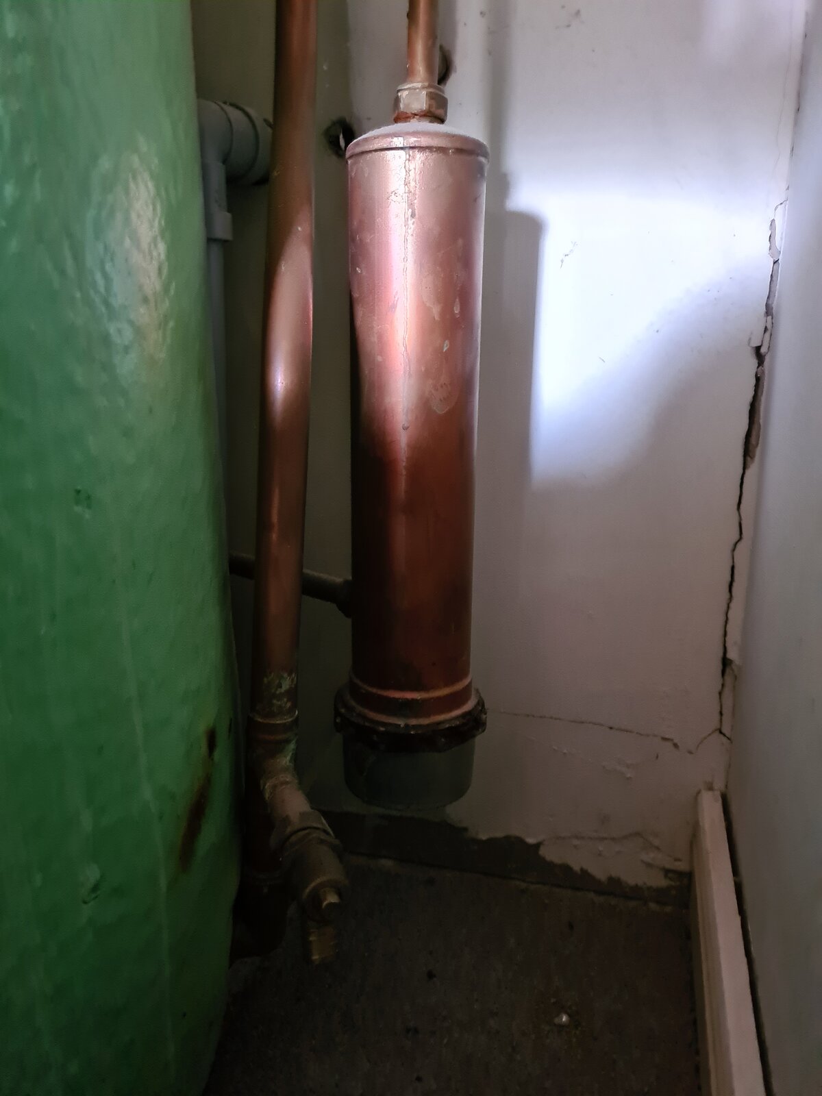

Why is there no backup immersion heater in the cylinder and what is that mini cylinder doing next to the hot water cylinder?

What is that bizarre immersion heater doing in the base of the small cylindrical device next to the hot water cylinder?

What is that bizarre immersion heater doing in the base of the small cylindrical device next to the hot water cylinder? Not sure what this is. Presuming it is what @EFLImpudence posted.
Is the system sealed (it has a red expansion vessel) or is it a traditional open vented (ie there is a small cistern above the highest radiators)? There is a couple of tanks in the roof space if this is what you mean?
What a pointless device...the heatloss from a modern cylinder is negligable.
The noise must be immense heating up such a small volume, gravity circulation through such small pipework will be hopeless.
