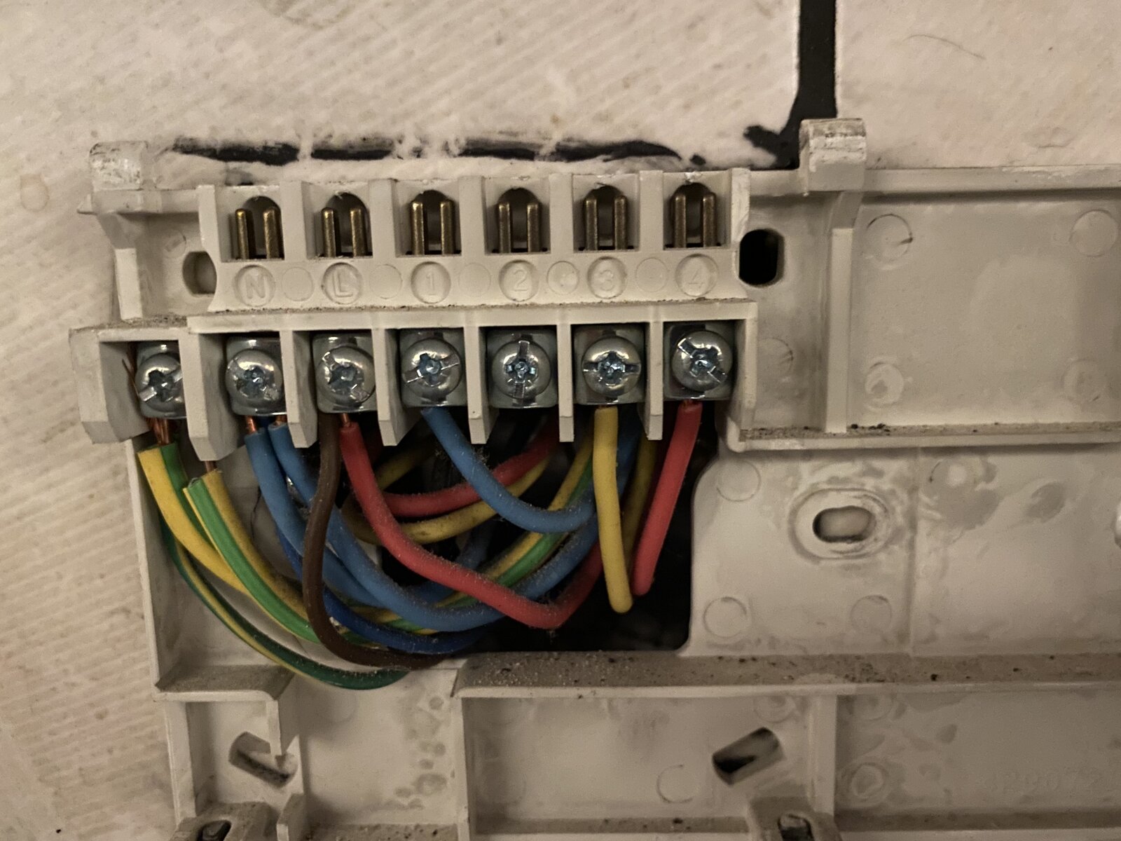

2) Having removed the cover of the ST6400C (attached), I seem to have more wires that other photos I have seen on this forum. I get the first three are E,L and N, but does this look right?
3) Reading the installation guide for Nest, it seems possible (and not too hard) for a competent DIYer to fit it. As I don’t need the room thermostat anymore (will use the wireless feature), is it as simple as working out which connections go to which on the new Heat link?

I think you have a y plan system so heating on, hot water on and hot water off wires in programmer, so wiring appears ok. I do think you had unreasonable expectations, and prices can vary up and down the country. Competent DIYer should be able to sort yes. Nest is only wireless through phone app, still has power via wires or usb plug.
Thanks Chris. Yes, I should have said, I only have a single motorised valve for water and heating (under the hot water cylinder), which I think makes it a Y Plan rather than S.
I am tempted to try to fit the Nest myself, is there an easy way to know which current wire will map to the Nest?
Nest instructions are pretty good, and the rear of Honeywell should indicate which wires go where.
Thanks again. I’ve had a look at the Honeywell wiring diagram, and this is what I have so far....
Current Honeywell (ignoring L,N & E):
1 - HW Off
2 - CH Off (Not used on my installation)
3 - HW On
4 - CH On
One the Nest Heatlink (again, ignoring L,N & E and the 12V supply for a wired thermostat), there are only 3 connections:
1 - Satisfied
2 - Common (Optional)
3 - Call for Heat
Any ideas which connections map to which, based on the above?

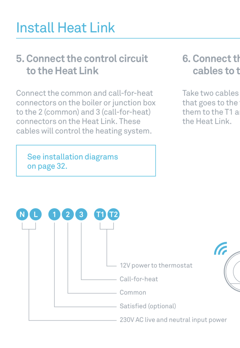

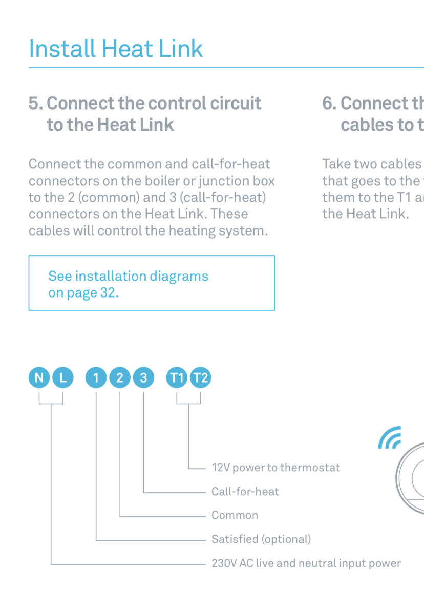

Err, what nest is it you have? That looks like it could be for a nest e?
This
is the Nest Gen 3 diagram for the UK, there is also Nest e and there is Nest for USA but the diagram you show not seen before. Nest is basic designed for hot air systems, with hot air we have vents in the walls pumping out hot air and vents in internal doors so the hot air can return to heater, so all house is controlled by one device, in the UK we do have some homes with hot air and some open plan homes, but in the main we have homes with radiators and internal doors, and Nest only controls the heat in one area, it does not have the ability to link to more than one thermostat, most high end thermostats used in UK link to other thermostats be it wall mounted with EPH or radiator mounted with TRV heads.

@Chris_W - I’ve not yet purchased the Nest, but you are quite right, I was looking at the Nest E instructions, when I should have looked at the Nest 3rd Gen ones.
Kindly, @ericmark posted the right schematic! And thanks for the background information, very interesting, especially about the thermostat position.

I am still intrigued if I can do this myself. With the schematic supplied, I think:
- Honeywell Connection 1 (HW Off) - Where does this go?
- Honeywell Connection 2 (CH Off) - Not used
- Honeywell Connection 3 (HW On) —> Nest Connection 6 (Call For Water Heat)
- Honeywell Connection 4 (CH On) —> Nest Connection 3 (Call For Heating Heat)
Is that right and where does Connection 1 go to on the Nest?
