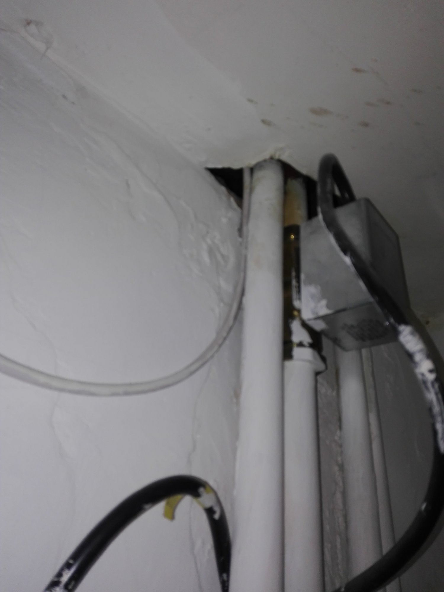

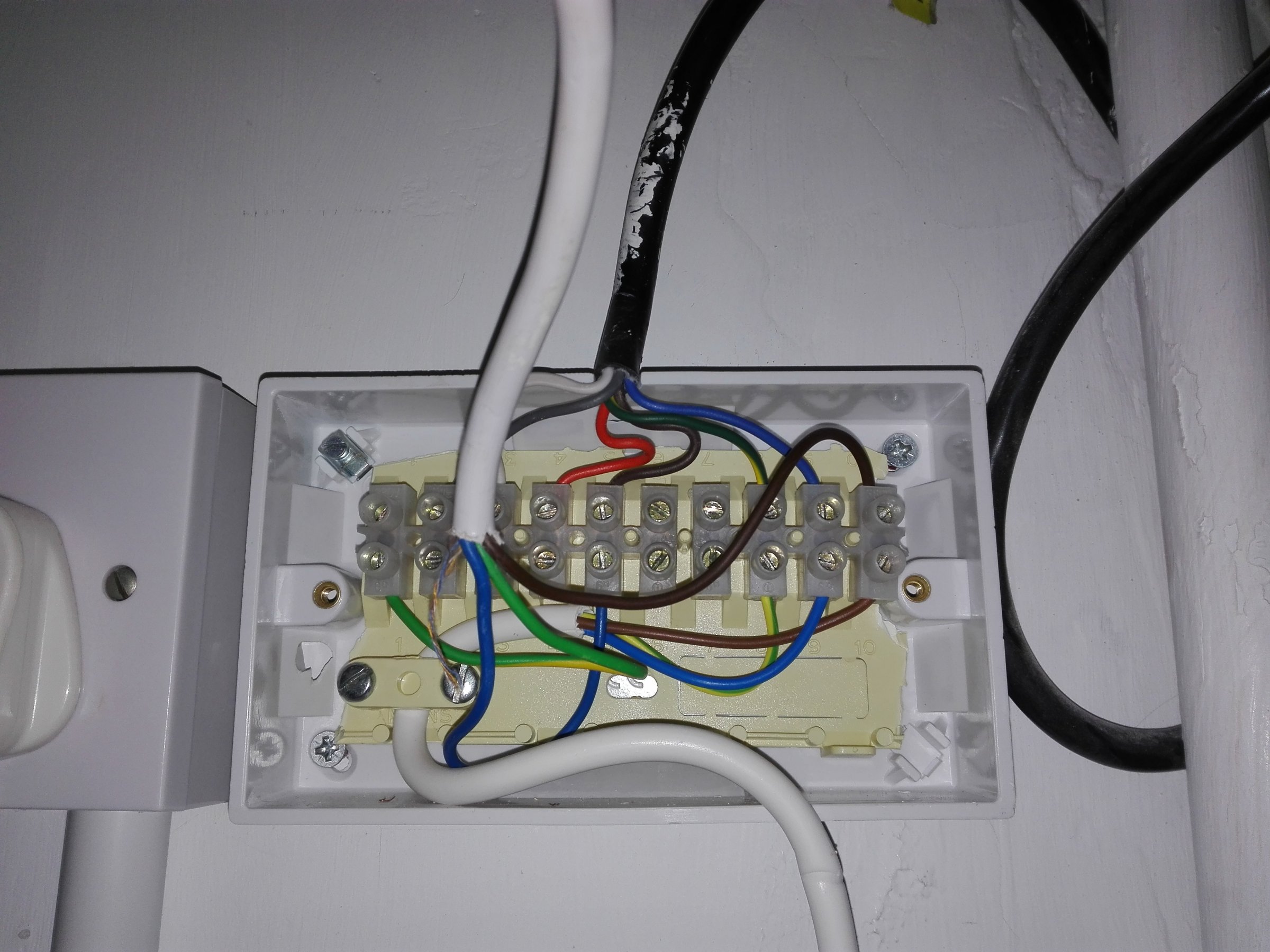

No wires go to the boiler control except the L N E supply then the return from the wall stat (goes to pump) and the live that goes to the boiler then... So, no wire comes from the cylinder stat or the valve..
I know i said it could wait, but would you like pictures/a wiring diagram!?
Go on then spoil me :)
I would be interested to know where all of the wires from the motorised valve go also.
