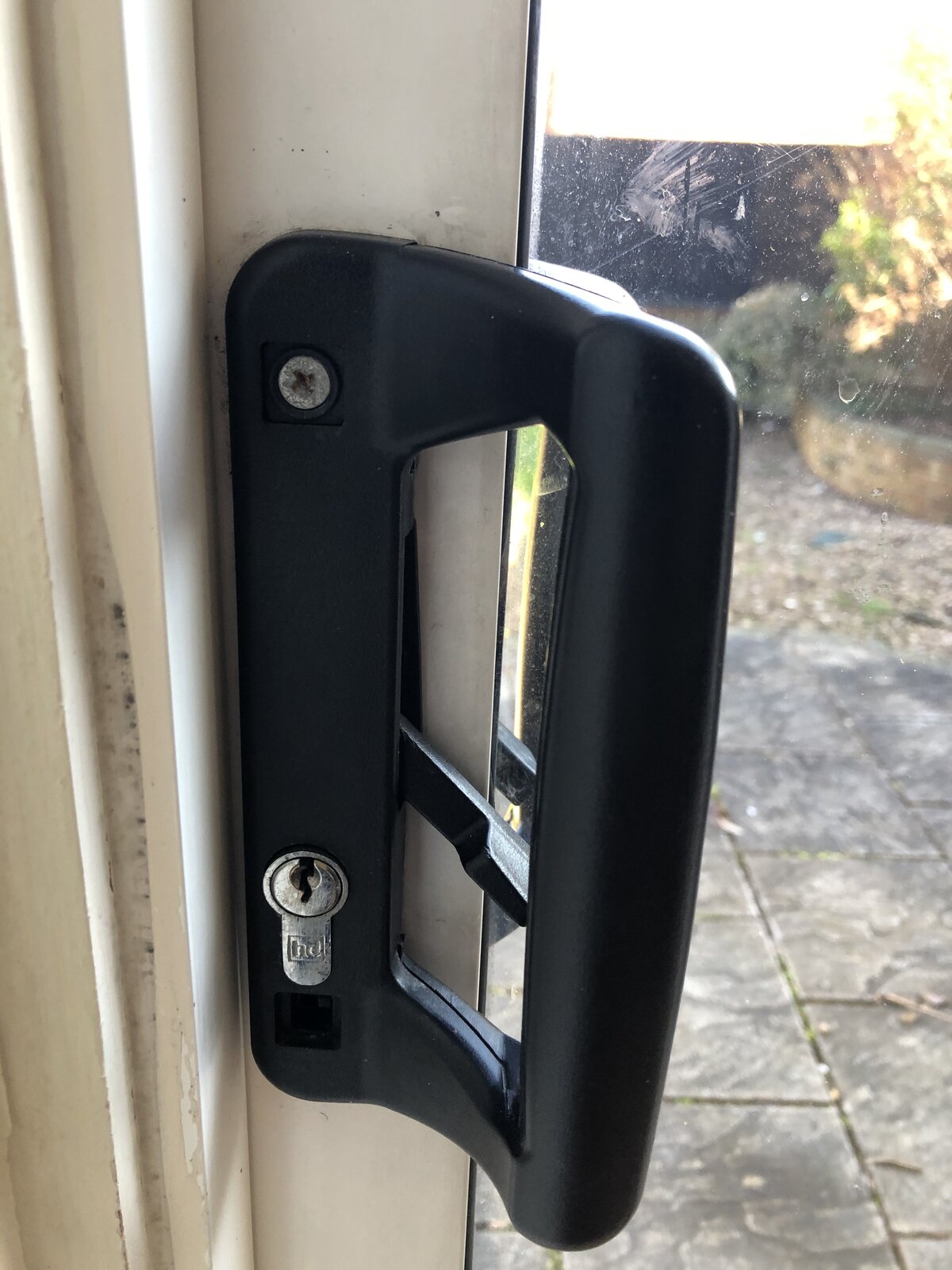

Hi everyone how easy is it to replace the handle in the pic with a Schlegel Style Metal Patio Door Handle With Built-In Levers.
Wanted to ask before I attempt it..

Just those 2 screws, the run through the door and screw into the other handle, when refitting just make sure the lever is in the same orientation as it was when you took the handles off, many times I was called out where the lever was stuck, customer took handle off with lever down but fitted new handle with lever up and couldn't work out why the lever wouldn't move
Thanks for the tip!! So I take it that these would fit? https://store.northwesthardware.co.uk/Schlegel-Style-Metal-Patio-Door-Handle-With-Levers.html
Should do, the description says they are a direct replacement. Used HWH for my own and company stuff, top guys
