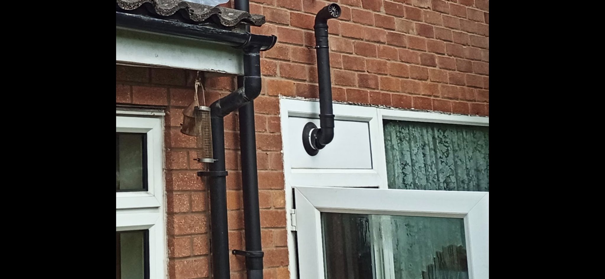

I'm lowering the ceiling in the ground kitchen from 2.7m to 2.4m and insulating the gap above by using a 38mm x 68mm CLS timber frame. Usually I would screw this frame into the brick wall using masonry screws but there is a high window that comes up to 2.6m. The window has 2 units 1 lower (swings) and 1 upper (fixed). The window's upper unit (2m to 2.7m) needs to be replaced with a plastic equivalent. Can I buy and fit myself a plastic equivalent by calling up a window specialist e.g. https://www.wardgroup.co.uk/double-glazing-glass? A follow on question is that to extract the cooking fumes I need an extractor fan or extractor hood and the previous kitchen cooker used a grease trap (now binned) so can I core a hole through the plastic (to be fitted) upper window unit and fit an extractor fan?
Advice please!
You can get plastic panels to replace glass units.
They also make them with metal inside for security.
Is that what you want?
This is where I had a glass panel replaced with uPVC to run a flue through.
I know it's not quite what you want to do, but shows it can be done.
