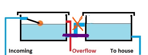

One inlet would be easier; I just wondered if the old tank might have a little stagnation at the top with the water entering and leaving at the bottom - the tanks would also refill quicker. Happy to go with the advice of just one inlet though, if you think it's better.
Good call on the isolator between tanks; hadn't considered that.
Russell.

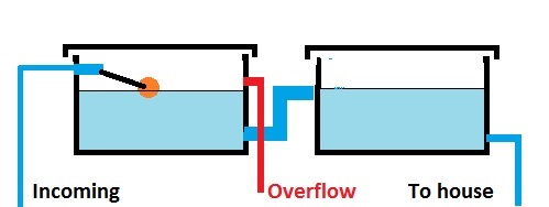

If you are wishing to tandem the cisterns then you would pipe them together using 22mm pipe and feed the hot and cold circuits from the cistern without the fill valve. This allows the water to circulate through the primary fill cistern to the secondary supply cistern keeping the flow and circulation constant avoiding stagnation. A proper bylaw kit on each cistern would also help.
TBH I wouldn't see why you would want to put a valve in between, you would normally have a full bore valve on each outlet to isolate each supply if servicing is needed.
The alternative method, usually used in larger 75+ gal systems would be to have both cisterns mains supplied via 22mm on a delayed float valve and then 1 28mm distribution pipe from each cistern joined together in a header/manifold arrangement with 22mm system supply pipes branched from the manifold to each required circuit.

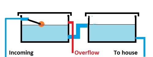

My original sketch was not well drawn, the feed to the second cistern was drawn too high.
Joined at the bottom does have the slight (?) disadvantage that the surface and upper layers of the water in the second cistern are not agitated when water is drawn. This could result in a layer of "crud" developing on the undisturbed surface.
WRAS give advice https://www.wras.co.uk/downloads/public_area/publications/general/information_note_guidance_for_connecting_storage_cisterns.pdf
