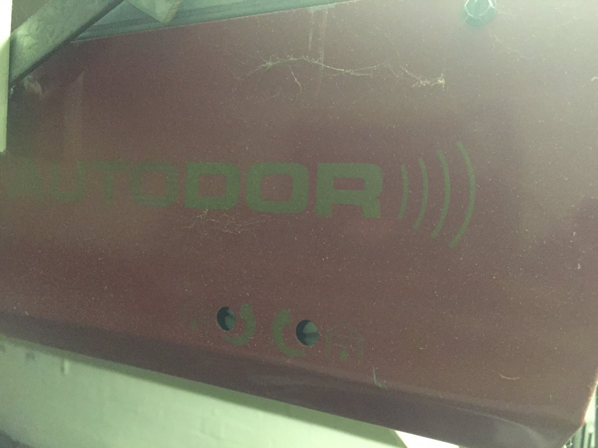

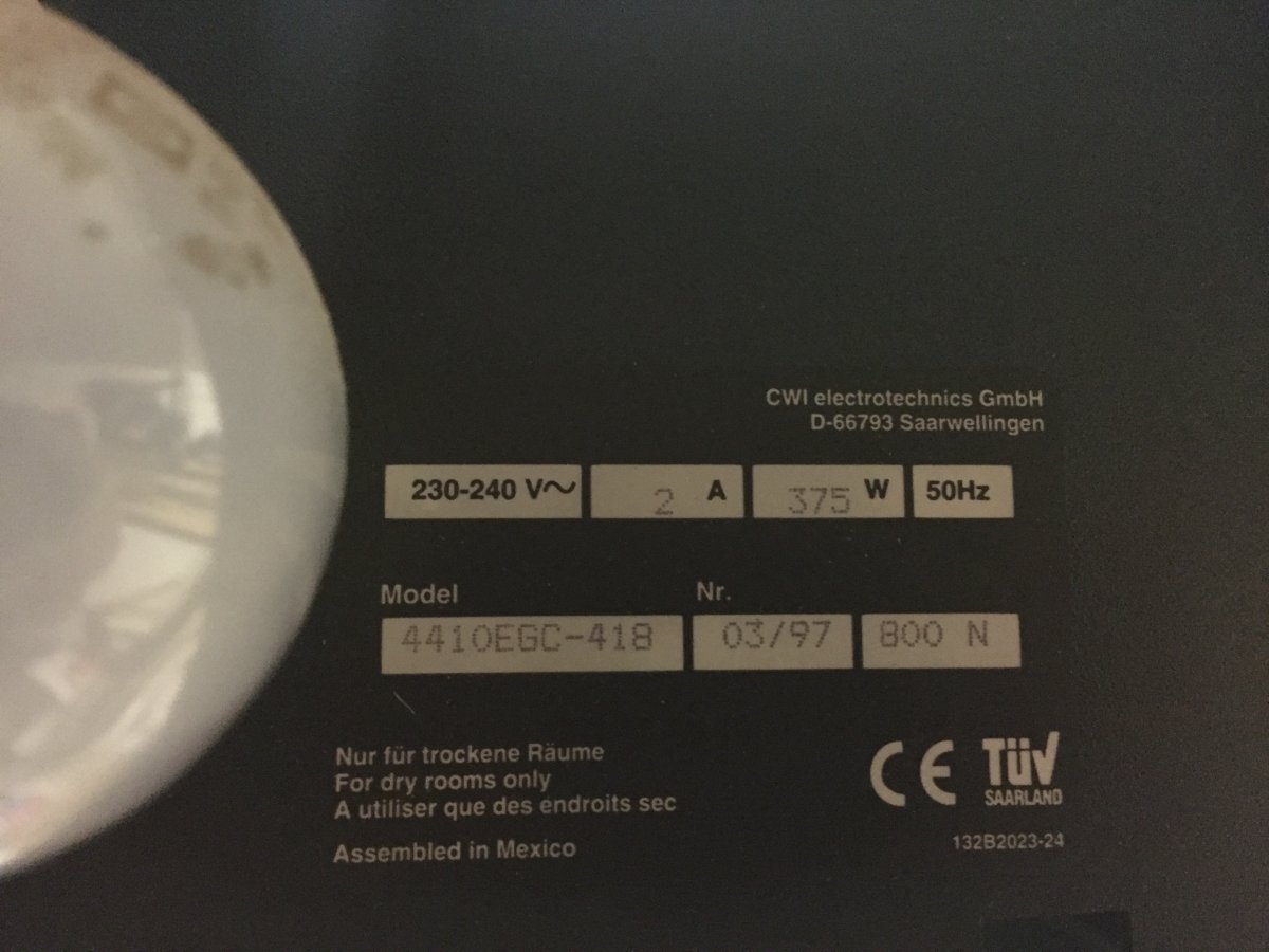

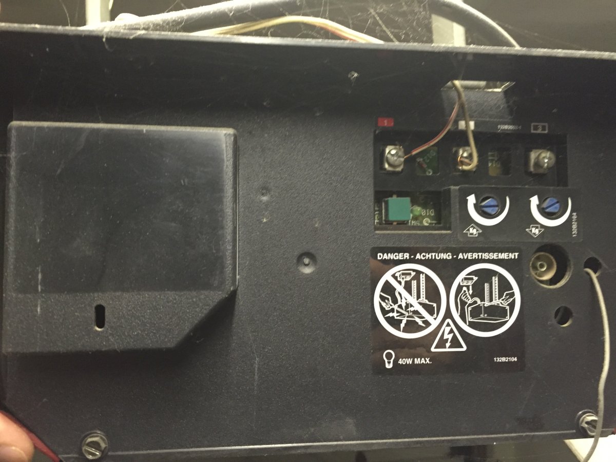

Hi,
I have got an Autodor remote garage door installed. It's working fine but want a smaller fob as the one supplied is only 1 but quite large.
The garage unit model is 4410egc-418.
Does anyone know how I can get a new fob and how to reprogram as I can't find any manuals.
I will attach some pictures shortly.
Here are some photos...

Your transmitter is 418mhz
You will struggle to get that frequency as no longer available.
You could purchase a WIR250 2 keyfob with receiver and connect to your existing garage door operator using the press to exit connection as your trigger for the receiver.
Hi thanks for your reply. Where can I get one of those from? I was also looking at a GSM receiver to open via phone too? Is that possible if I replaced the receiver unit?
WIR250 is cheap fix for your garage door
Dtsdigitalcctv put wir250 in search about £20.00
You could use gsm unit but it will cost you about £150. Plus sim card costs
