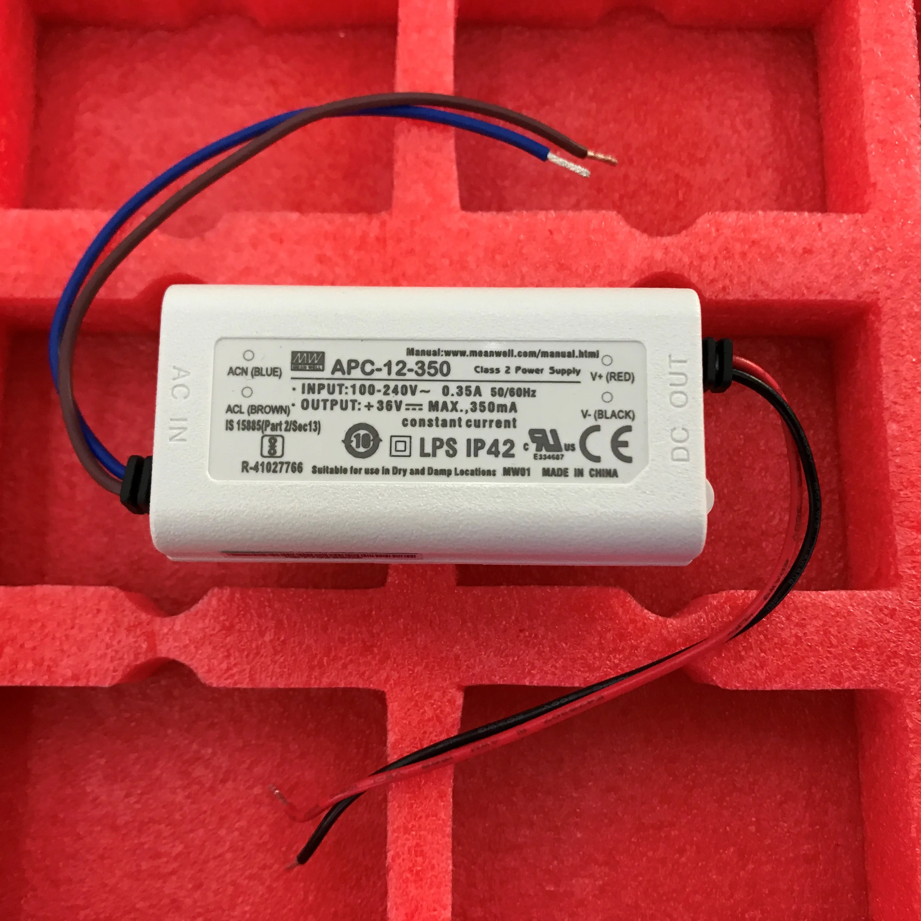

Thanks folks, so a Meanwell APC-12-350 then?
I just found this on AliExpress: £5.93 | MEAN WELL LED constant current power supply APC-12 12W 350/700mA lighting low cost driver

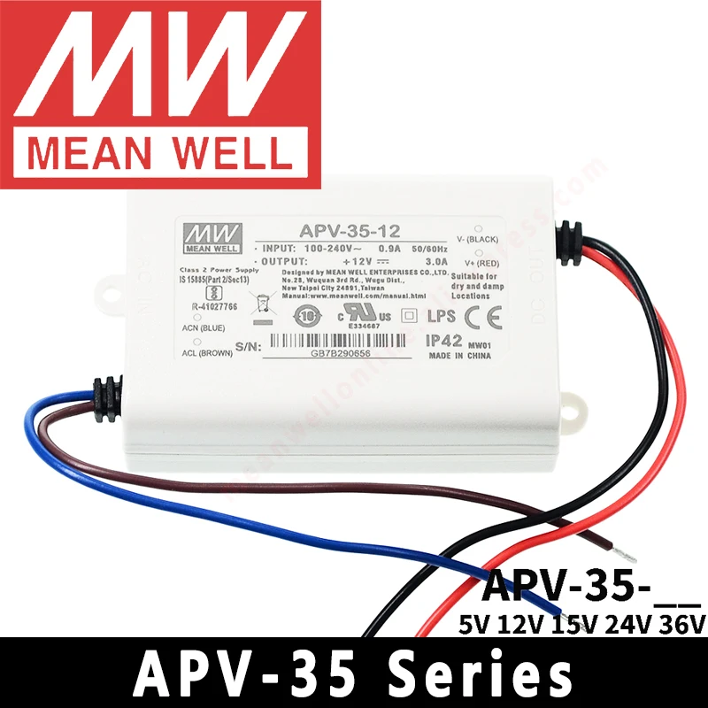

I’ve got that wrong again. That’s constant current above. The APV model is the constant voltage… so this
APV-35-36… however, this has 36V and 36W. Will it just output the Wattage required? (Ie 12…) or do I need a constant ‘both’?
I just found this on AliExpress: £38.10 | Meanwell LED Driver APV-35 Series meanwel 5v/12v/15v/24v/36v LED Transformer IP42 LED Power Supply Constant voltage Adapter

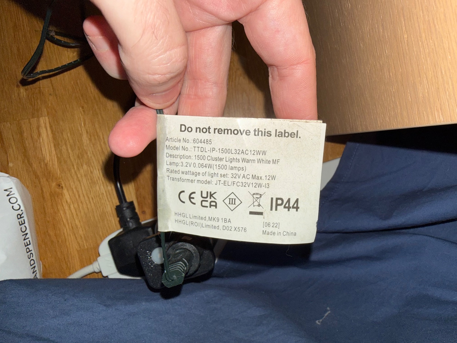

Also I wonder if you actually need a higher wattage one like 15w, if the 12w one is running at its maximum it will fail sooner. Does the light set have a label on it with specs? The lights being on static won't be any worse than any of the flashing modes, actually I would have thought the flashing modes would put more wear on the components.
This is from the lights…
Based on your comments above, it does seem weird that they’re ploughing through PSU…
