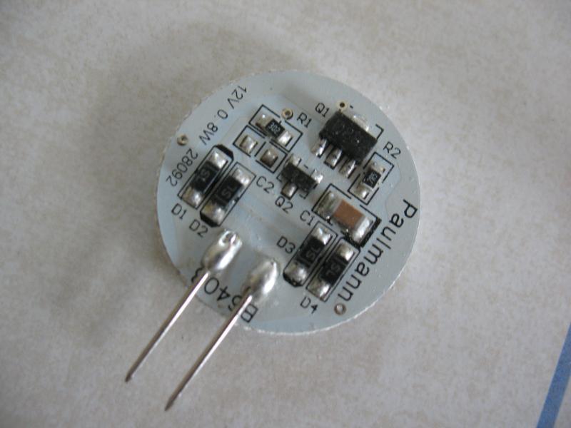

Indeed - that is precisely what one would expect. Up-market LED lamps may have a constant-current controller (rather than just a resistor) within them, but if they are described as "12V" (or 24V, or whatever - or maybe even something like 12V-50V, if they containing a constant-current controller) it's difficult see see what that can actually mean other than that they will work off a simple (essentially constant voltage) 12V (or whatever) supply.

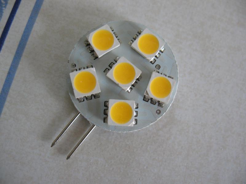

I suppose this may be of interest, can't remember if I posted them before. It's an LED replacement for a small 12V halogen lamp (G4). You can see the bridge rectifier, and some other stuff. I haven't bothered to work out the circuit so far, as the lamp is experimentally in use.
