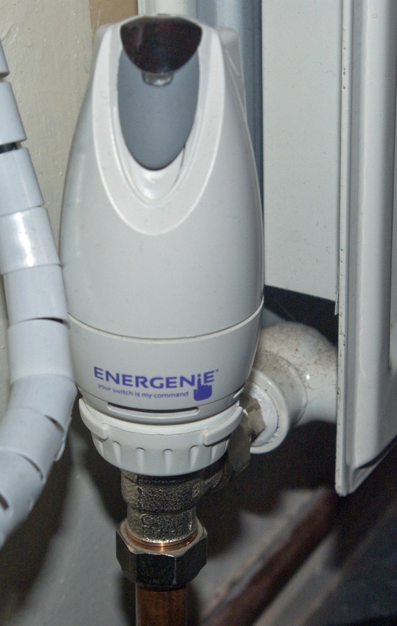

    To my mind Energenie works the wrong way around, the wall thermostat tells the TRV heads what to do, every other the TRV heads tell the wall thermostat what to do.

    But the big question is speed, if you work 50 miles from home, and it takes one hour to get home, the heating has just one hour to heat the home, or at least the first rooms you will use, so the radiators in those first rooms to be used need to be big enough, and the TRV heads need to act fast enough and that is where my Energenie TRV heads failed, the anti hysteresis software was OTT, so had to cheat and set to 22 for one hour then 20 for it to heat the room to 20 in an hour, clearly geofencing can't do that cheat, so the Drayton TRV head is claimed to have algorithms built in that work out time to heat the room, so can heat the room faster without over shoot.
    But the big question is, is it worth the installation cost? I got my 5 bluetooth eQ-3 TRV heads for £15 each, although since brexit the price seems to have gone up, but although no wifi they work in some ways better than the Energenie heads, which have got wifi and can be set with IFTTT to geofence.

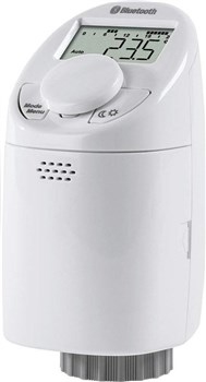

    Did I say Honeywell sorry Drayton has the algorithms, as to accuracy mothers house not this one, i.e. modulating boiler not on/off boiler adjusting the lock shield valves and they were spot on, simple TRV_report.jpg current goes over target close the lock shield a tad, and once set they were spot on. But you have to use a PC, IMGP8035.jpg there is a comfort/eco setting but fixed, these EQ-3 Bluetooth Smart Radiator Thermostat.jpg far cheaper and you can set your own comfort and eco setting and do it all at the valve, no need for phone or PC. And at home I don't walk around with my mobile, so walking into a room and pressing one button works well.
