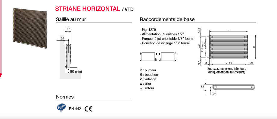

I ama big fan of the asthetics of the Acova Striane radiators and have bought six over the years, some vertical and some horizontal.
https://www.diy.com/departments/aco...radiator-white-w-399mm-h-2000mm/259023_BQ.prd
I have had a spare one hung, but not connected (a too good too miss B&Q deal) a few years and am now installing it, but I have lost the bleed valve. I have no idea what size I need and from where to source a replacement - are these a standard size.
I've looked on the Zehnder website (these have been redamed Zehnder Orbis) and cannot find what size fitting I require
Any ideas most welcome
Regards
Tet
1/8" perhaps?
/www.maison-energy.com/pdf/uploads/technique/acova-radiateur-chauffag-central.pdf
