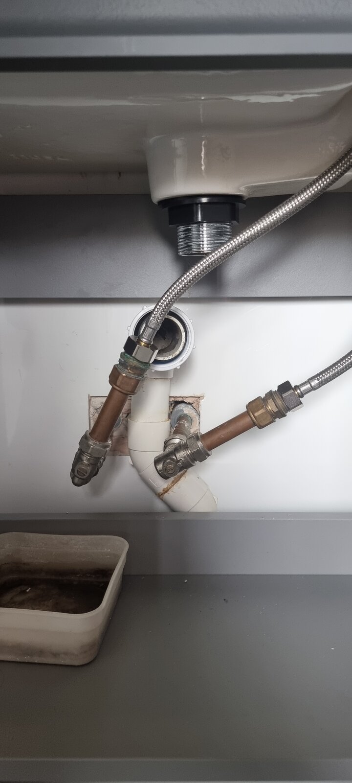

Replacement sink... bottle trap offset from waste pipe.. options to fix?
28 Jun 2021
5
Hi all, a friend is trying to replace her bathroom sink... and the new sink bottle trap will be offset from the waste..
What are thr simplest options for a diy? Enjoying doing this DIY so I know a pro would fix this in seconds.

Use a swept elbow if you have the space and use an adjustable trap so you have the extra length/reach once the old elbow is removed.
