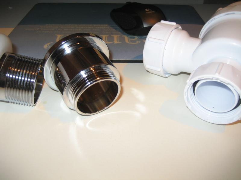

Just a quick easy to answer question. I'm connecting a 32mm basin bottle trap to a sink click clack waste but when I hand tighten it to the max (the max the thread on the waste allows) the bottle trap is still wobbly and not pulled tight against the metal sink waste.
Is it suppose to be tight? Or do I just throw a couple of rubber washers on to get it tight?
I've bought two bottle traps so far from different DIY places and both are the same. I'm about to turn the water on but could do without it leaking really.
Told you it was an easy question....I'm sure it should be tight!?!

It's like the thread is not long enough on the sink waste, another 1 or 2 full turns would do it.
Just took the waste off. The plastic thread bottoms out against the chrome bolt the attaches the waste to the sink from underneath.
Picture....not sure thiswill work!
typical bathstore ****e..!
ethier put some more washers on, or what i would do is cut a slither of the top of the plastic nut, to make it thinner.
ive had to do this before.
Cheers for the reply. Will try chopping the top off the bottle trap thread, getting quite handy at hacking into things after mutilating the b&q fitted units to get them in.
