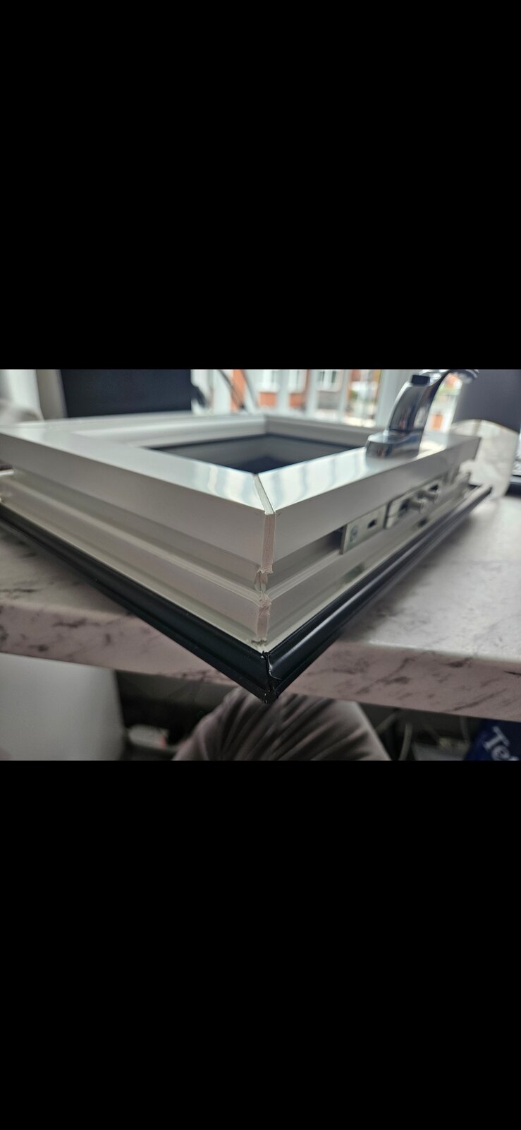

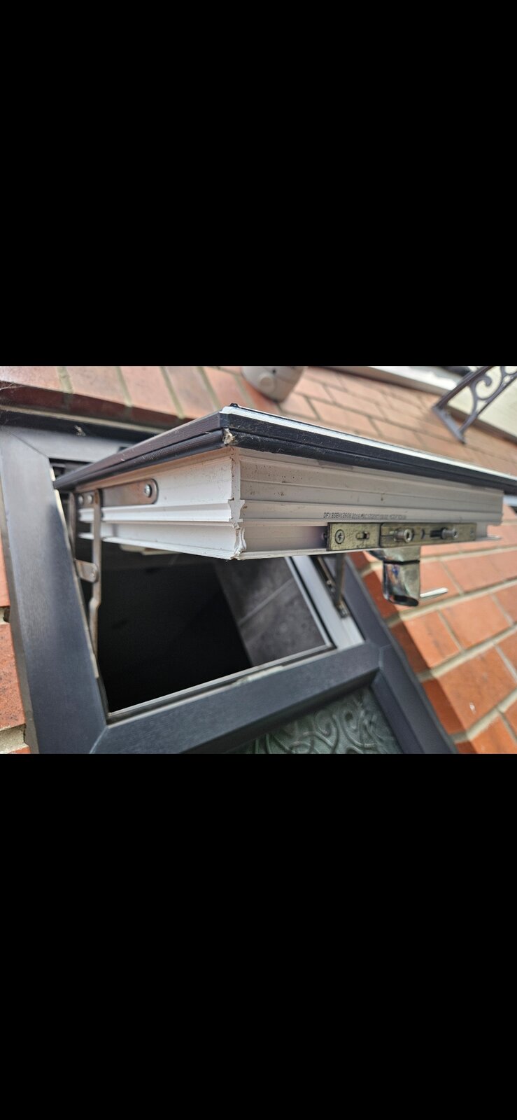

Hi all,
I'm wanting to change the window opener as pictured. I got company to provide a replacement opener.
As you can see the design/indents are not identical. E.g. the lock mechanism is in a different place and there isn't a nice slot for the hinges to be screwed on in the same place.
Is it possible to fit this opener in properly or not? If so how?
Thanks in advance.

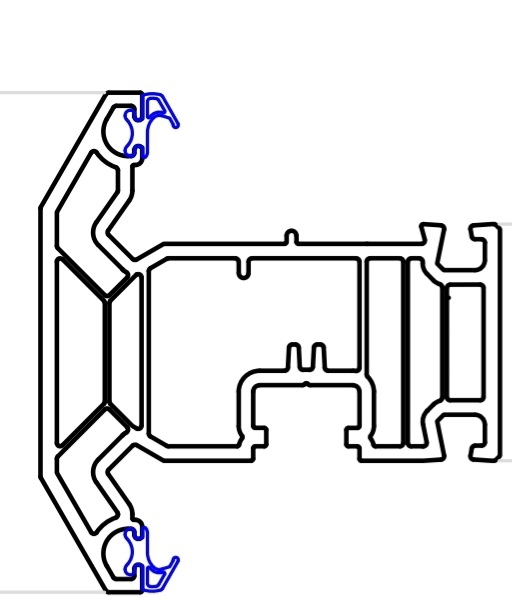

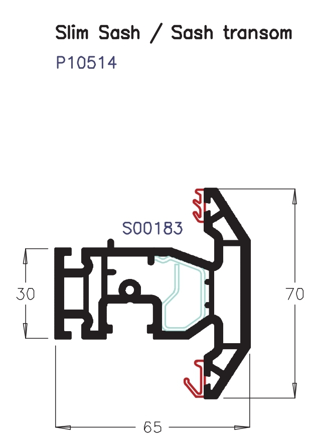

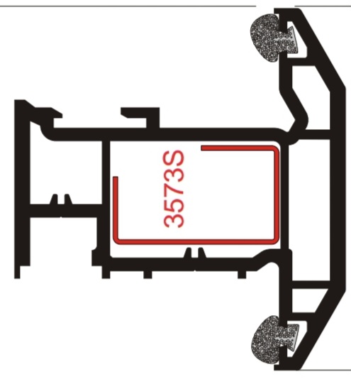

Its not possible, the 2 openers are from different makes of window, the first picture showing the opener in situ is Duraflex profile, the replacement opener I can't tell. The hung opener shows the lock to fitted in the 'euro groove' which is on the very edge of the profile, thats just how duraflex design it, the other opener has its euro groove roughly in the middle, every manufactuer or extruder uses a standardised 16mm wide euro groove but they all put the euro groove in a different place like these

Well it looks like they're using a different product or profile to before, did you remove the old opener and take it to them to copy because at that point they would have known it was a different profile, whilst width and height was copied the euro groove is is a different place it throws out the positioning of the locking mechanism which in turn means the locking keeps on the frame need moving backwards which isn't simple because the shape of the keep is moulded to suit the ribs in the profile and hinge placement is different too
