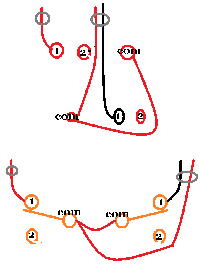

Bridge....in the wrong place.What isthe brown wire in the middle?
In that case what is the red wire round the edge of the switch?Bridge....in the wrong place.
OK, I wired the 2 reds to L1's a single wire connecting both comm ports, ad put extra wire to black connected to both L2s.
The black is not negative. There is no negative with AC. Nor is it neutral. A wire colour cannot tell how it is connected. Most likely a switched live.So if the two reds are connected to both L1's,where does the negative black wire go ?.There is a picture on page.
A rather sweeping (There is no negative with AC
