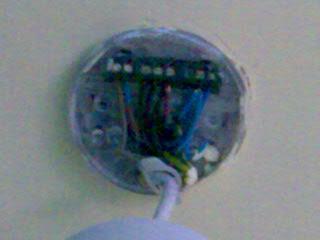

The current set up is a standard ceiling rose which carries on round the upstairs lighting circuit.

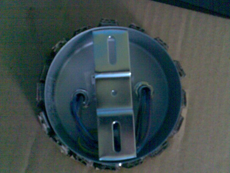

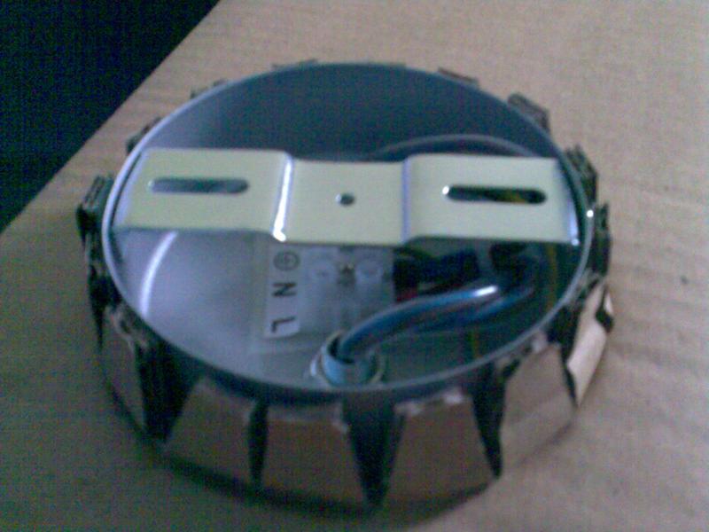

Thanks for the replies, the dimensions of the base are 95mm diameter x 28mm deep. This currently contains some wiring for the spotlight and a 3 terminal connector block.
If absolutely necessary I can make a hole in the ceiling above the light to house cabling/connectors. Regarding accessibility - yes - it is the loft so I can get at the space above.
Can you post a photo of the base? I'm thinking it will be possible to put an additional piece of block in there and use the base to house the connections. Don't make a hole and poke the connections through - they need to be enclosed in a chock box or similar (or in the lamp base).

Still in it's box, mounting bracket not removed:-
The existing rose (bit blurred, well, it is a bank holiday weekend :wink: )
Aye, there's plenty of room in there to put another piece of terminal block to make up the 4 required pieces (as the pics show in the wiki).
Remember to make a note of which wires are which, and don't let that piece of brown sleeve fall off that blue wire either (switch live)!!
Cheers mate, when you refer to terminal block is that the stuff which there are already 3 "units" of within the new light?
It's like a bit of brass with a screw connnection at each end covered in clear plastic!
Would I be OK connecting the loop to this as explained in the wiki, then the rest of the neutrals to the other terminal block? I could then get a choc box for the terminal with the loop connections, and hopefully that should be the job done to the right standard!
Thanks for your help
Yes, providing the terminal block provided in the lamp is large enough you can fit the neutrals, earths and switch live connection to there, use the additional piece to connect all of the permanent lives together.
The whole point of putting the extra terminal block inside the lamp base is to remove the need for a choc-box. Which wouldn't fit inside the base anyway...
