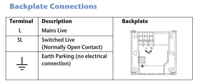

So do I have a live, neutral and earth or is the blue actually a switched live? I have looked at the wiring for the Salus RT500 (non wireless one) and it needs a live and a switched live so if that is what I have there then is looks to be a straight swap.

In your original post you referred to installing a Salus RT500RF. The manual I have for that quite clearly shows that it needs a neutral.
However, it would appear that you have now changed to an RT500 which will indeed work with the wiring you have and does not need said neutral.
Ah, Sorry After D_Hailsham mentioned a wired one should work I did say I was now looking at the RT500. I don't really need a wireless stat.
