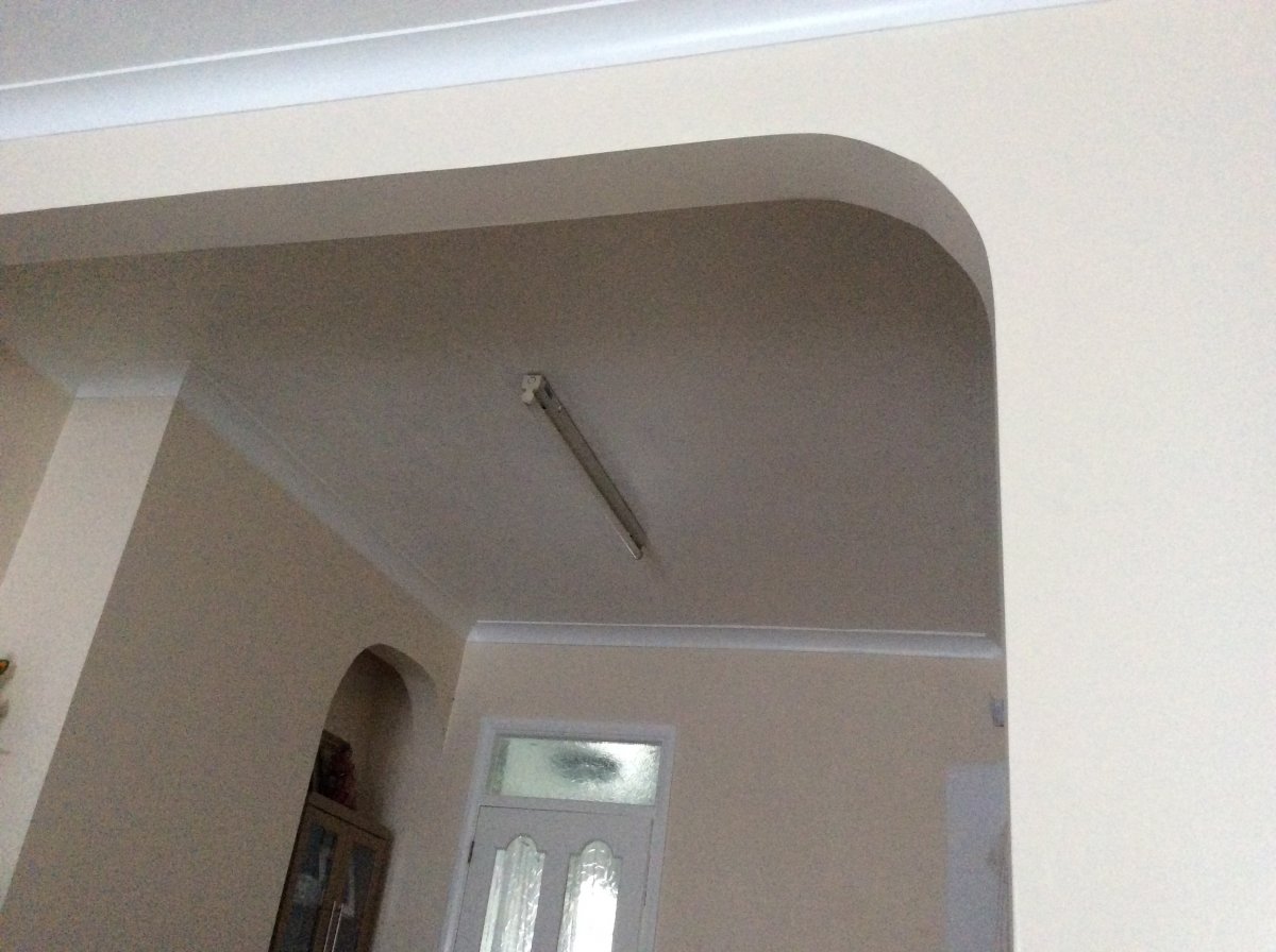

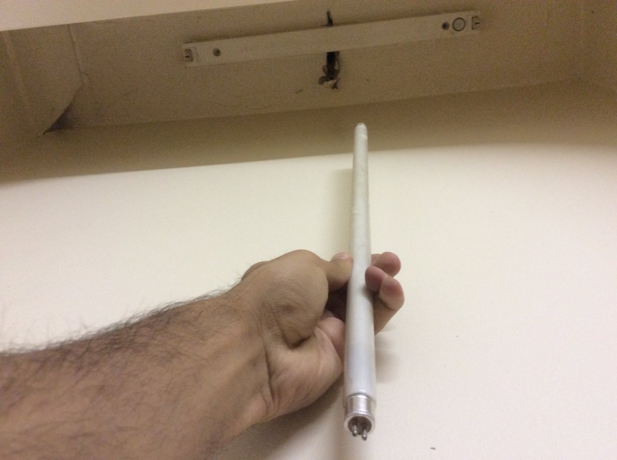

hi there I have noticed an old tube light around 21 inches very thin very short in length to your normal one
This is in the back of the arch you can see in the pic below where display cabinet is
I turned light switch on at behind unit and tube light faintly lit up so guessing it's all working but tube light needs replacing
But what are these type of tube lights called and are they efficient ?
It's a living room / dining room so maybe better I change the whole thing to something more efficient and more dim to create a better mood in the room??
In which case any advice welcome please with regard to which type of light to replace with and if I can use existing wiring from the light switch thank you

sounds like a 13watt T5 tube, it will be printed on it as well as the colour,possibly either 30,35,40,830,835,840 depending how bright you want it, theres also a starter possibly in the fitting, if so thats an FSU starter
They are efficient! The tube light is probably the best type of light for your application as it provides a gentle diffused light without glare and shadows. You might want to replace the large centre light with something more decorative though.
FSU (flourescent starter universal) is the type of starter fitted which should be replaced at the same time as the tube.

It is recommended to replace both tube and starter at the same time to ensure long tube life. The only exception is if one of the electronic starters is fitted, often branded pulsestarter.
If you do decide to get a new tube, get one from the same make as the original.
I have found that the length of 13W T5 tubes can vary by a few mm, making some incompatible.

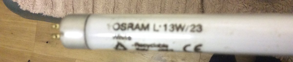

Attached is the tube light currently I'm there
I've decided to keep the fighting but just want a much dimmer tube light
Could somebody kindly please advise where I can get one from pls or the model / tube light number??
