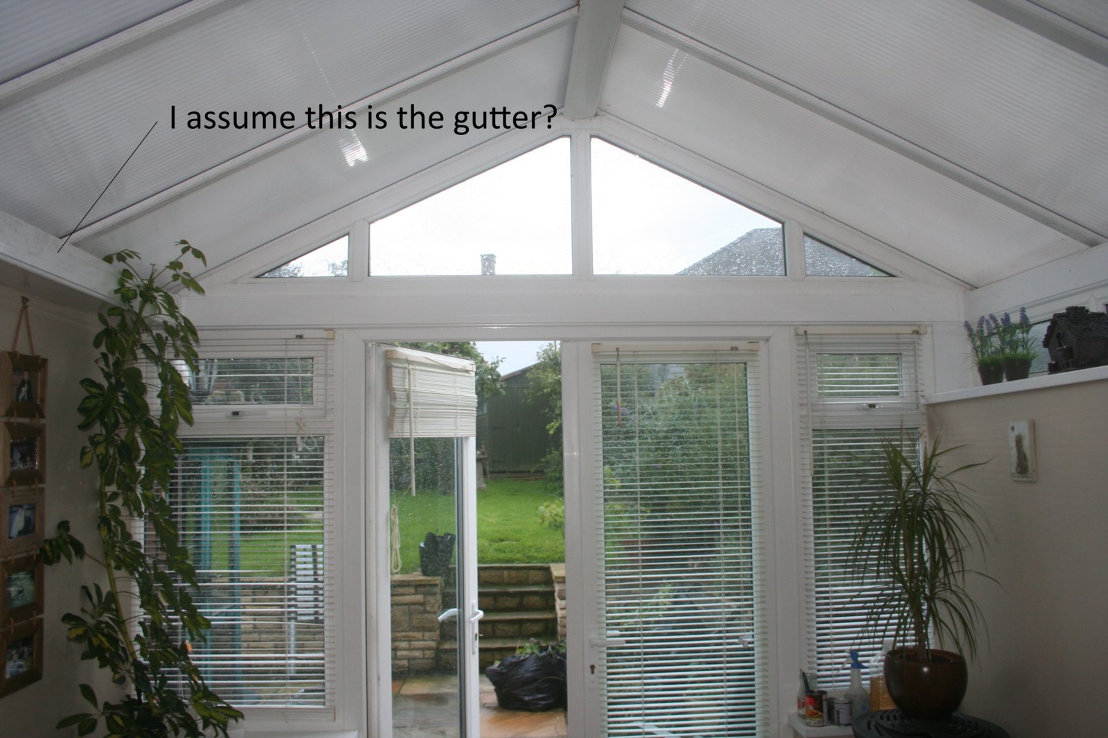

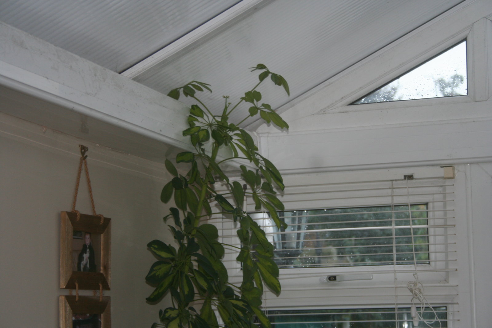

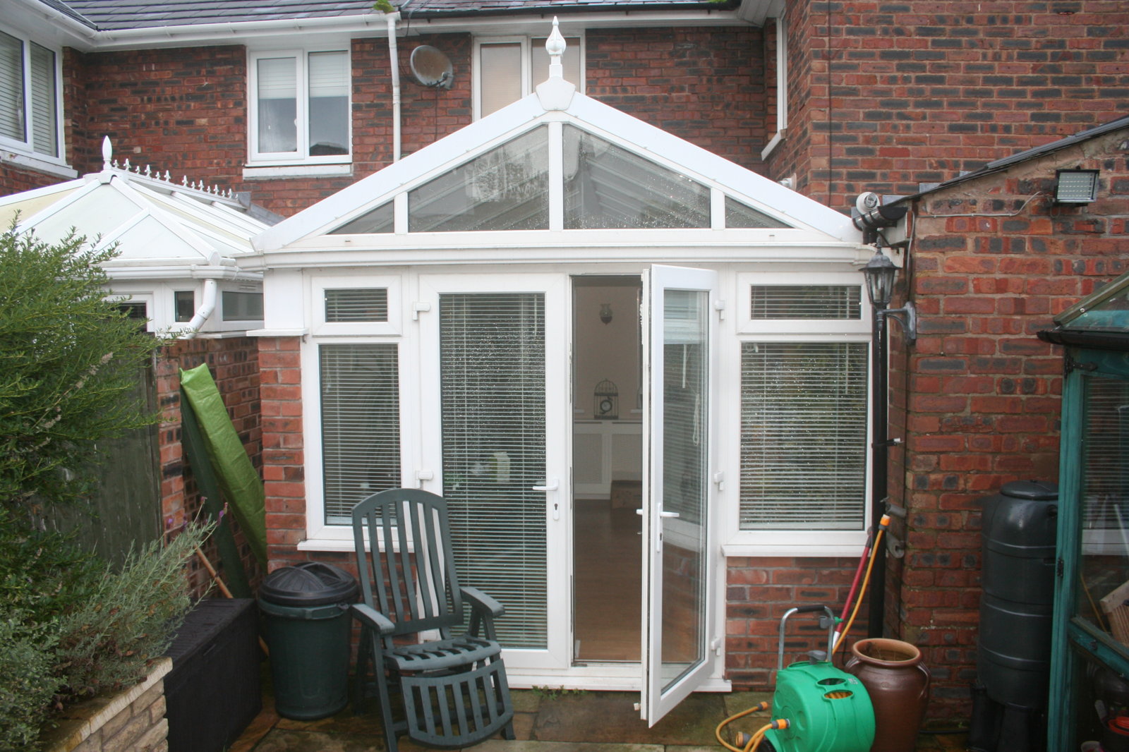

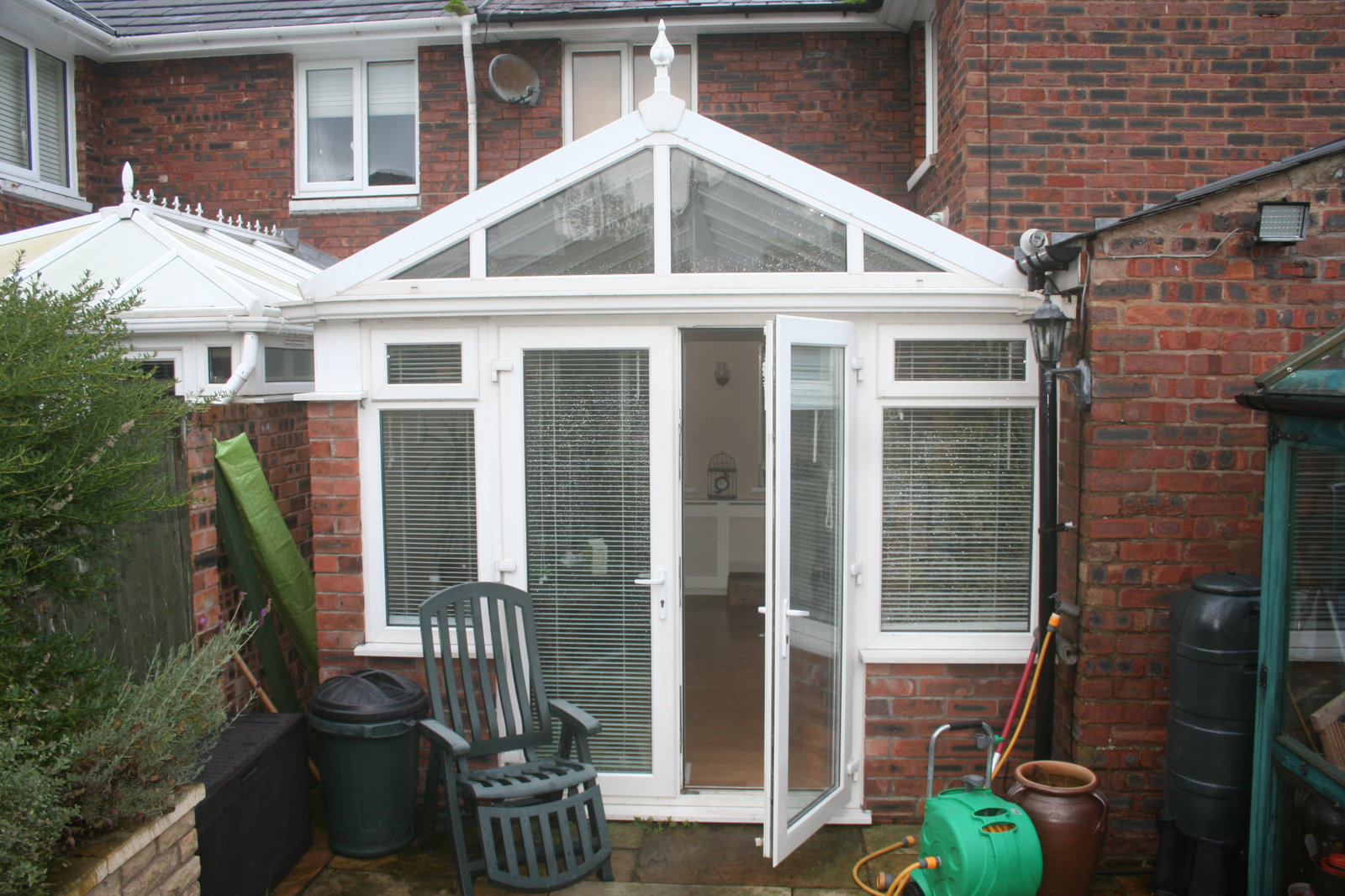

Hi I was wondering if anyone could help me with a few queries.
I want to remove the conservatory roof and small side windows that run on top of the high wall on the left back to the house (you cant see them on the photo) leaving the doors and adjacent windows in place see attached photos then build up the wall on the left a few courses up to door height and put a new quieter slate roof with hips to the front on vaulted timber rafters so I have a pitched ceiling inside. The conservatory roof sits on the wall on the right is the existing house wall how this is supported i cant tell. Could someone advise on the following
1) what size timbers would I need for the rafters and at what spacings between (building is 2870mm internal width) and pitch will be 25 degrees
2) how would I support the rafter ends on the right side that would in effect butt upto the existing house wall.

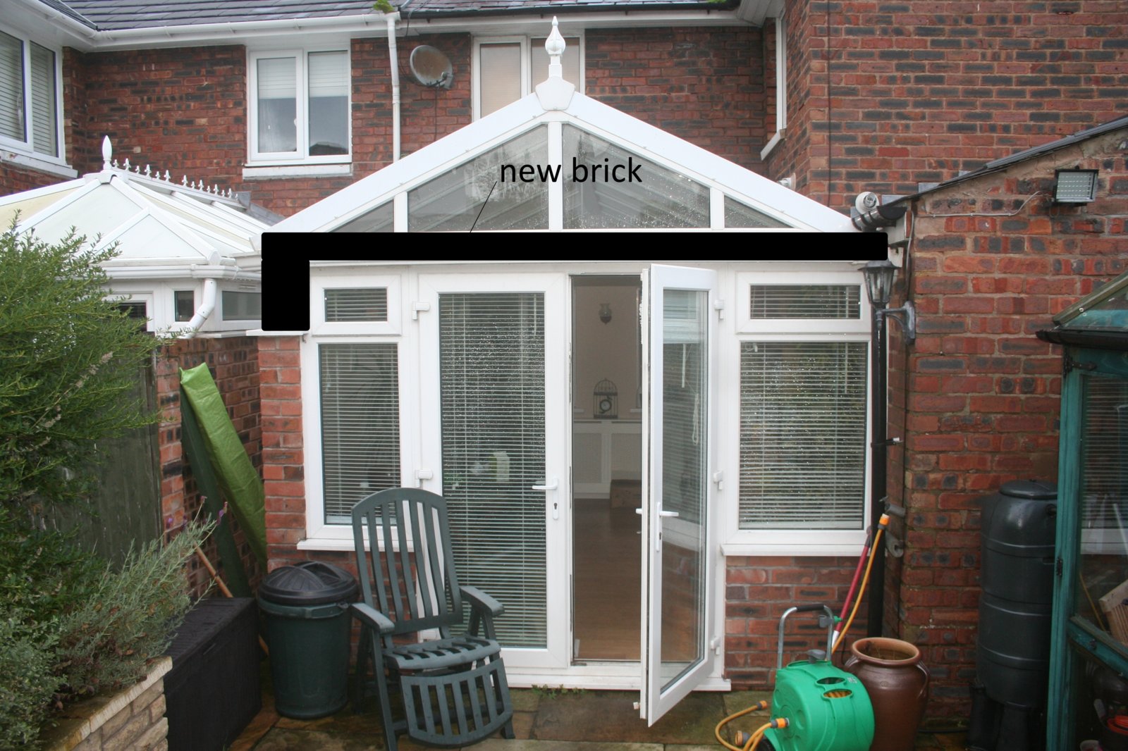

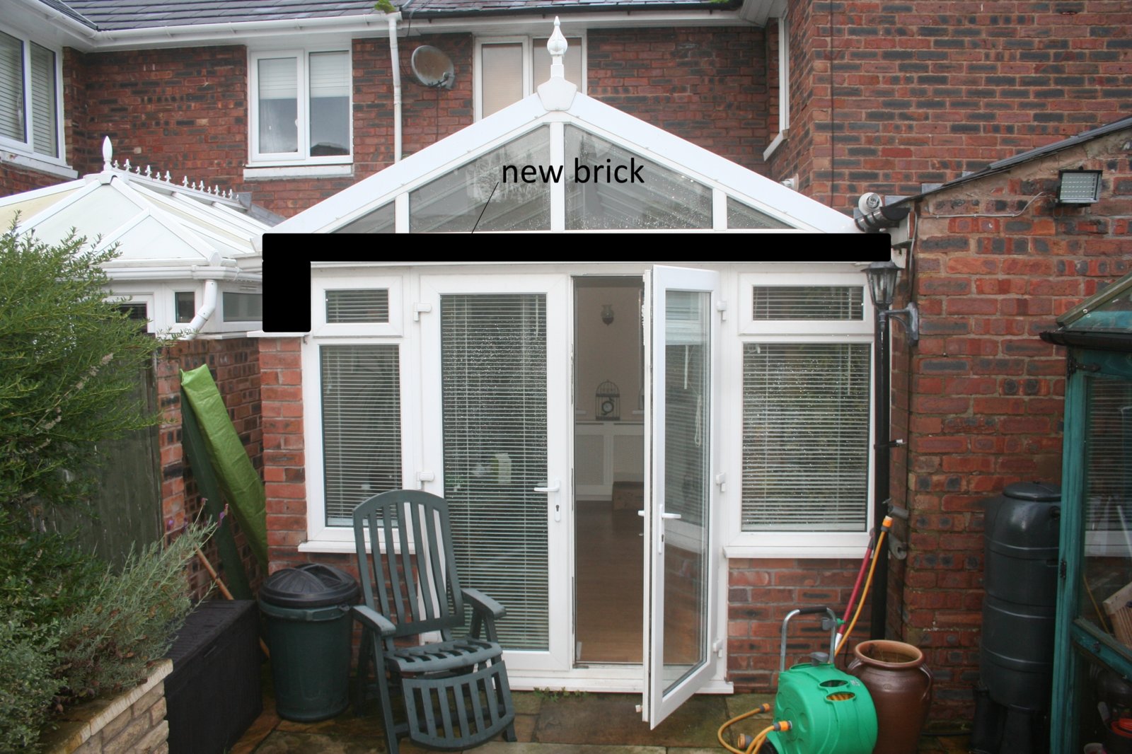

3) what would be used as a lintel over the double doors with the adjacent windows to the front elevation to support hipped roof as there will be a couple of courses of brick to go over these to doors (shown in black on marked up image) to make up the height once upvc conservatory roof and gable is removed.
4) how thick would the roof insulation need to be to meet current regs.
Thanks for any help

I am not a builder but I have a conservatory with timber rafter in, it as 2 course of 2x4 timber over the door and windows, the windows and door are screw to it also the timber rafter sit on it. Hope this helps.
If you are going to change the polycarbonate roof to tile roof you need to let building control know, they would want to know if your footing is deep enough and that the windows and door can take the new weight. This is something I wanted to do to mine but when I spoke to my building control they say it turning it into an extension and they would want footing at 1m but mine is 600mm.
I am in the process on changing the rafter as they are rotten and my builder told me to put 8x2 rafter in they have 6x2 at the moment so I hoping my footing can take it, the builder say it will as he just finish building a very large garden room with 4" hardcore and 150mm concrete slab.
How about turning it into an orangery with a flat roof and a central lantern or velux?
You would need a nice decorative fascia and gutter to make it look nice.
Turning what you have into a pitched tiled roof would be complicated as you have that box gutter to deal with.
Also you would need to create hips so the front could be tiled and then the loading of the hips and restraint at the corners becomes a bit of an issue. All doable if you are a skilled chippie that can pitch roofs but tricky for a first timer.
The orangery option solves the box gutter issue straight away, and the dimensions mean you could use standard C24 timbers for the lantern beams and trimmers.
