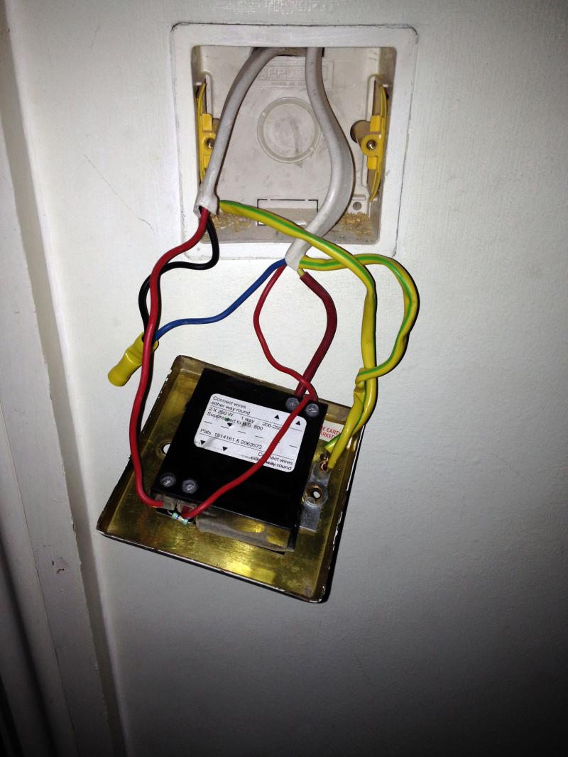

I am trying to replace a double dimmer light switch with a single switch (no dimmer). I thought it was going to be a simple job but turns out it is more complicated than I had expected so some help would be really appreciated.
The double dimmer currently controls the ceiling lights and, I think, a wall socket for an old, round, three pin plug.
The dimmer has recently broken and we don't use the wall socket so we'd like to replace the double dimmer with a single switch. I asked in a DIY merchant who sold me a new switch as shown in the photo. They told me to wire the neutral into the top and the live into L1.
I have too many wires, however, to do this. The cable which controls the ceiling lights is the one on the right in the photo. It has four wires which I think are the live (red), neutral (blue), switched live (yellow) and earth (bare wire, now covered in yellow/green). Is this identification correct?
If so then I know which are the live and neutral that I was told to wire in but where do the switched live and earth go in the new switch?
For the cable I am leaving behind, can I just separate the wires with electrical tape and leave it in the wall or do I need to do something else to make it safe?
