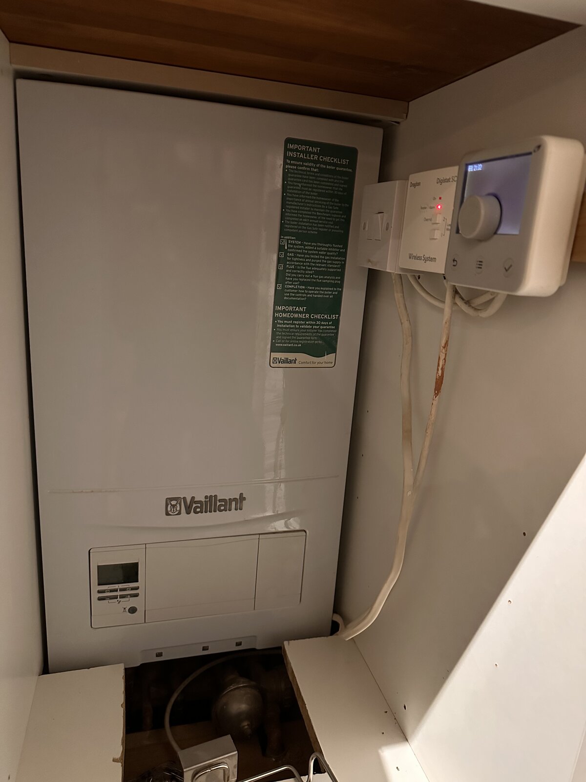

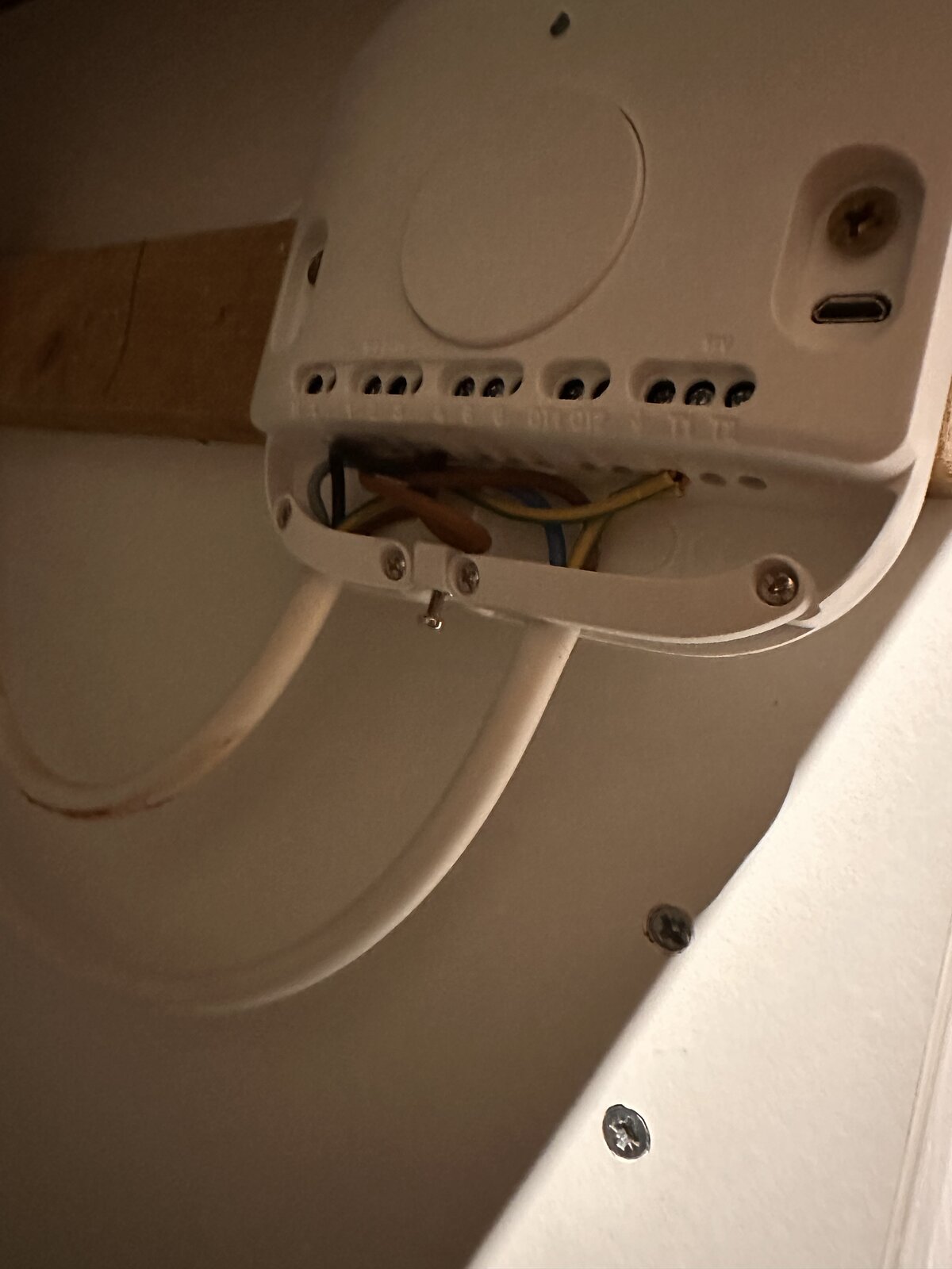

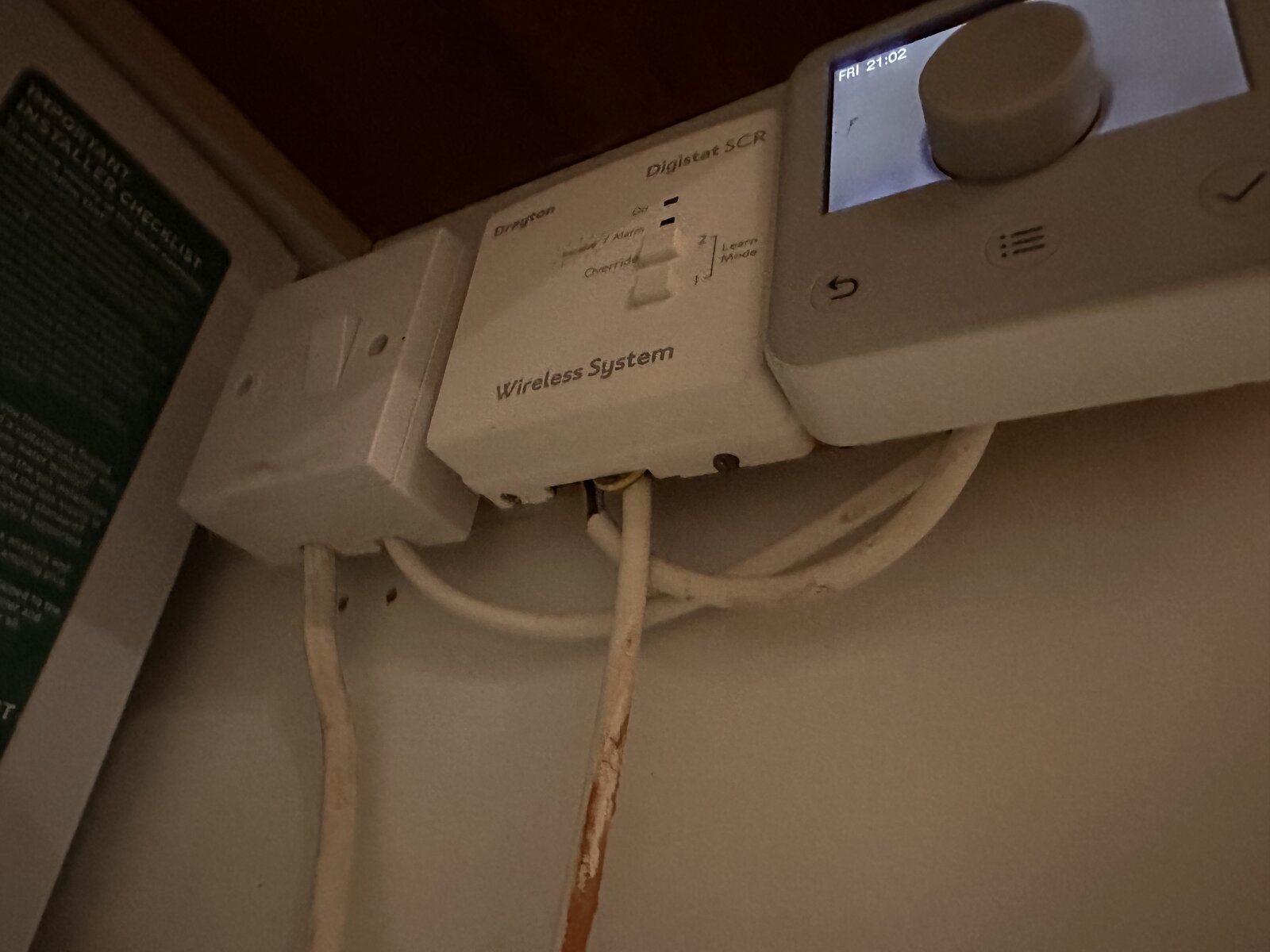

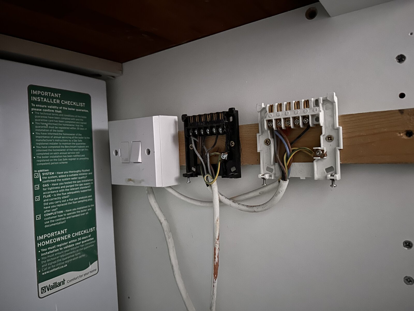

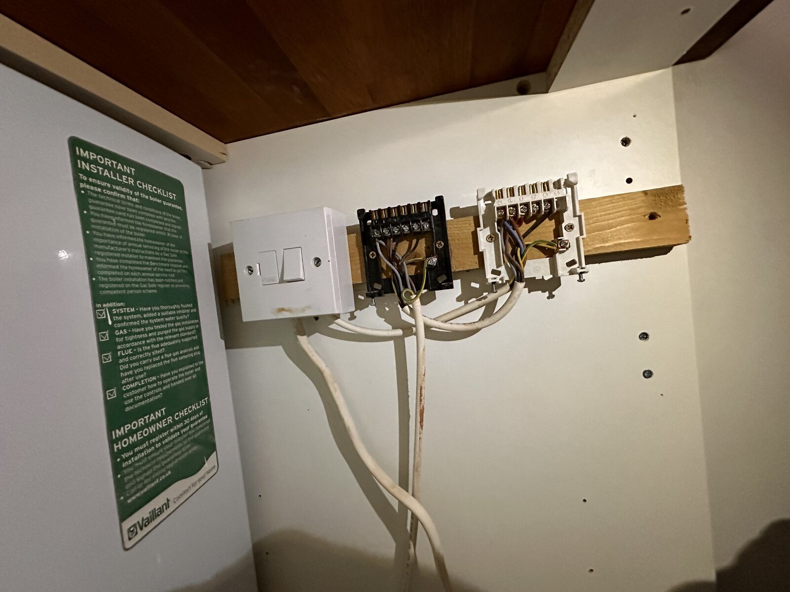

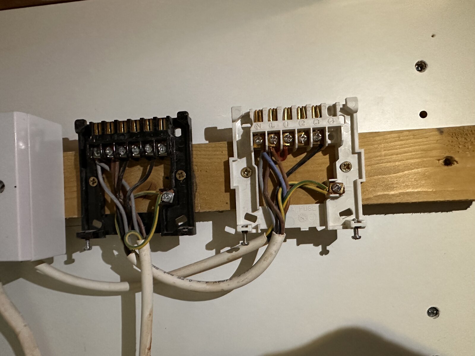

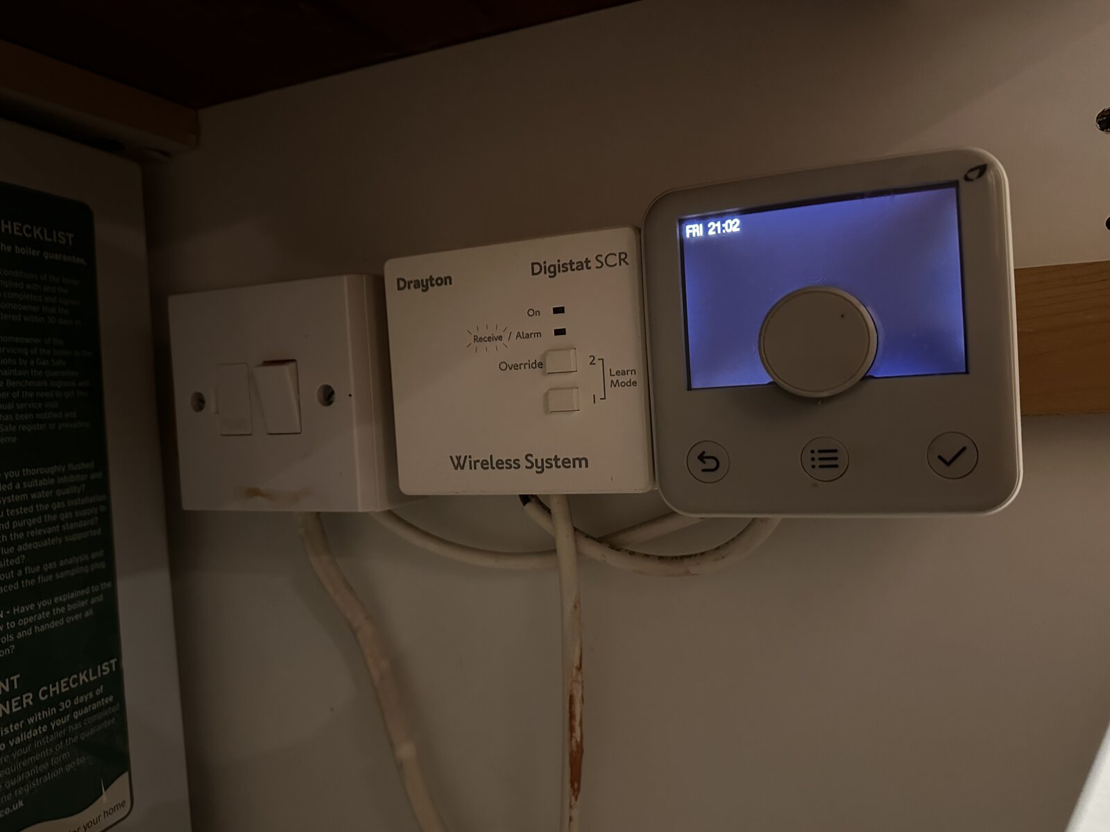

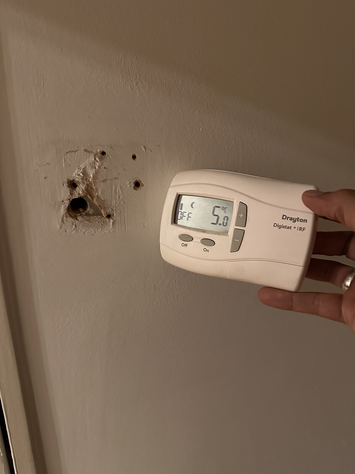

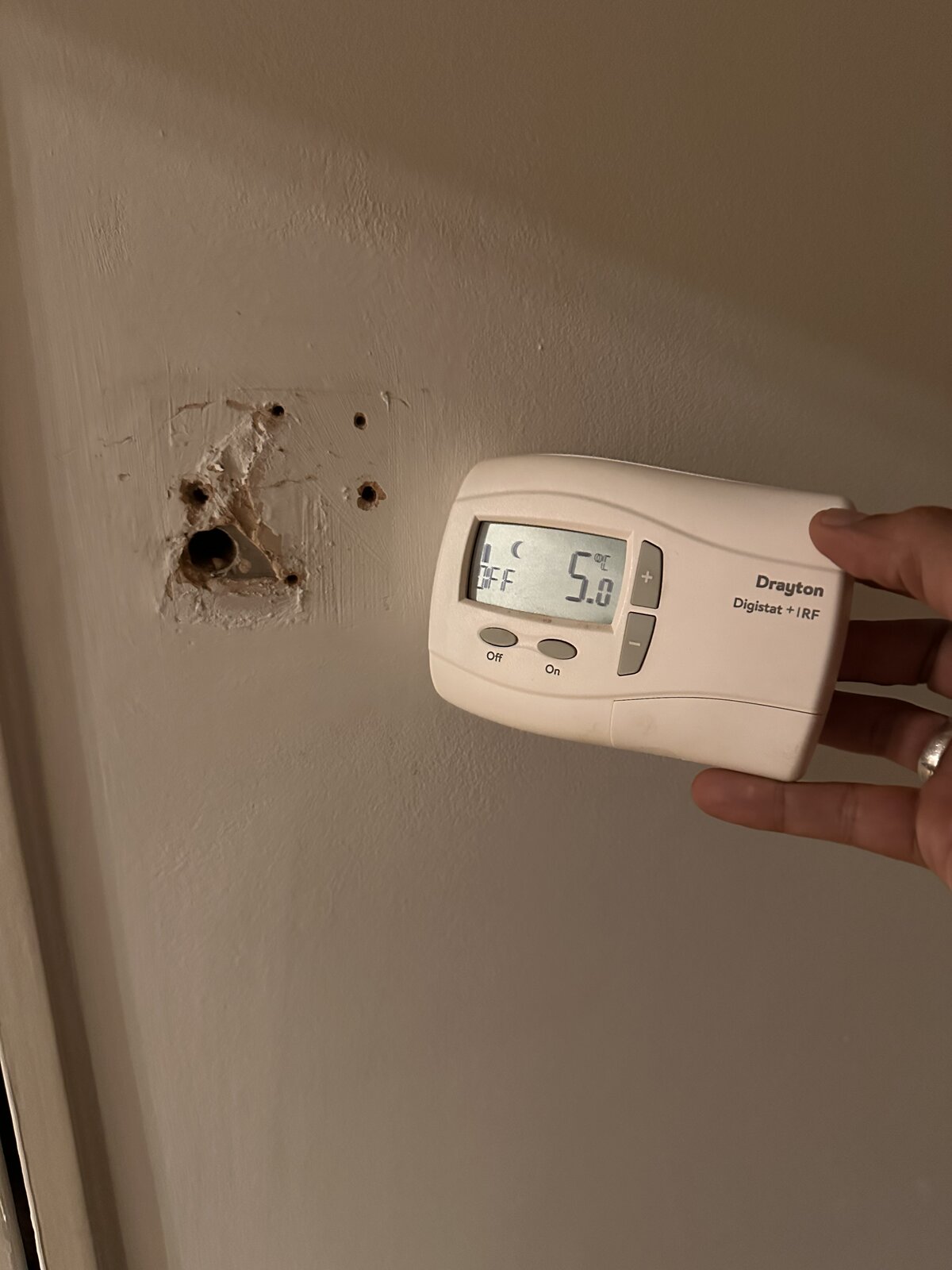

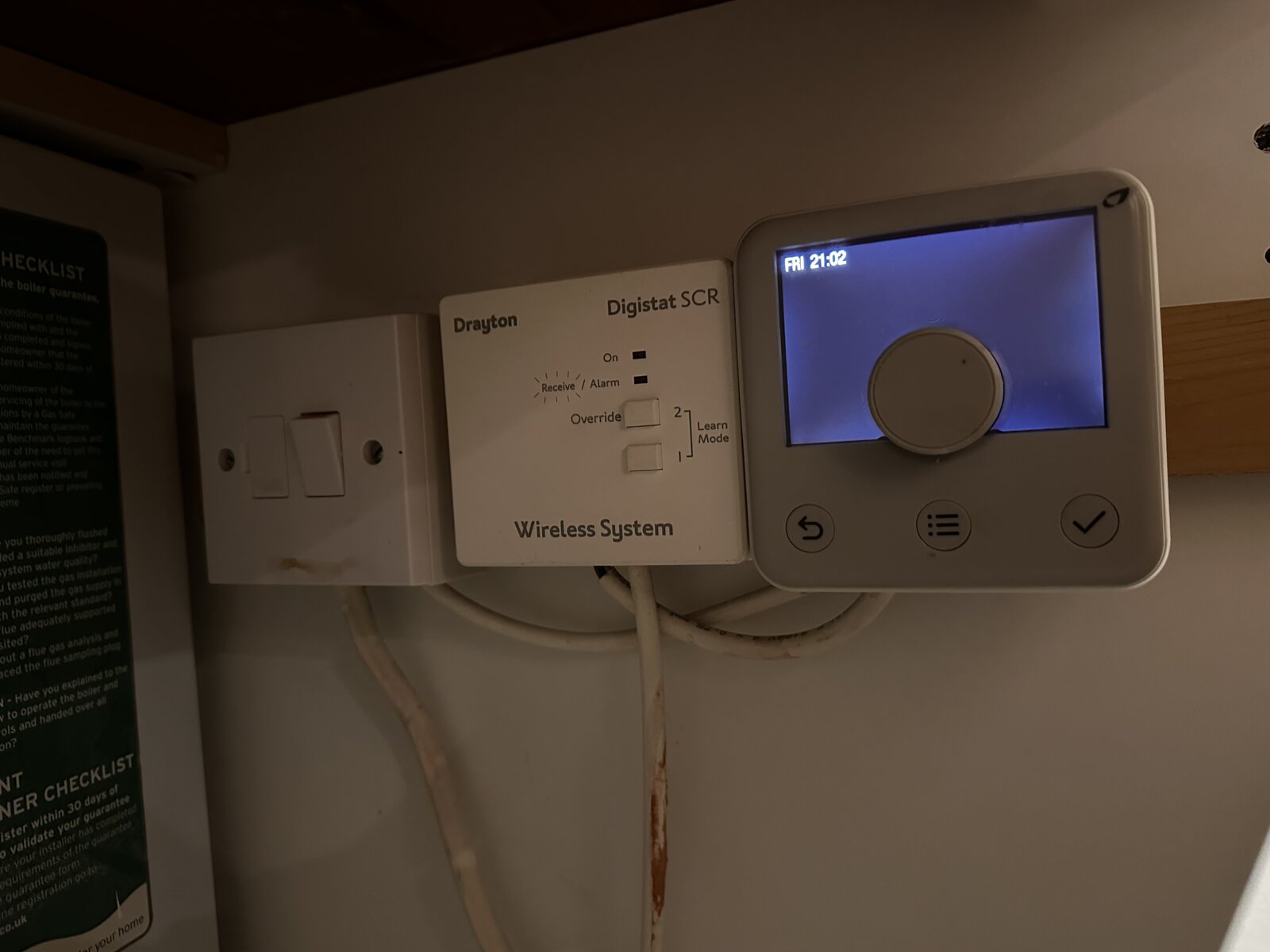

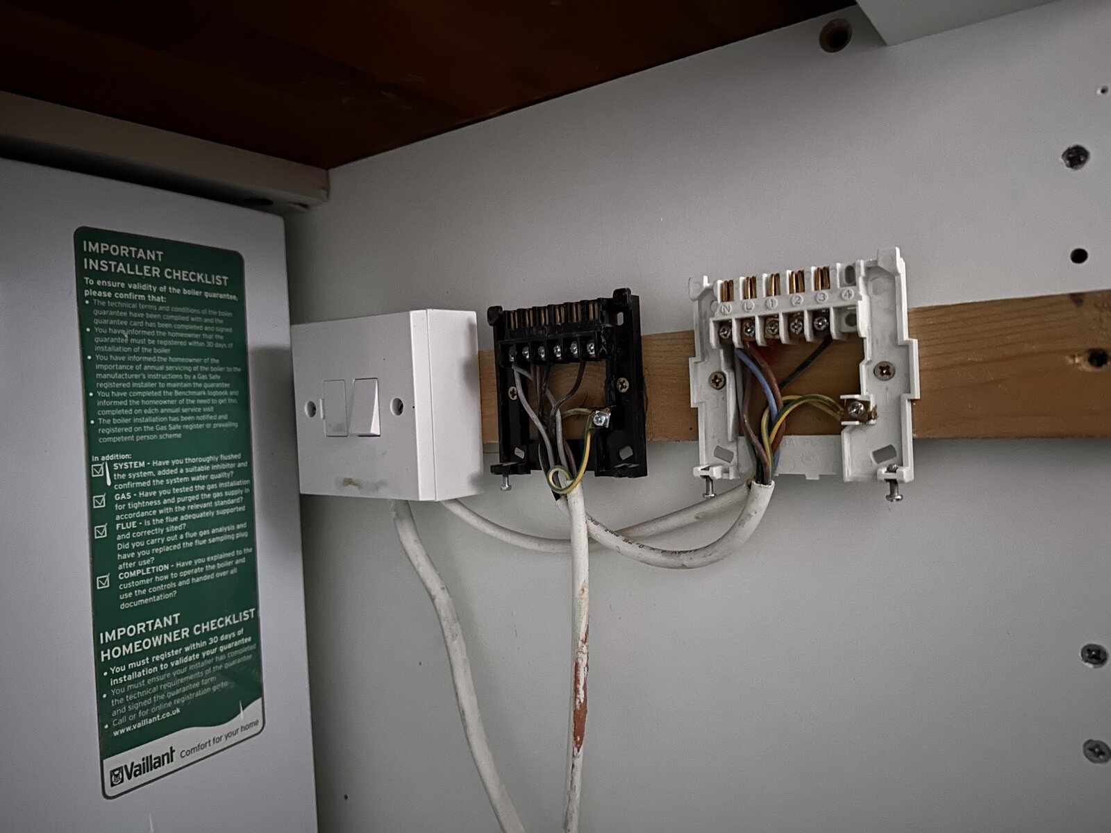

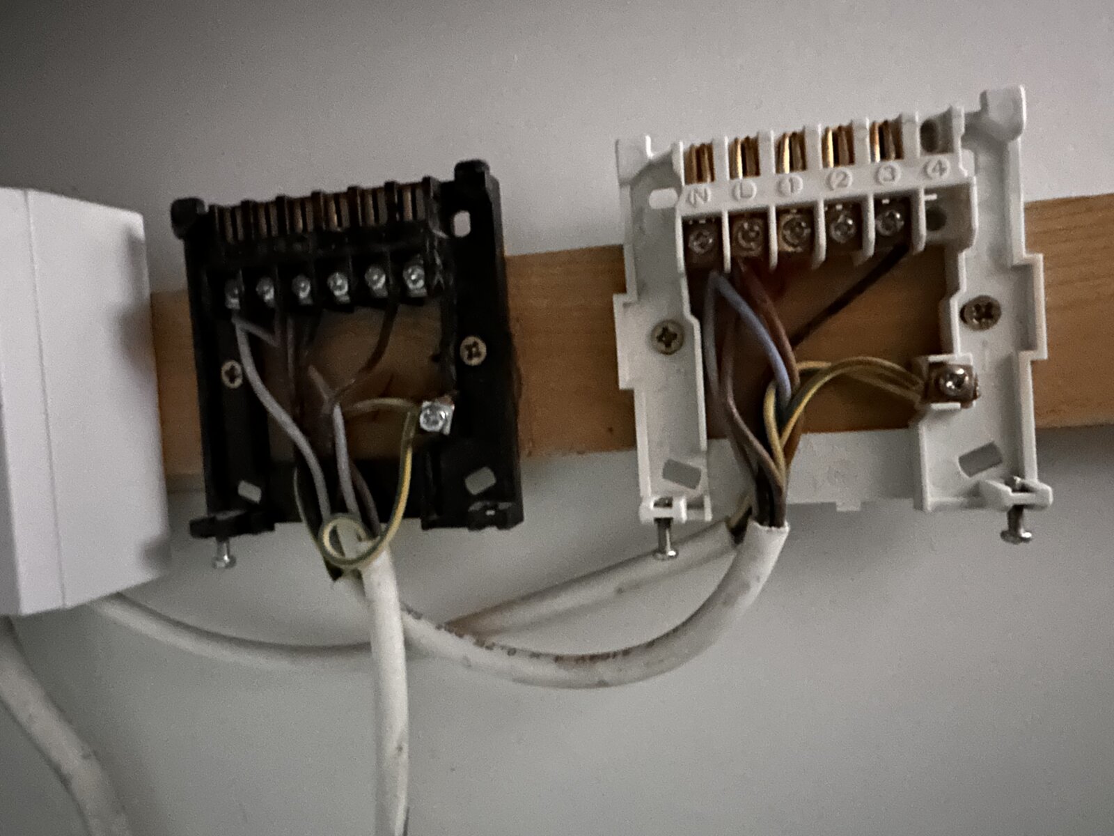

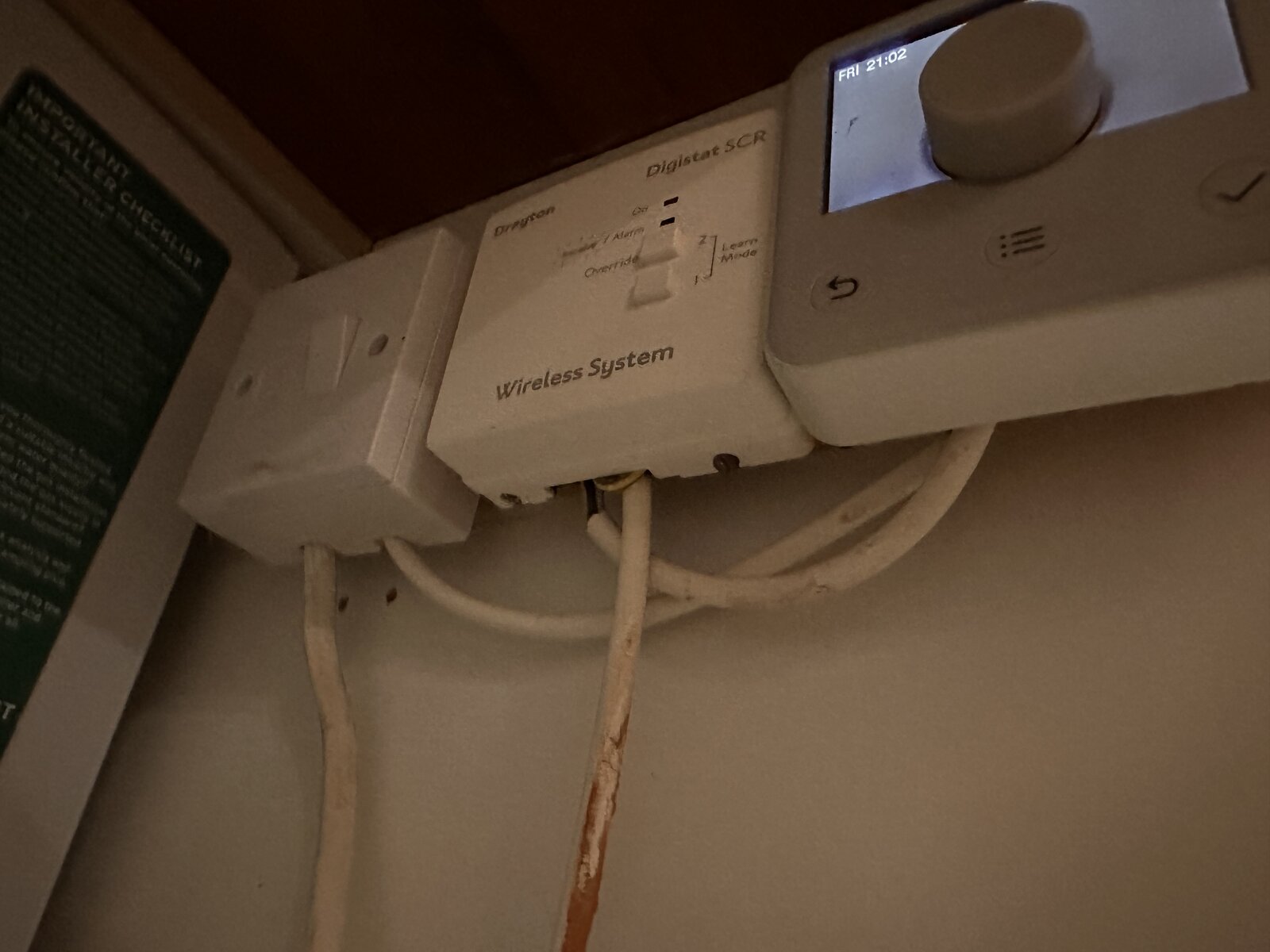

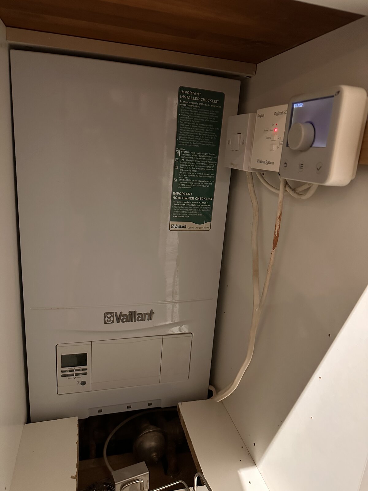

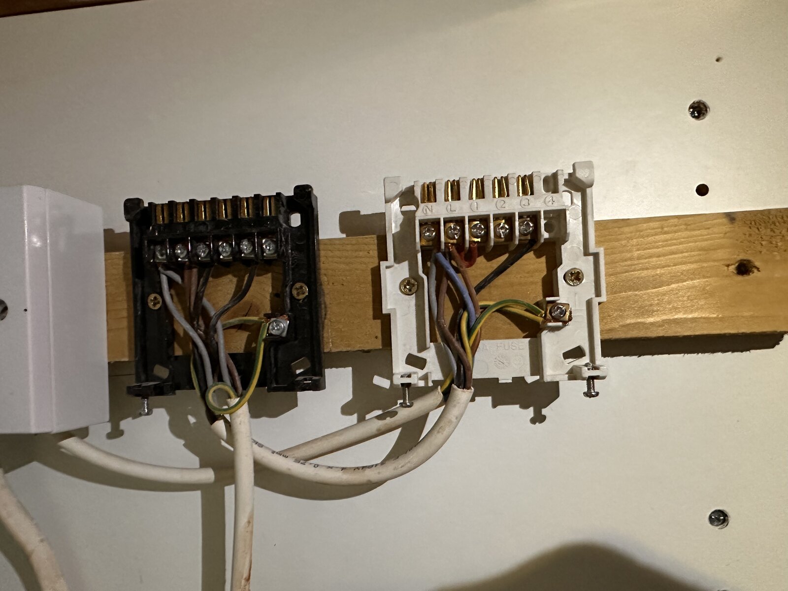

I have a Drayton Digistat wireless(thermostat, I think) and British Gas timer and I want to replace it with Google Nest.
The receiver was sitting on the wall and I removed it. It is wireless but I saw a hole in the wall behind it (new house) which is ideal so I can feed USB power to Nest Thermostat.
Now to install the heat link, would I need to access the boiler at all seeing as all the cabling has been done already? Have a look at the low angle pictures of the receiver and timer to show where and how the cables are patched. Hopefully this gives you an idea.
The boiler is a Vaillant Boiler.
Any suggestions or step but step would be incredibly appreciated.
I tried searching the web but couldn't find anything about how to replace nest with these two.
I am not a qualified electrician but very handy with things and a safe pair of hands.
Thank you

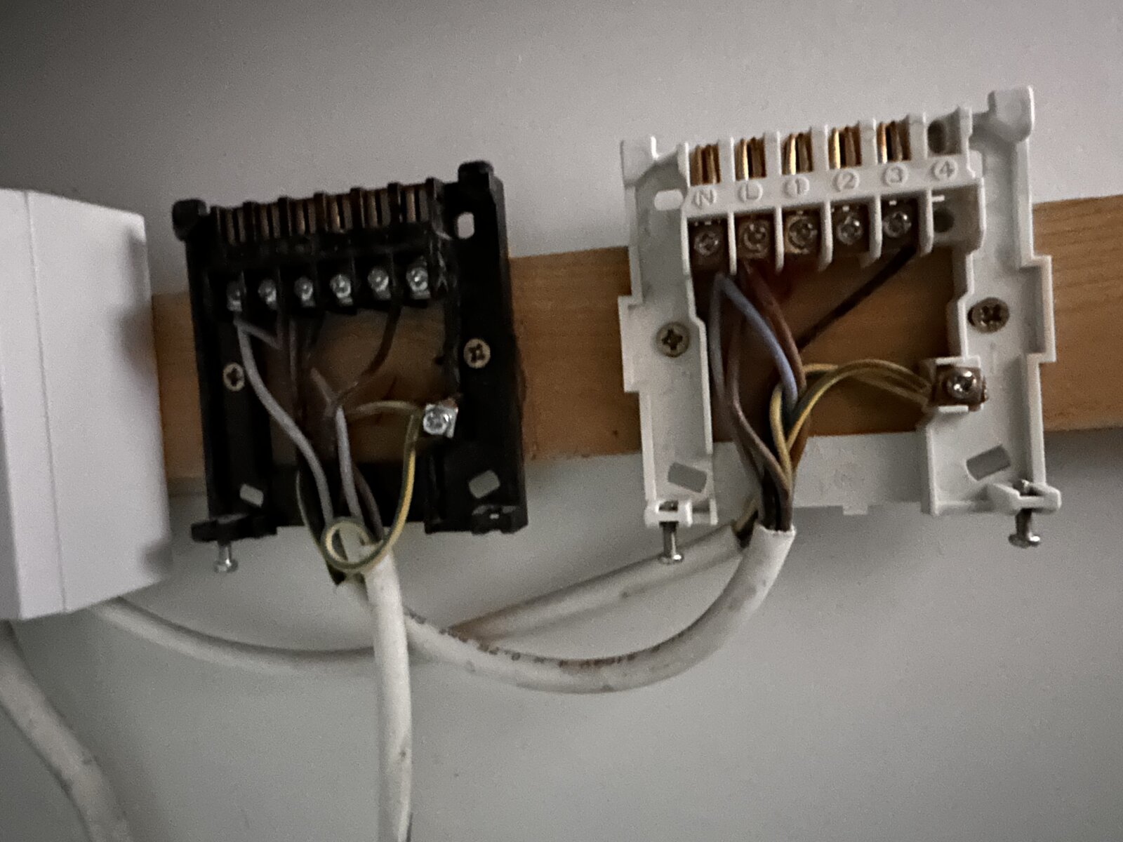

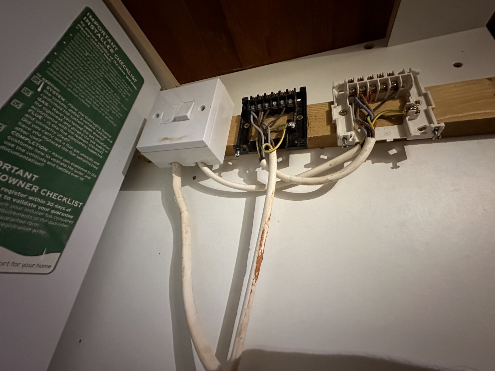

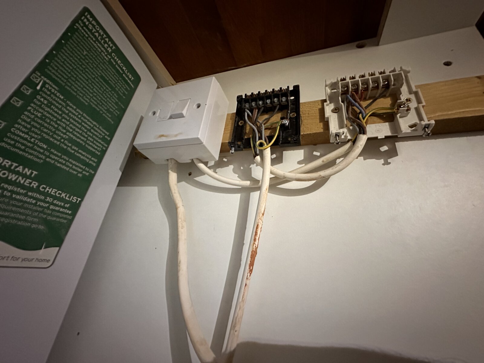

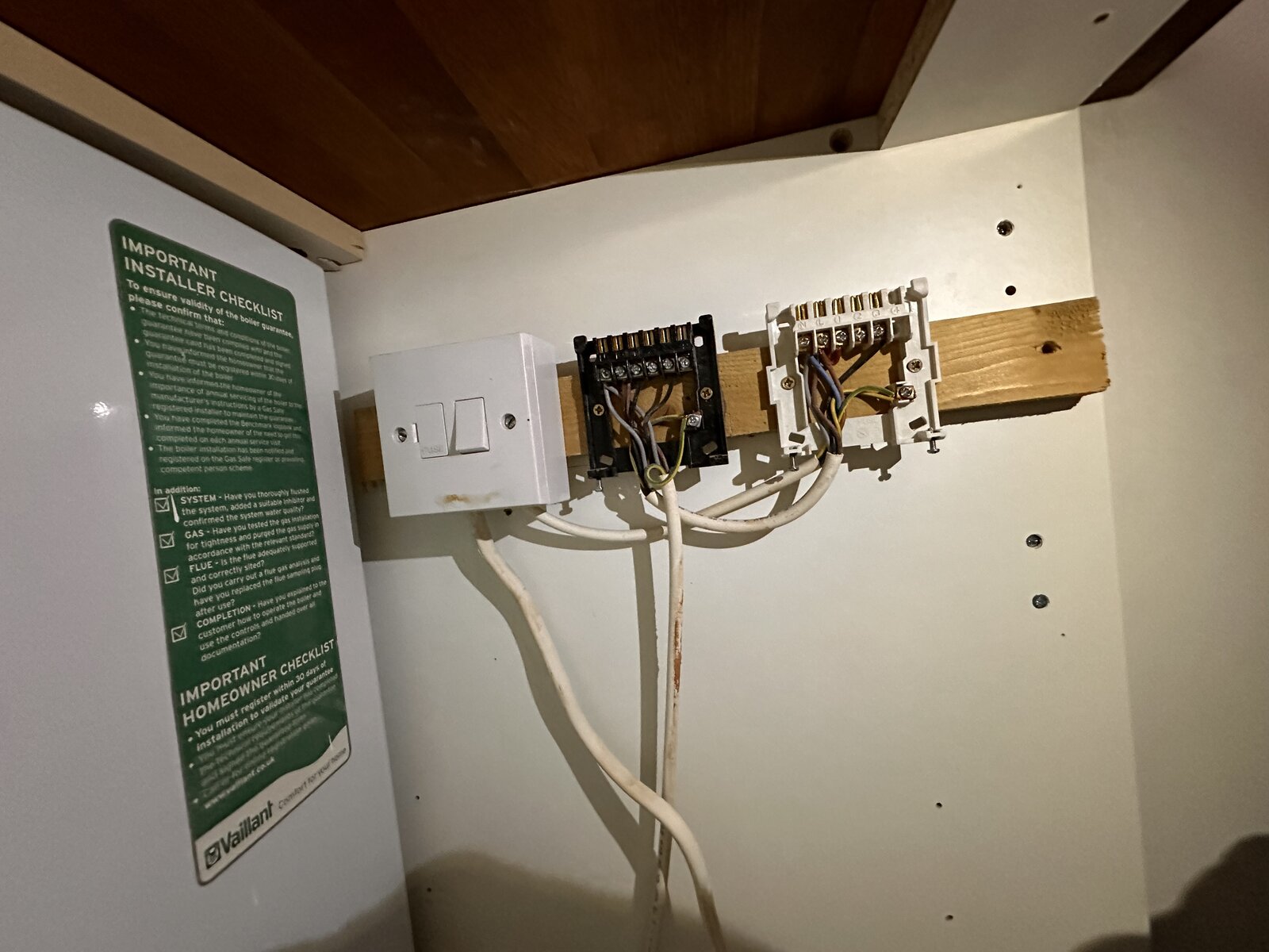

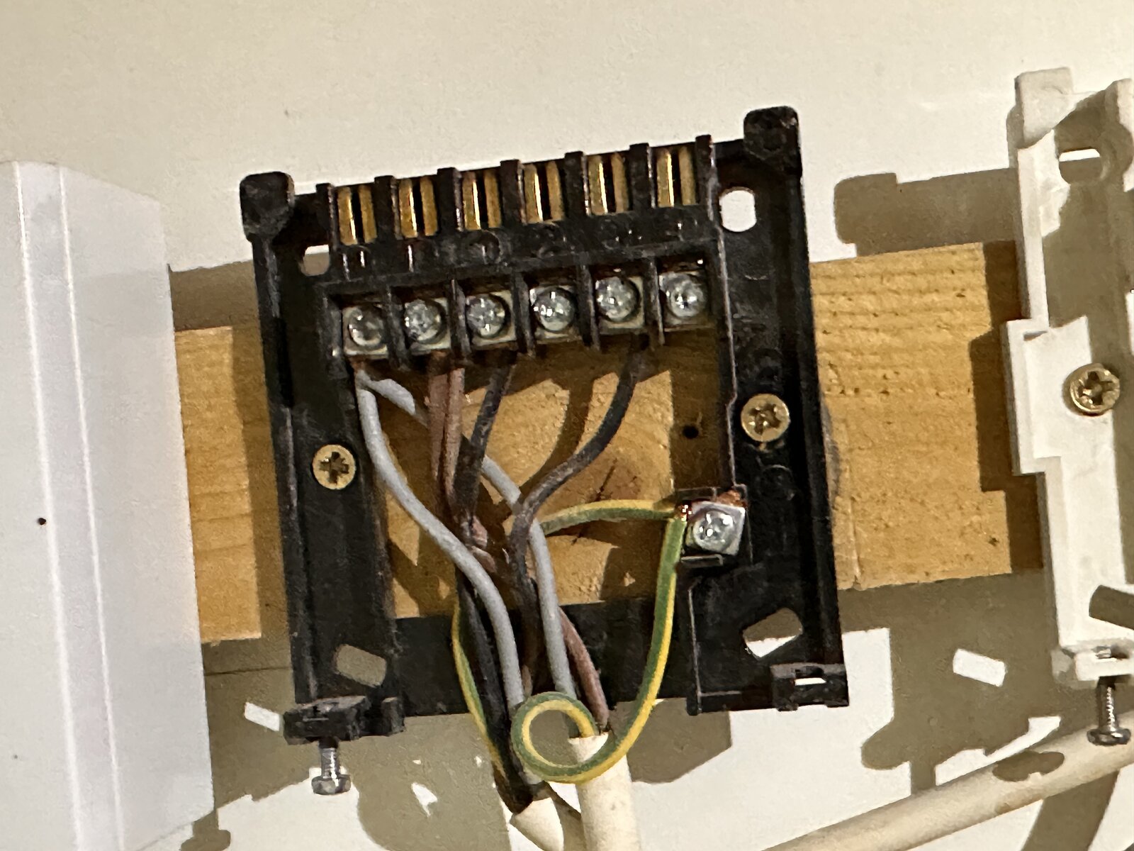

With the power turned off from the FCU switch, could you show us the wiring behind the digistat receiver and BG programmer?
I took the covers off and took pictures.
The black one is Digitstat and White one is BG Programmer.

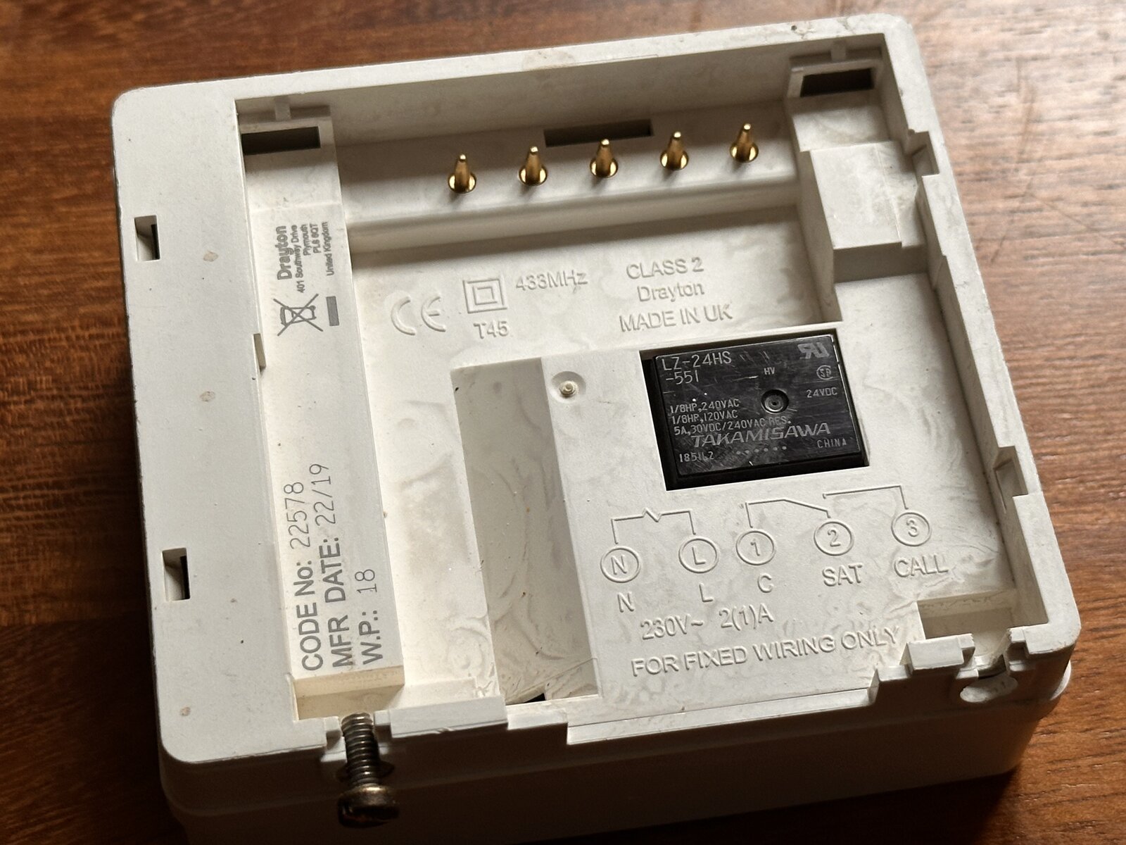

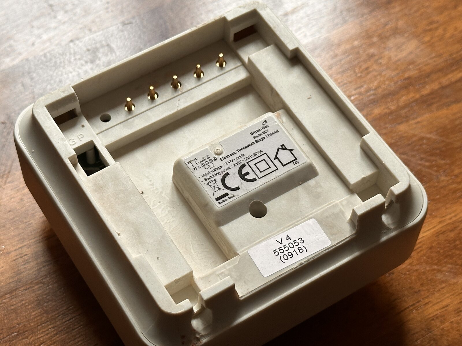

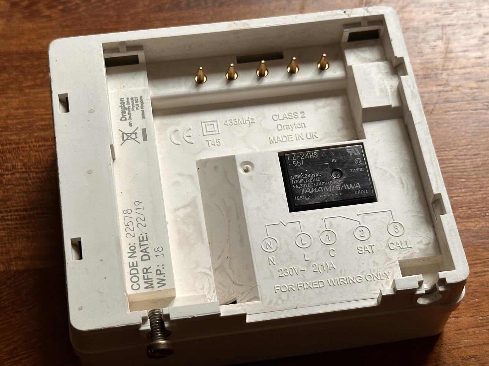

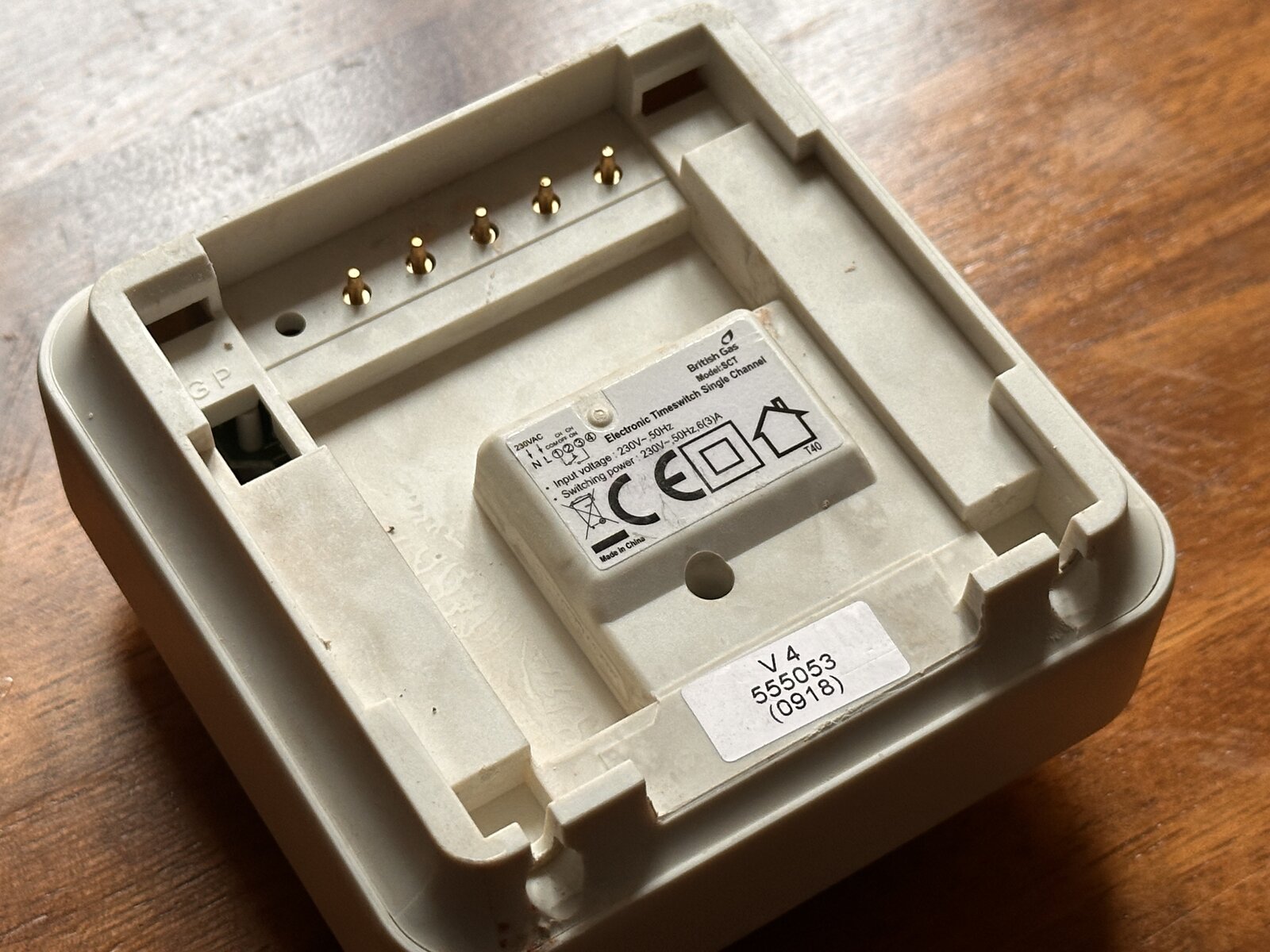

If it helps, here's the back of Digistat control panel i took off

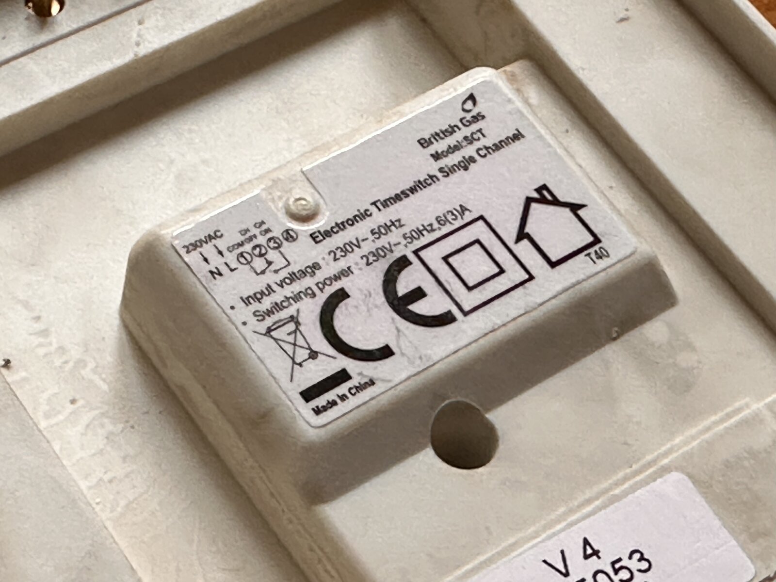

And here's the back of BP Programmer panel I took off

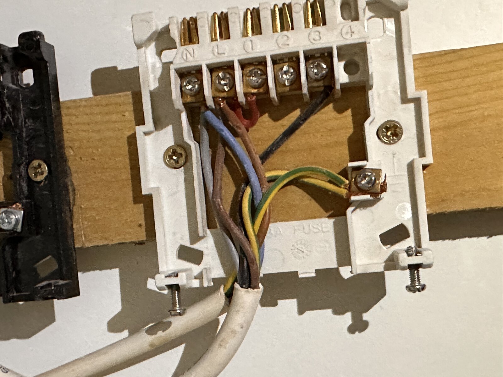

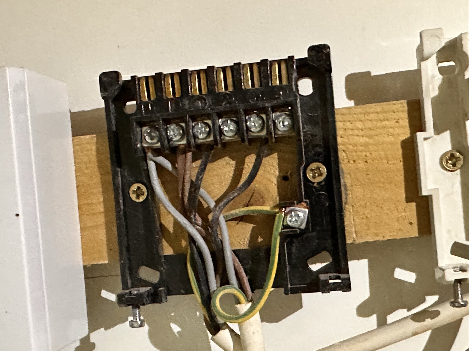

I am not sure how wired, the normal method with a modern boiler is the supply to the thermostat/timer/hub comes from the boiler, so it can't in error by-pass the boilers fuse, but with earlier boilers the whole boiler was simply turned on/off, in fact this is how my boiler works.
So can work out enough to make it work, but to work out have to make it work safely, so no fuses are by-passed can't do from pictures shown.
We are told all should be powered from the same 230 volt supply, or use batteries, two reasons, one is again so no protective device is by-passed, but the other is to ensure any uninterruptible supply (UPS) feeds all needed for the central heating to run, so the supply to the USB power supply should come from the boiler supply.
I have also fitted Nest Gen 3, as it means two wires from the heat link to the thermostat allow supply to thermostat, CH control and DHW control all with just 2 wires, however since fitting, been rather disappointed with it, and have fitted Wiser as well, as the Nest will not link to TRV heads.

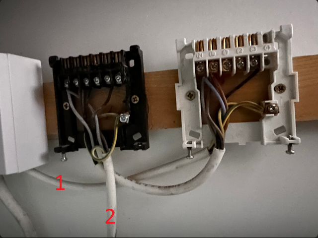

So I have labelled the cables 1 and 2.

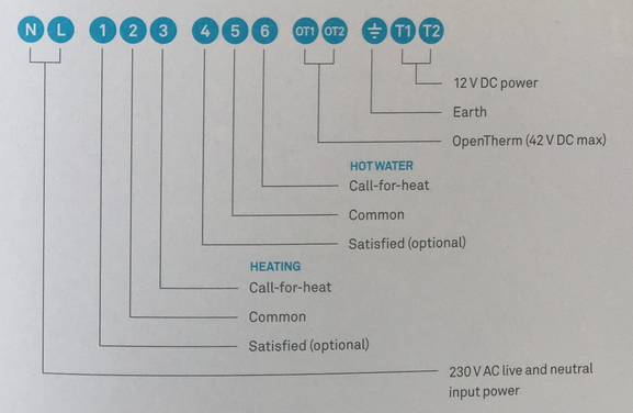

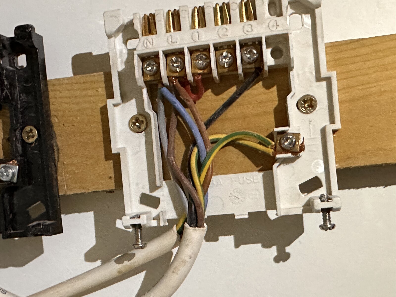

cable 1 is the live feed, Brown is Line, can't quite make out colour of the neutral but with Nest Gen 3 that cable goes to L and N
wire 2 grey is neutral (N) and brown is line (L) and the black seems to be switched line, so will go to 3 on Nest Gen 3 with a link from L to 2 (common). I am assuming not domestic hot water? There is a terminal for the earth, may as well use it.
I found very limited space in the Nest Gen 3 heat link, so mounted a junction box below it, but you have less wires to me.
I was very disappointed with Nest Gen 3, had to disable most of the features, geofencing caused a very cold house when EE mast went down, the anti legionnaires function was firing up boiler when not required, it is still connected but only really to work DHW if we have poor solar days in the summer.
It appears that you have a white, flat, twin and earth cable feeding the boiler FCU (fused connection unit). The cables are then daisy chained through the BG Programmer and Drayton SCR.
So, to summarise; Eric's comments above related to system components being fed from the same circuit, are largely irrelevant - the boiler and controls do appear to be fed from the same FCU.
cable 1 is the live feed, Brown is Line, can't quite make out colour of the neutral but with Nest Gen 3 that cable goes to L and N wire 2 grey is neutral (N) and brown is line (L) and the black seems to be switched line, so will go to 3 on Nest Gen 3 with a link from L to 2 (common).
This is mostly correct, but to state in a clearer way, and to aid with wiring up the Heatlinks small terminals...
With cable one, connect:
Brown wire, to Nest Heatlink L
Blue wire, to N
Green/Yellow wire, to the earth terminal
With cable two, connect:
Brown wire to Nest Heatlink terminal 2
Grey wire to N
Black wire to terminal 3
Add a short link wire between Heatlink terminals L and 2
Just to add, because these cables are daisy chained, the green/yellow wires MUST remain joined to each other.
Connecting them together within the Heatlinks earth terminal, will retain earth continuity to the boiler.

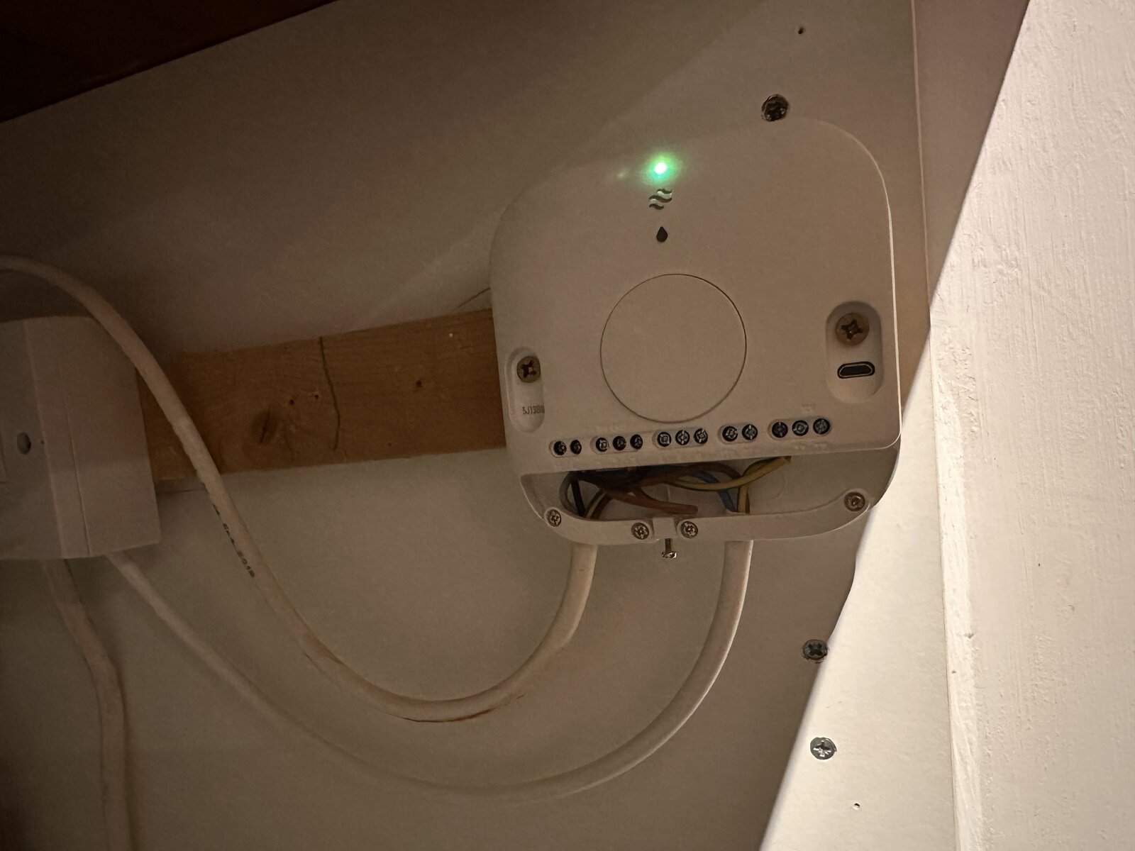

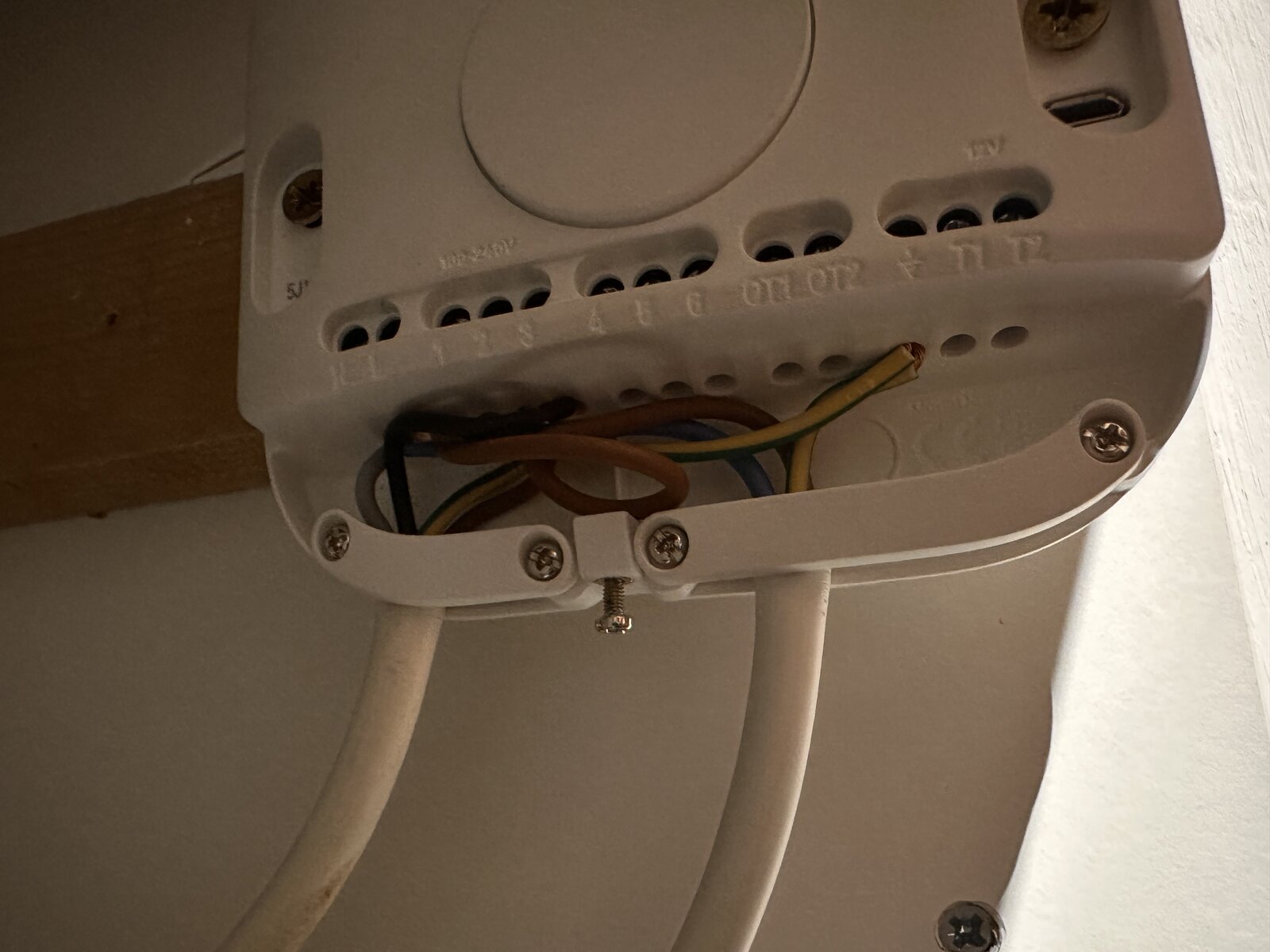

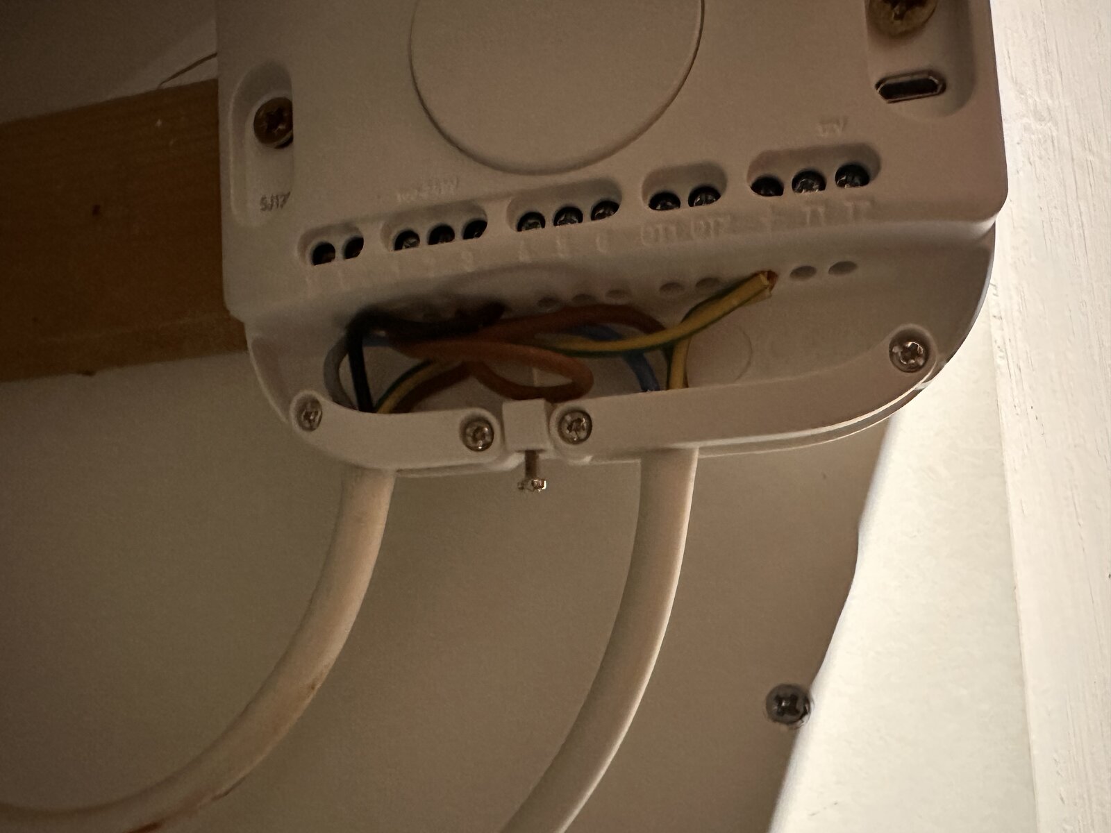

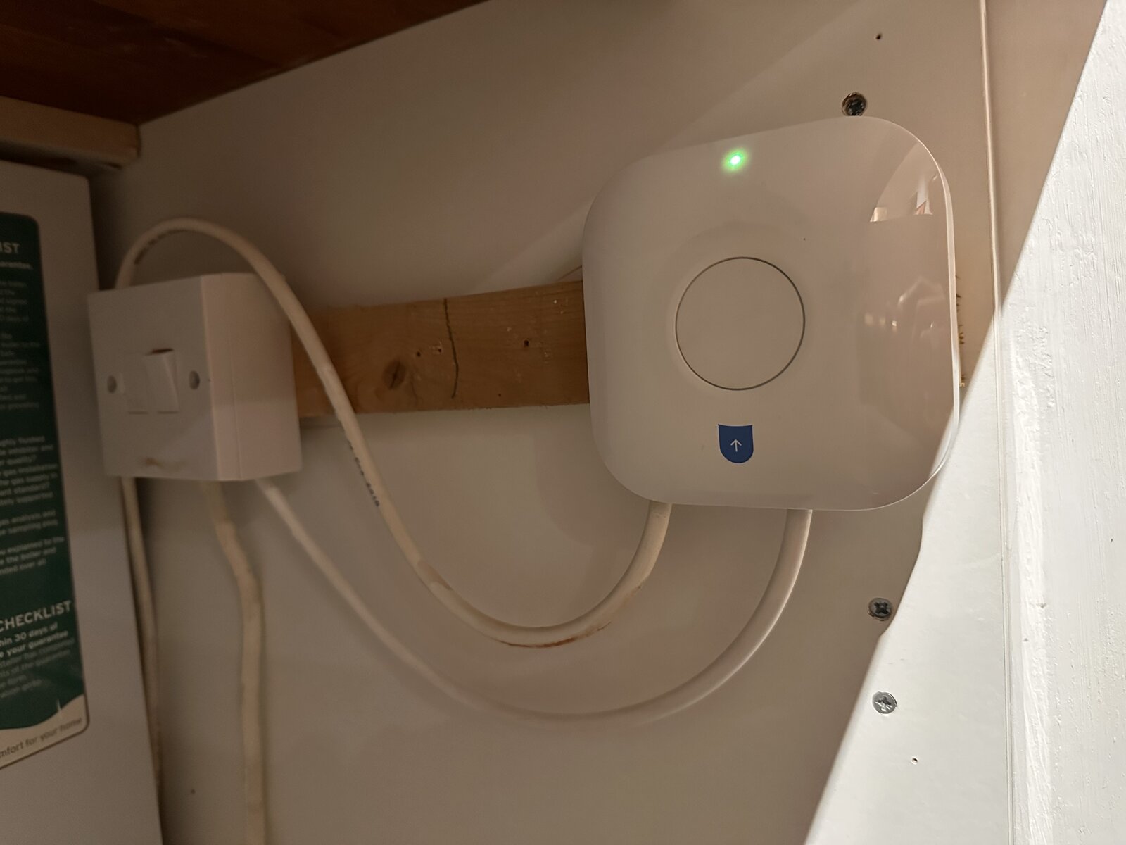

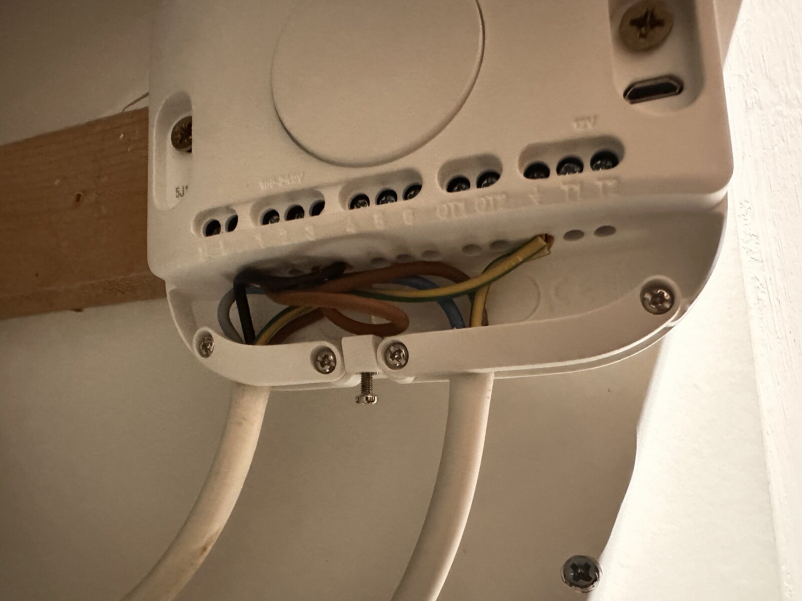

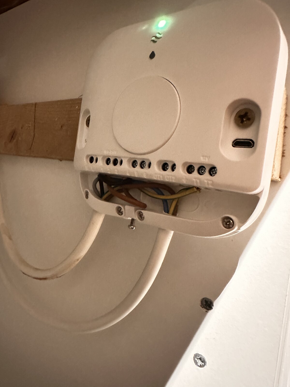

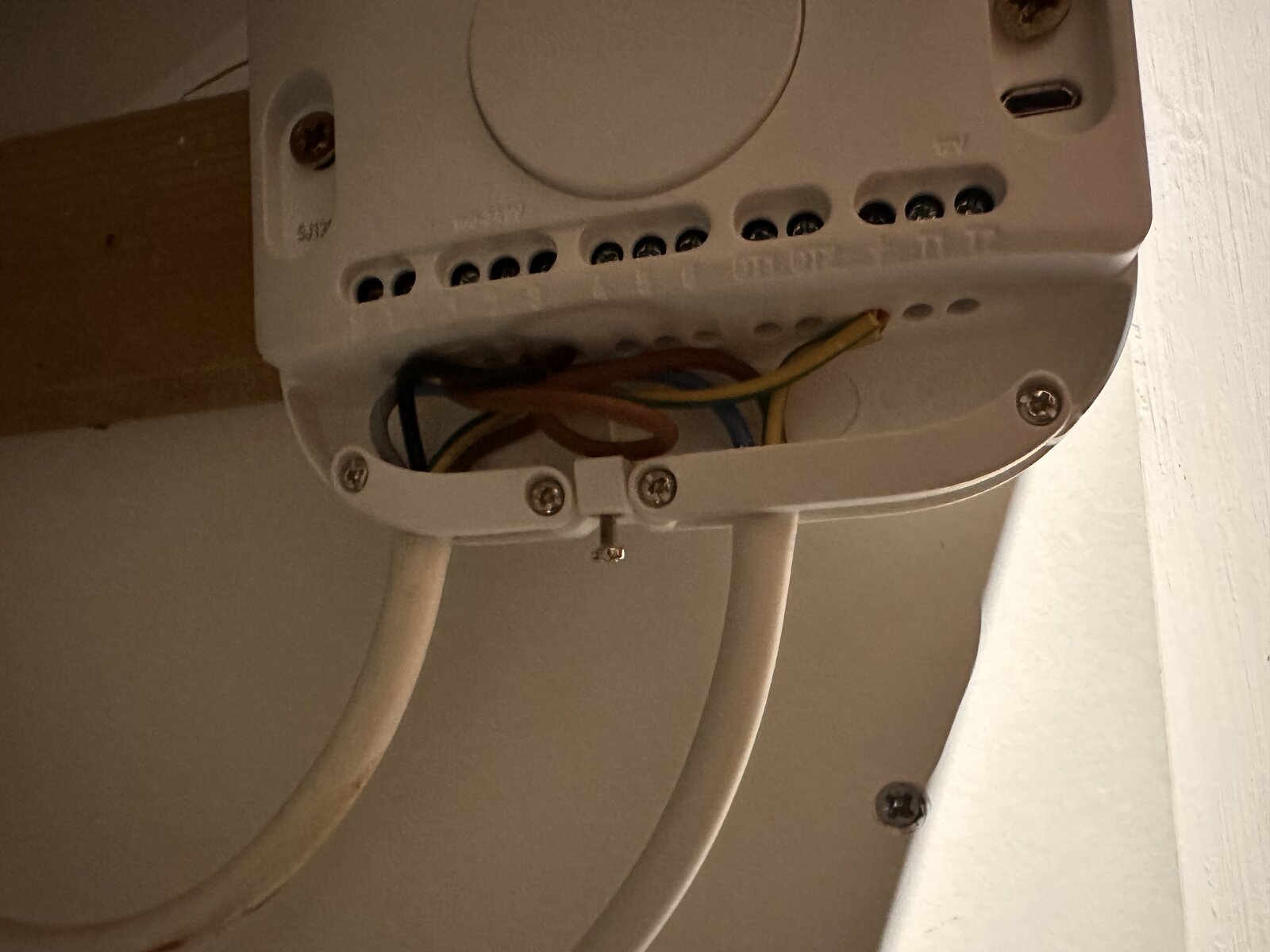

Thank you EricMark for your detailed reply and RandomGrinch for giving clarity.

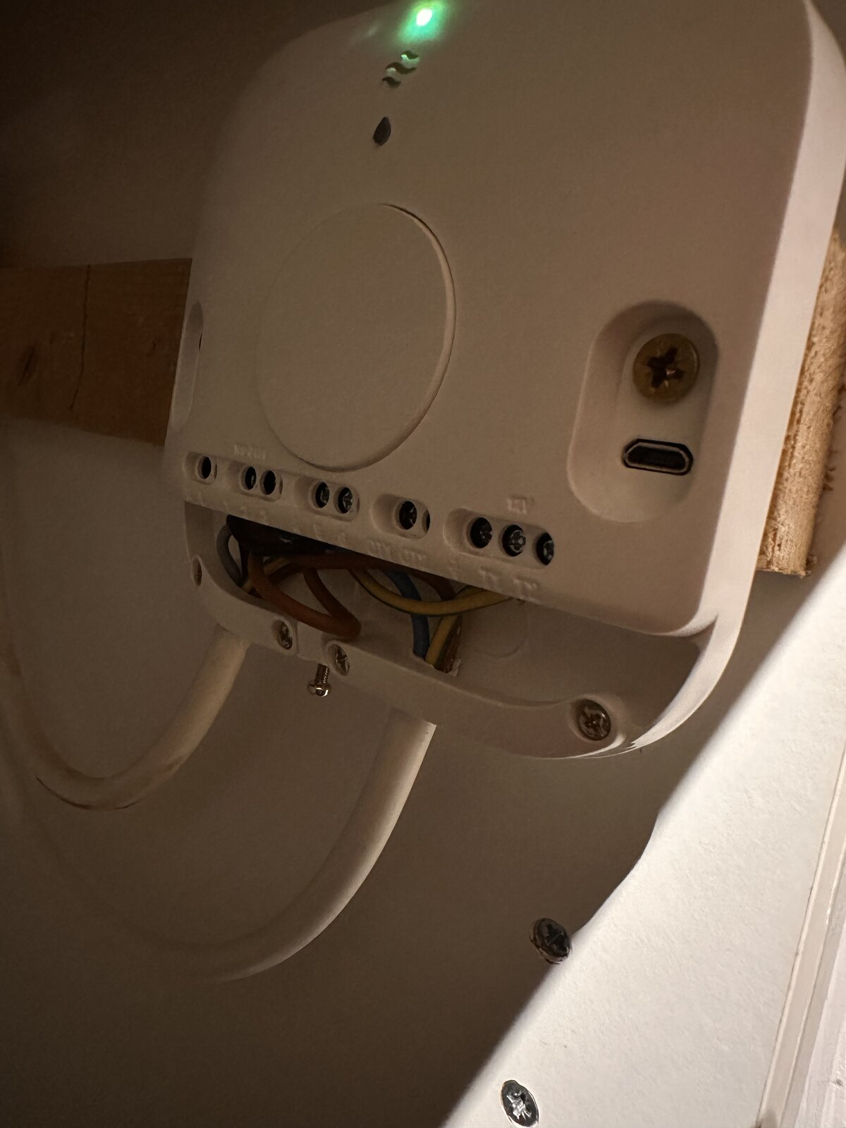

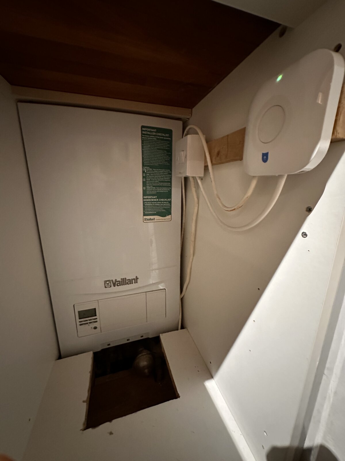

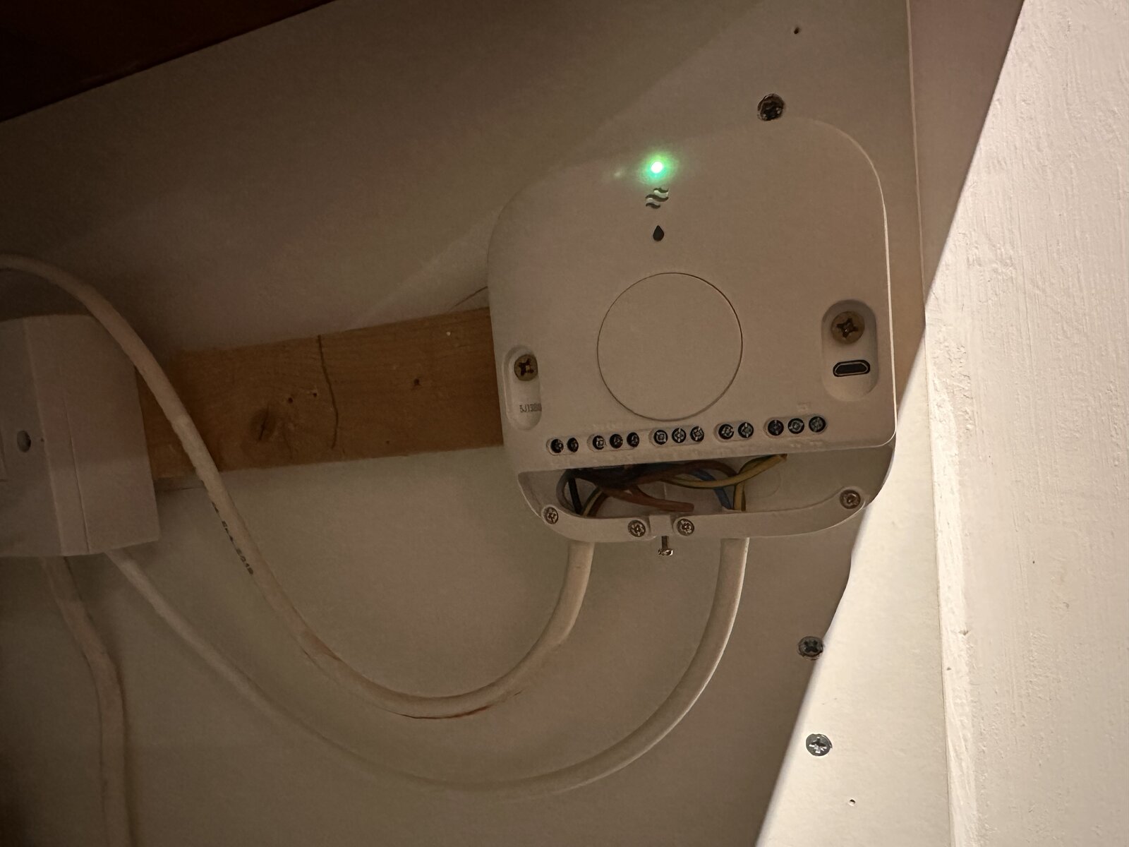

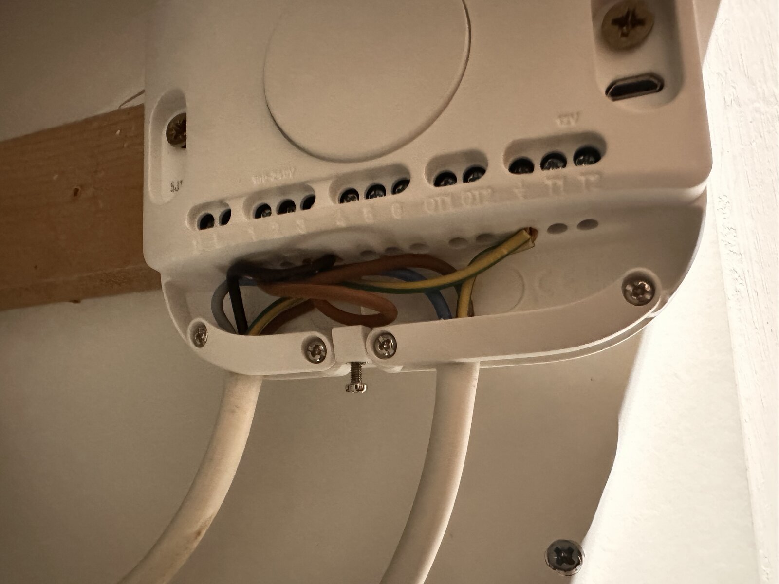

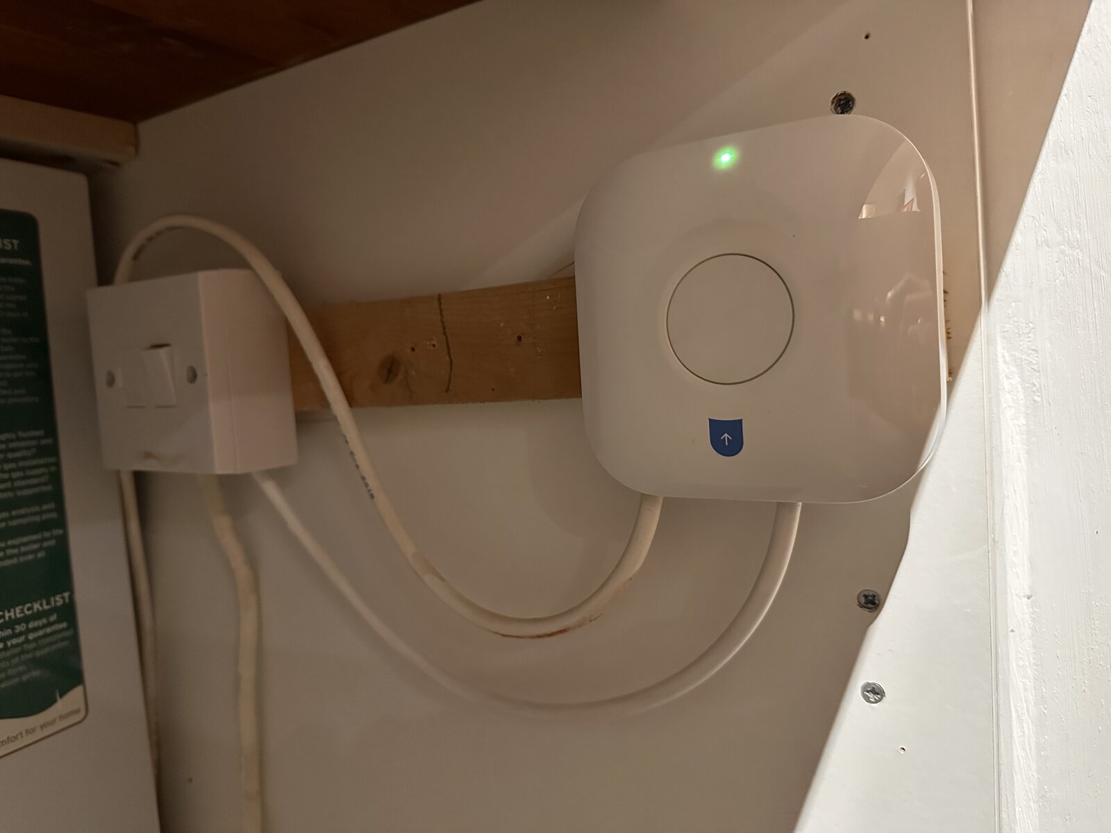

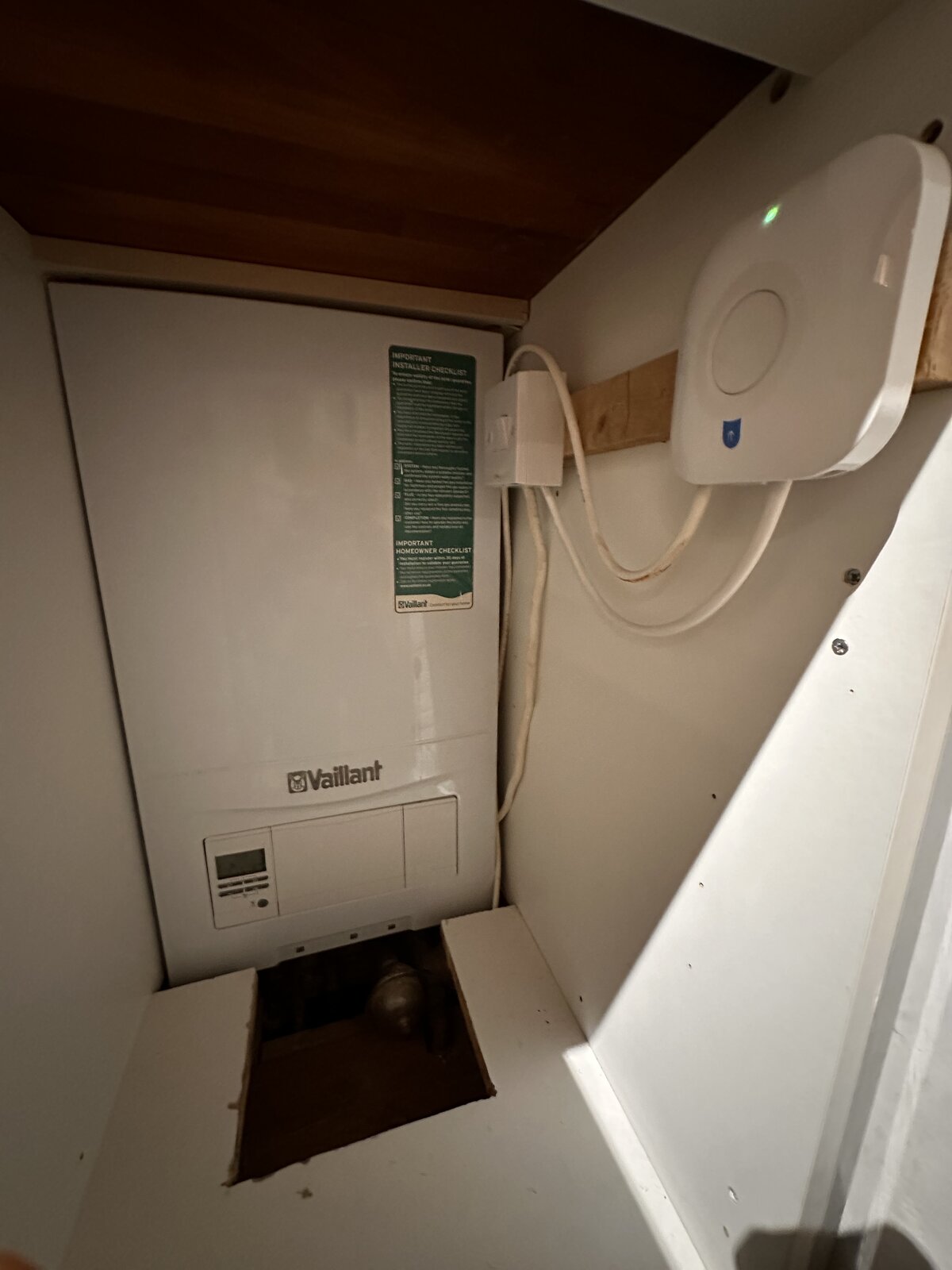

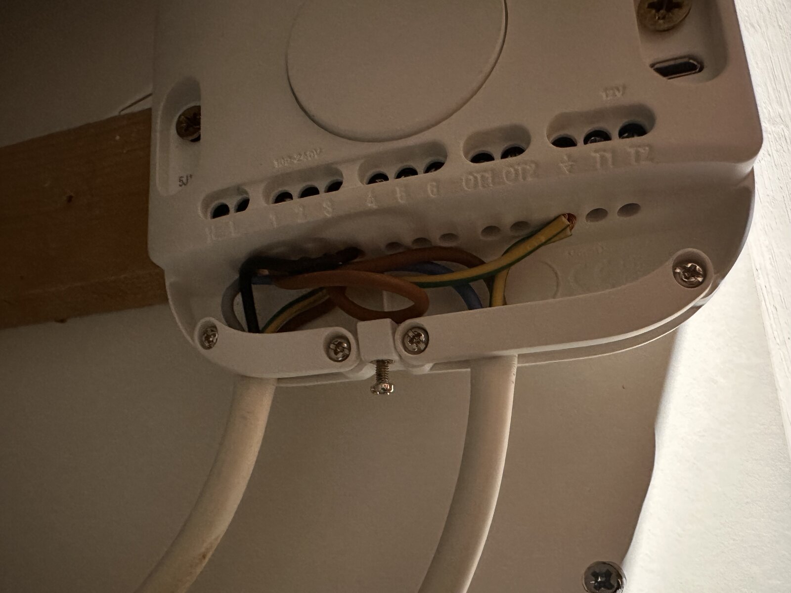

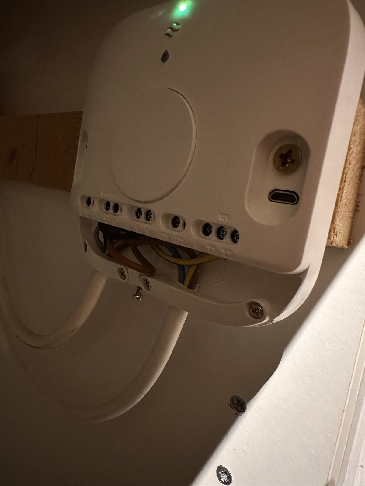

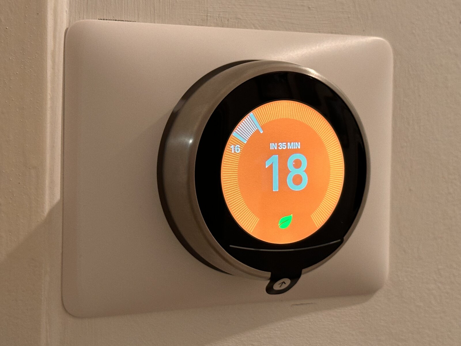

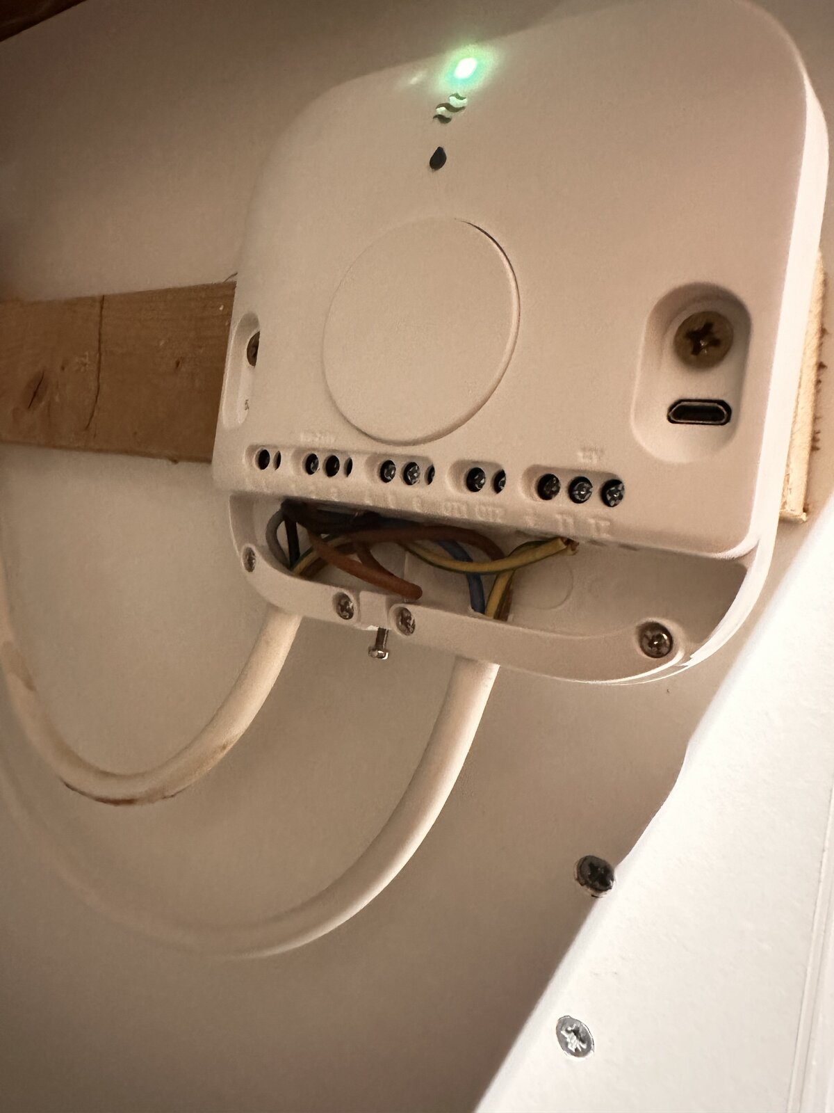

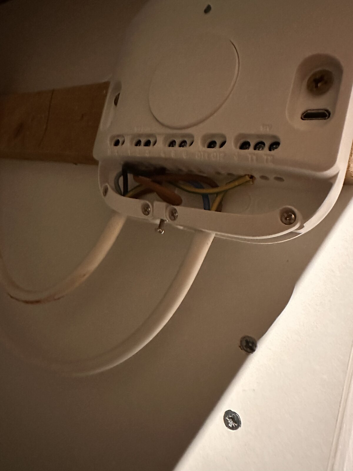

With the guidance provided I have managed to remove the old controller and mounts and replace them with the Nest Heatlink.
Have a look at the pictures(hope they make sense) and let me know if you see any problems. It all seems to be working fine, I think.
If anyone is attempting the same thing please note the Nest Heatlink port for cables as seen in images below are tiny and there isn't much space to maneuver the cables into position!! if you are aiming to join two cables and into the same socket - a nightmare. the rubber sheath is too thick for both cables to squeeze into the tiny hole. so there will always be a bit of naked cable outside the holes. To overcome this please get ferrules and a crimping tool. It is really worth it (I need to do this).
Also, you can't tell nest to turn off boiler in scheduling, you just tell it to maintain a very low temperature of 9-10 degrees so boiler can be shut off. Quite lame really. I hope there aren't any other lame surprises.
Once again, thank you so much (y)

It looks ok from what I can tell. You can get a crimp tool fairly cheap. Also, the scheduling off will turn off, so I don’t understand what you mean.

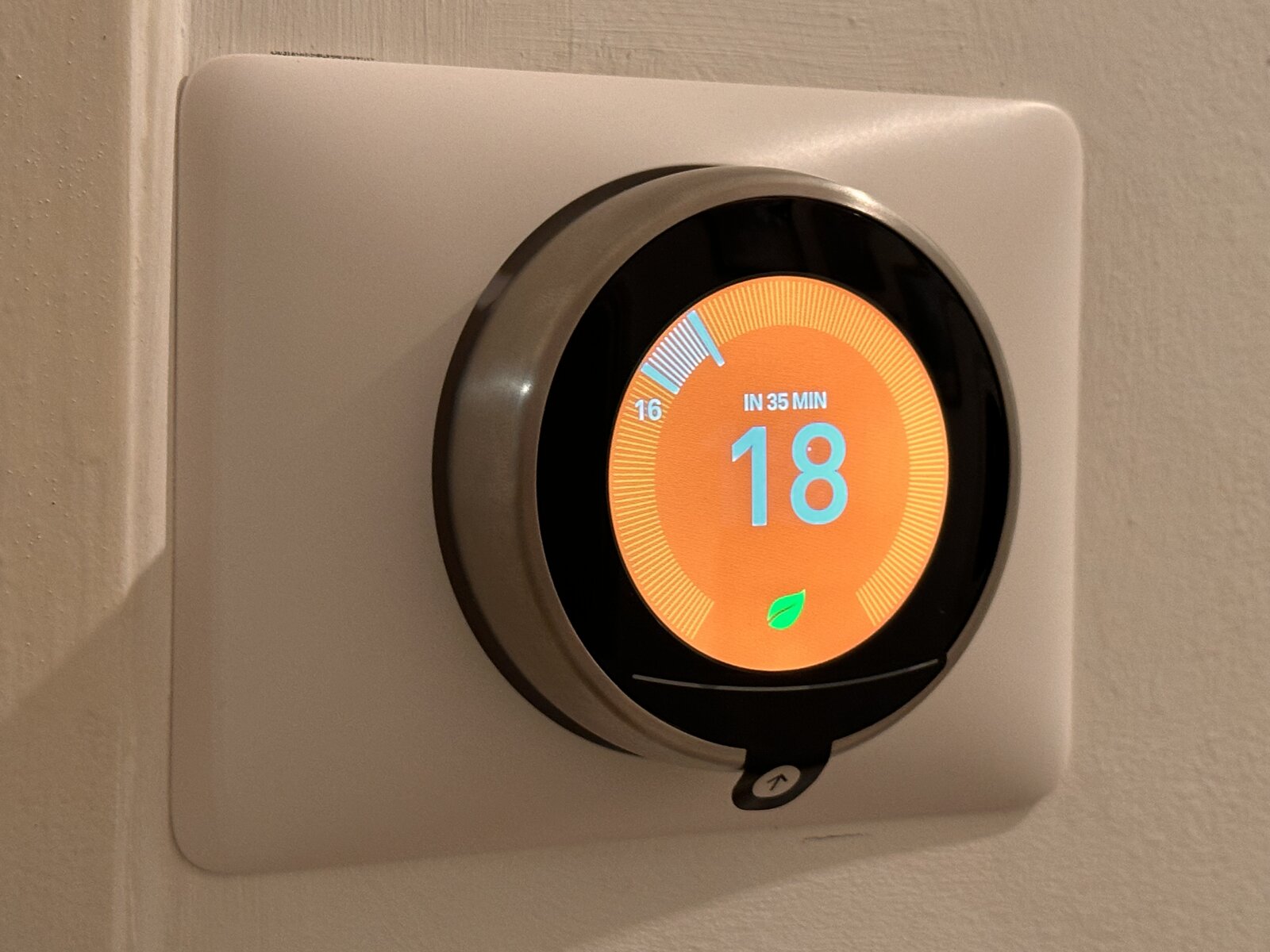

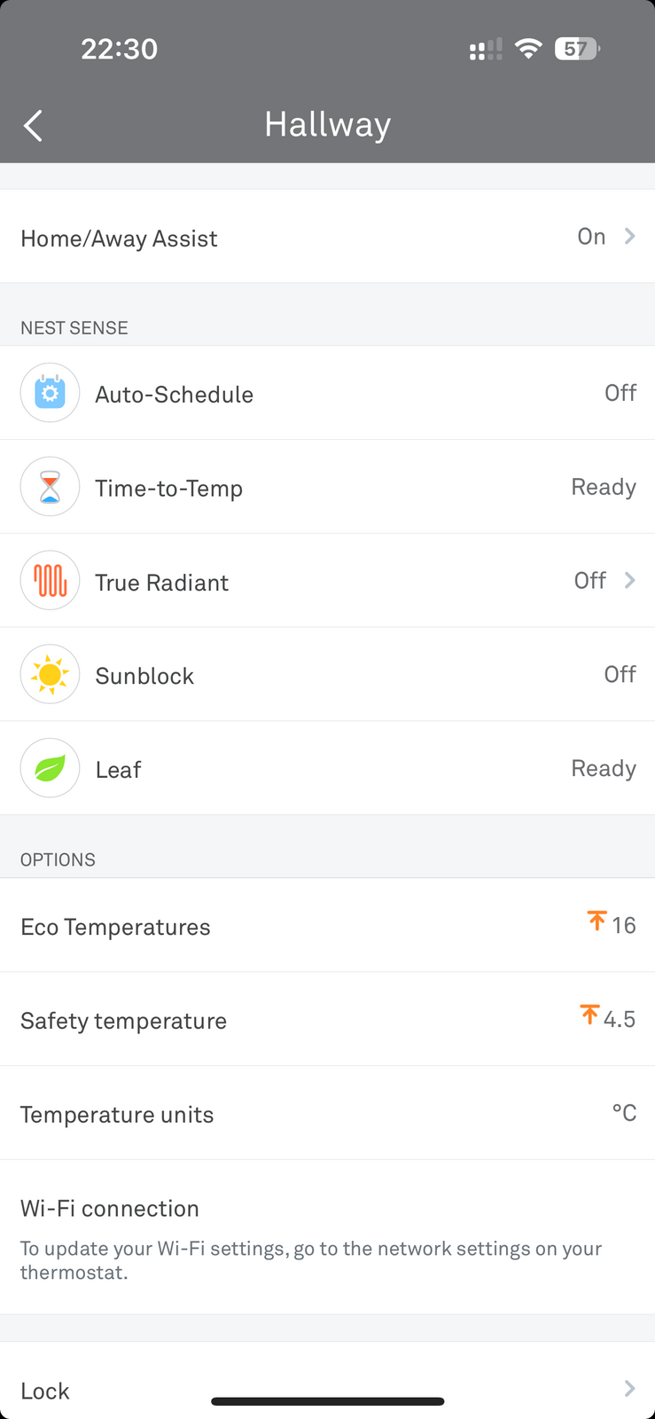

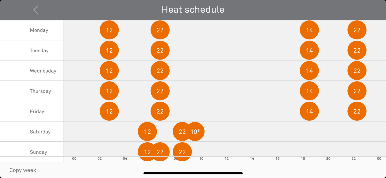

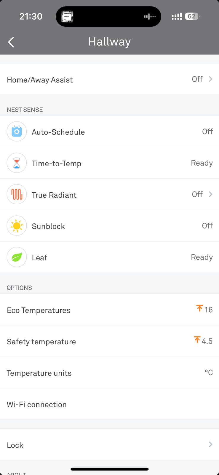

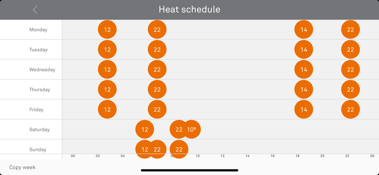

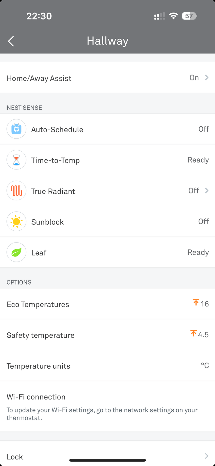

A nightmare. Am I missing something here?

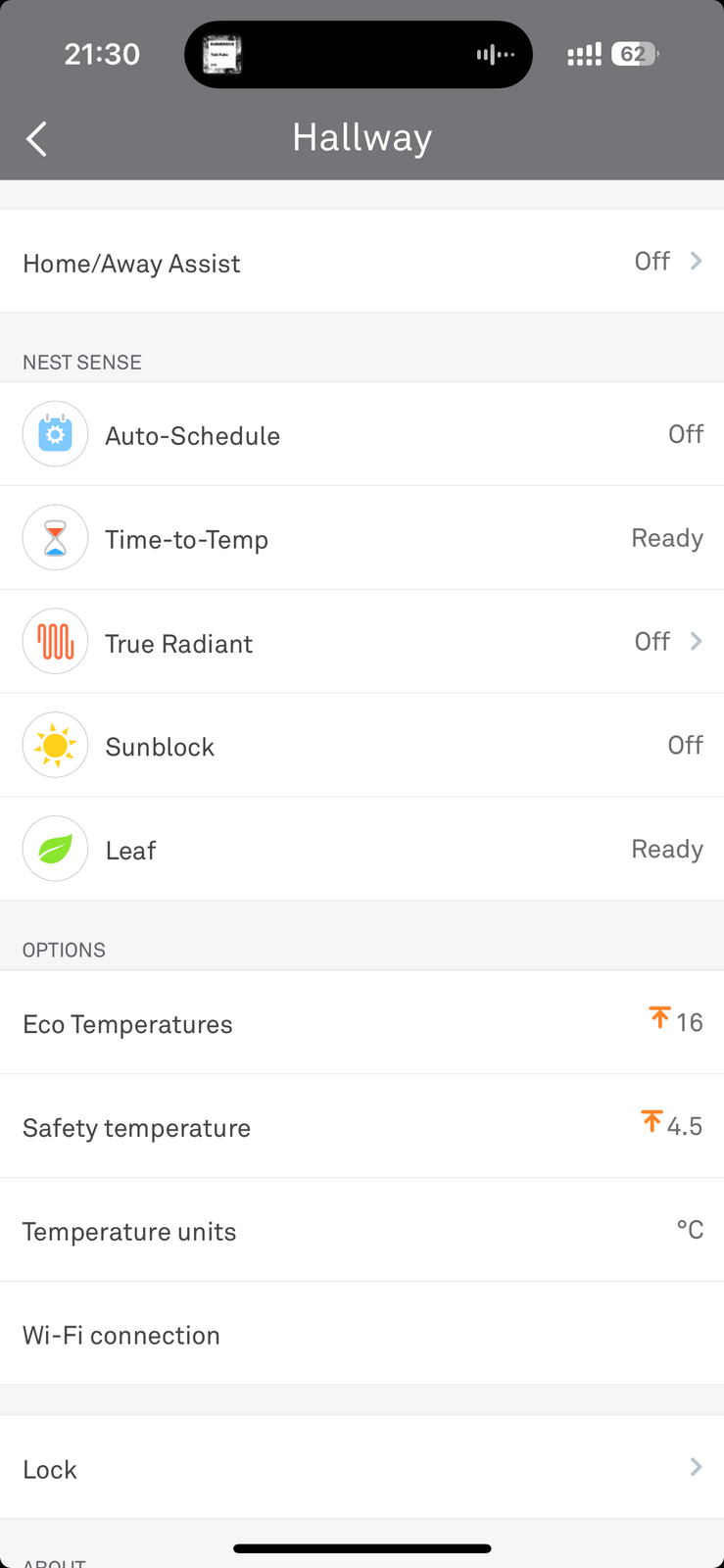

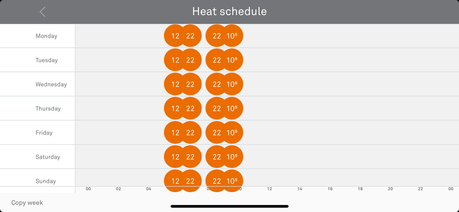

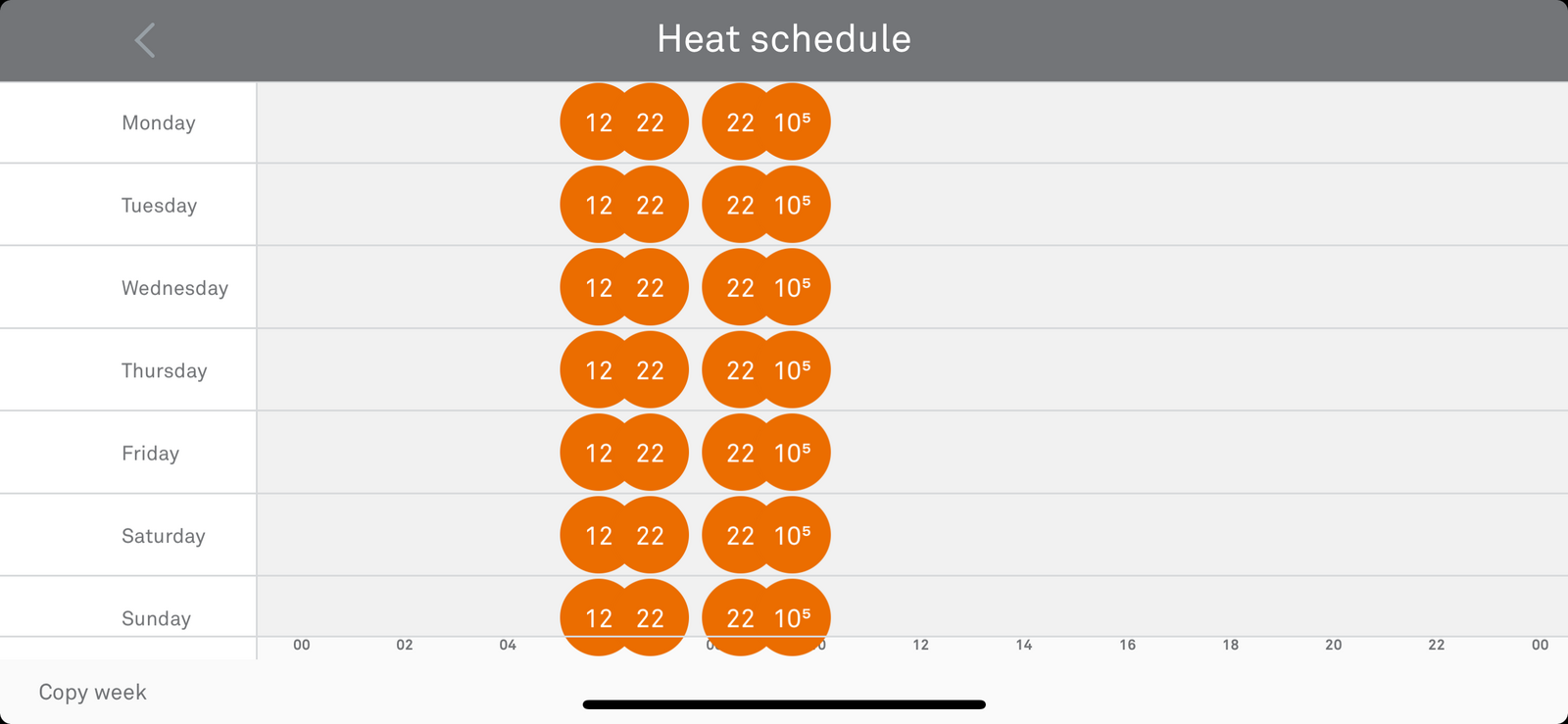

The automatic and smart scheduling features are a complete dud.
You have to turn the temperature really low hoping the temperature in your home will never drop that low and heating will never turn on. There is no option to just turn it off in scheduling.
First Image - I reset the scheduling to my preferred times as I only want heating in the morning when I am home. This is the schedule I set at 21.30.
Second Image - All auto features are turned off.
Third Image - One hour later, 22.30, fxxxer turns the Home/Away Assist on.
Fourth Image - Next morning, it has changed all of the schedule.
This has been happening every bloody day. Every day I come home to find heating has been on.
I have no idea what to do. Is this faulty? Or is this something everyone is experiencing?
Mind you this never ever happened, ever, with the previous setup when I had with Drayton and BP programmer.
I don’t have much experience with Nest I’m afraid. If no luck here, maybe contact Google/Nest or ask their community forum?
