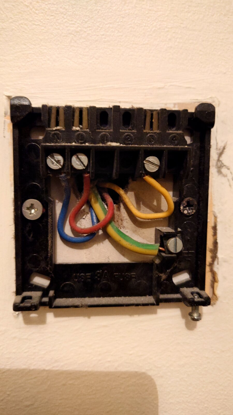

Hi there,
I'm replacing a Drayton Tempus 2 with Refoss MTS200 and it's a little unclear which wire goes to where.
The existing wiring looks like this:

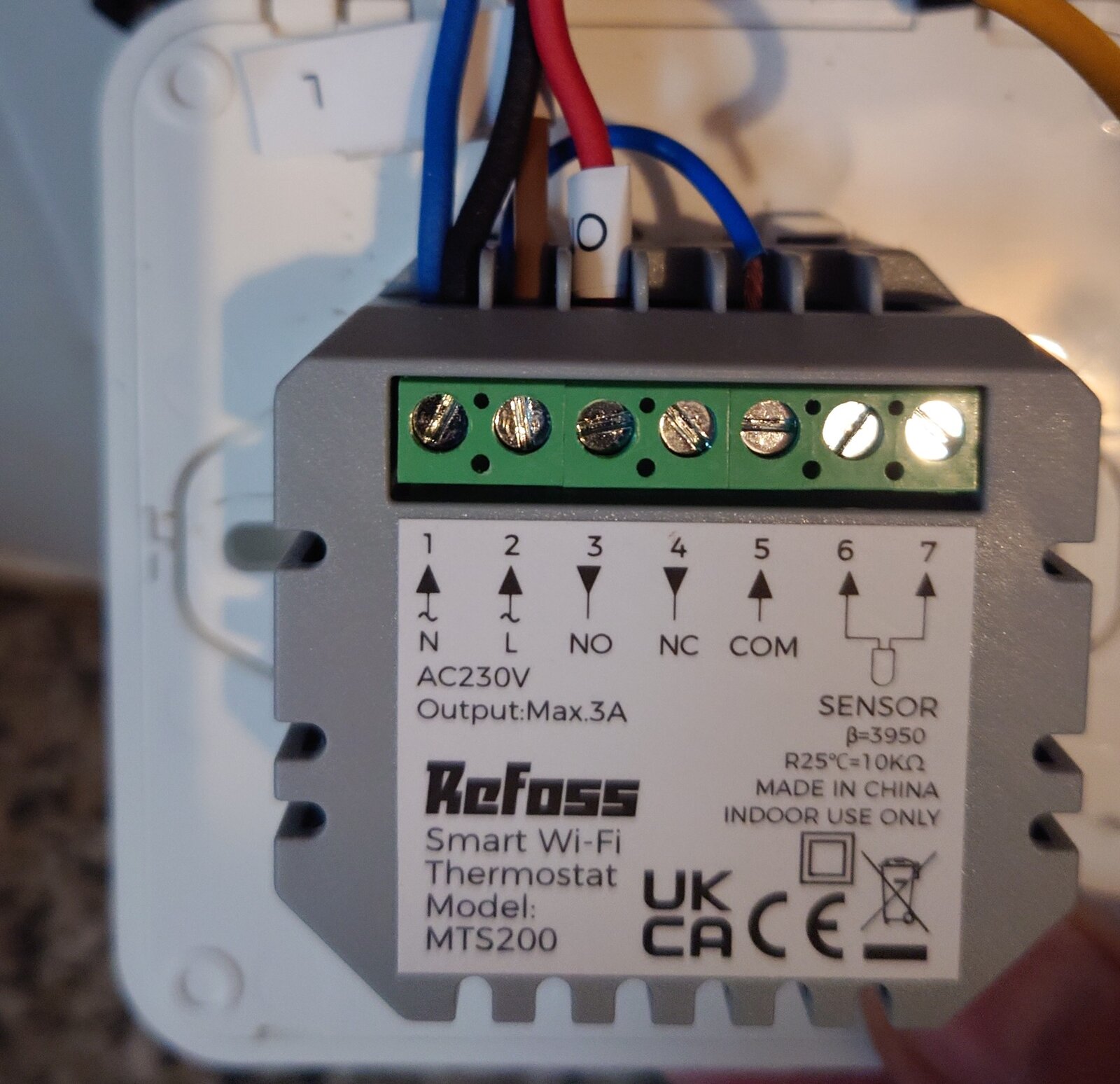

And the Refoss MTS200 looks like this:

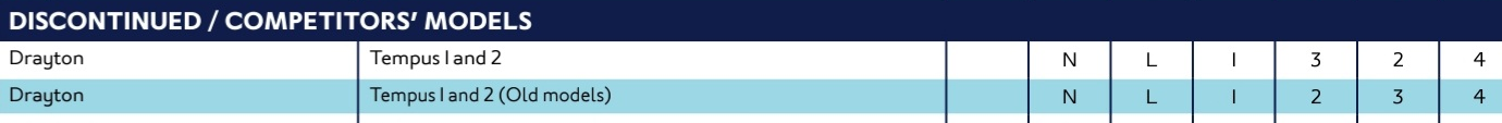

I had to search to confirm, but your single channel Tempus 2 had
Terminal 1 as common
Terminal 2 as Heat N/O
And Terminal 4 as spare.
Transferring that across:
N on Tempus to N (terminal 1) on Refoss
L to L (terminal 2)
Red in terminal 2 to NO (terminal 3)
Add a small link wire between L (2) and COM (5)
The blue (oversleeved red) and the yellow in terminal 4 can be joined together and safely isolated in a spare terminal block.
The green/yellow earth cables must be joined together and safely isolated in a separate terminal block, or the back box if it is metal.
As the existing spare terminal 4 is being used, this may suggest that you have a separate thermostat mounted somewhere?

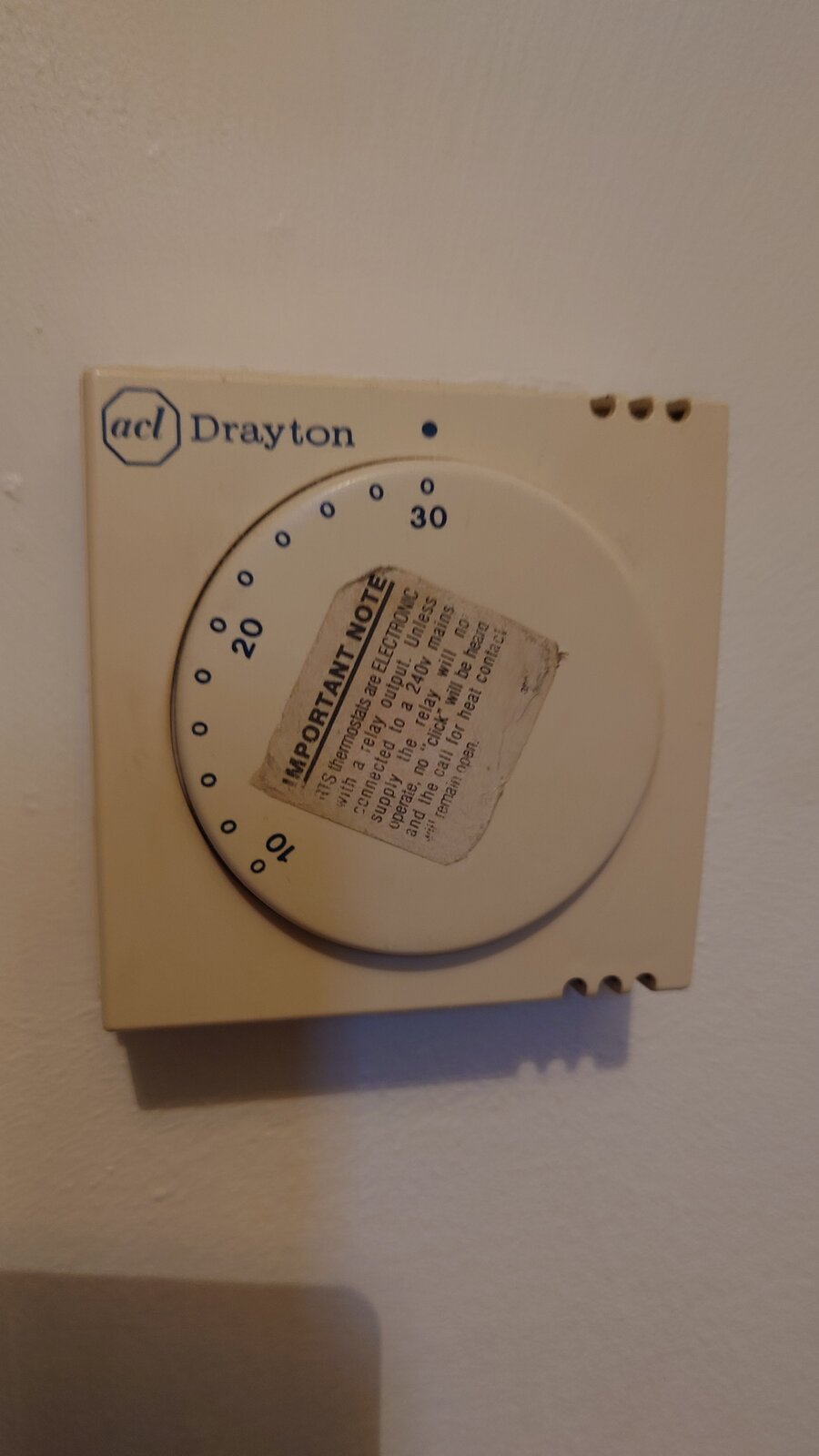

We do indeed have an old rotary thermostat elsewhere in the house. Assuming I can leave this disconnected?
Thanks again.

OK, installed and working as per all your advice. Thank you so much! Only issue is the external temperature controller in the other room is still dictating the temperature that the boiler clicks on and off at. Must be wired into the boiler itself perhaps?
For reference here's the connections I made into the Refoss. And here is the ancient temperature selector:

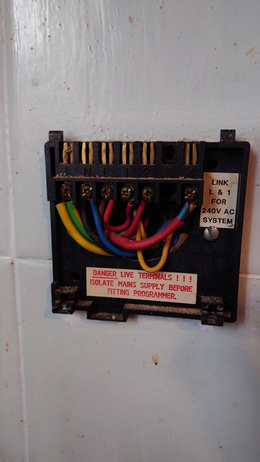

And this is the wiring behind the room thermostat:
Thank you. Apologies I hadn't responded sooner to your request of a picture, I was being thick and thought you meant the existing thermostat image
Ok, try removing the red wire from terminal 3 of the Refoss, and putting the blue (oversleeved red) wire in its place.
If that works, the remaining wires from that (blue/red/yellow and earth) cable can also be disconnected.
