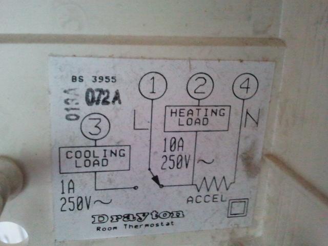

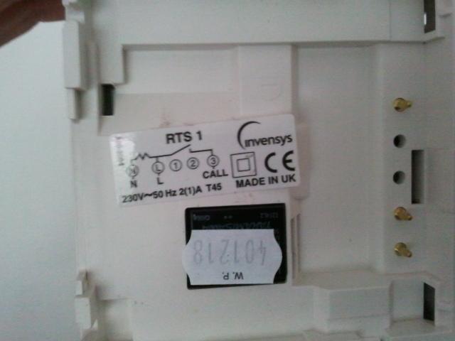

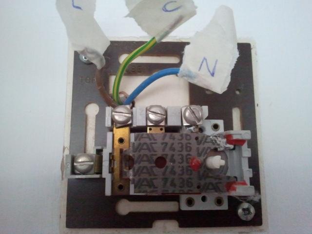

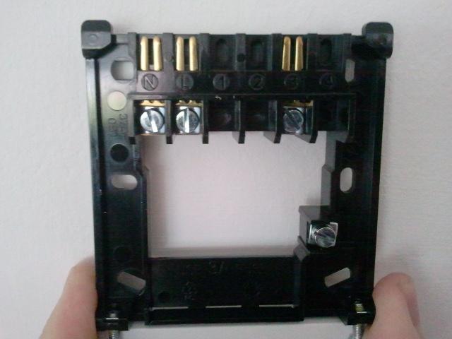

Now, we are waiting for the boiler to be changed over to a combined but obviously no heating at this time of year is not nice! So I thought I,d try the quick/easy route of replacing the thermostat. I've just changed the old Drayton thermostat for a new Drayton RTS1, but he heating still won't come on.

how many wires went to the old stat? Lots of older ones just have a permanent live (in) and a switched live (out), plus an earth wire.
The newer ones (and IIRC the Drayton you mention) has an electronic sensor, and it needs a permanent live and a neutral in, to give it power, as well as a switched live out, so you need 3-core and earth cable.
DON'T use the earth wire in twin and earth for a to carry current.
You can get other stats which run off a battery, it usually lasts two or three years.
There are probably old-style stats with just a bimetallic strip that would work like your old one, though they are not as sensitive and accurate as the new type.
