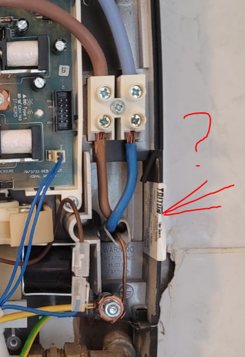

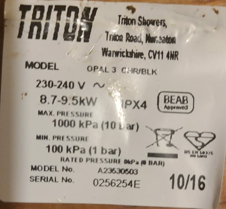

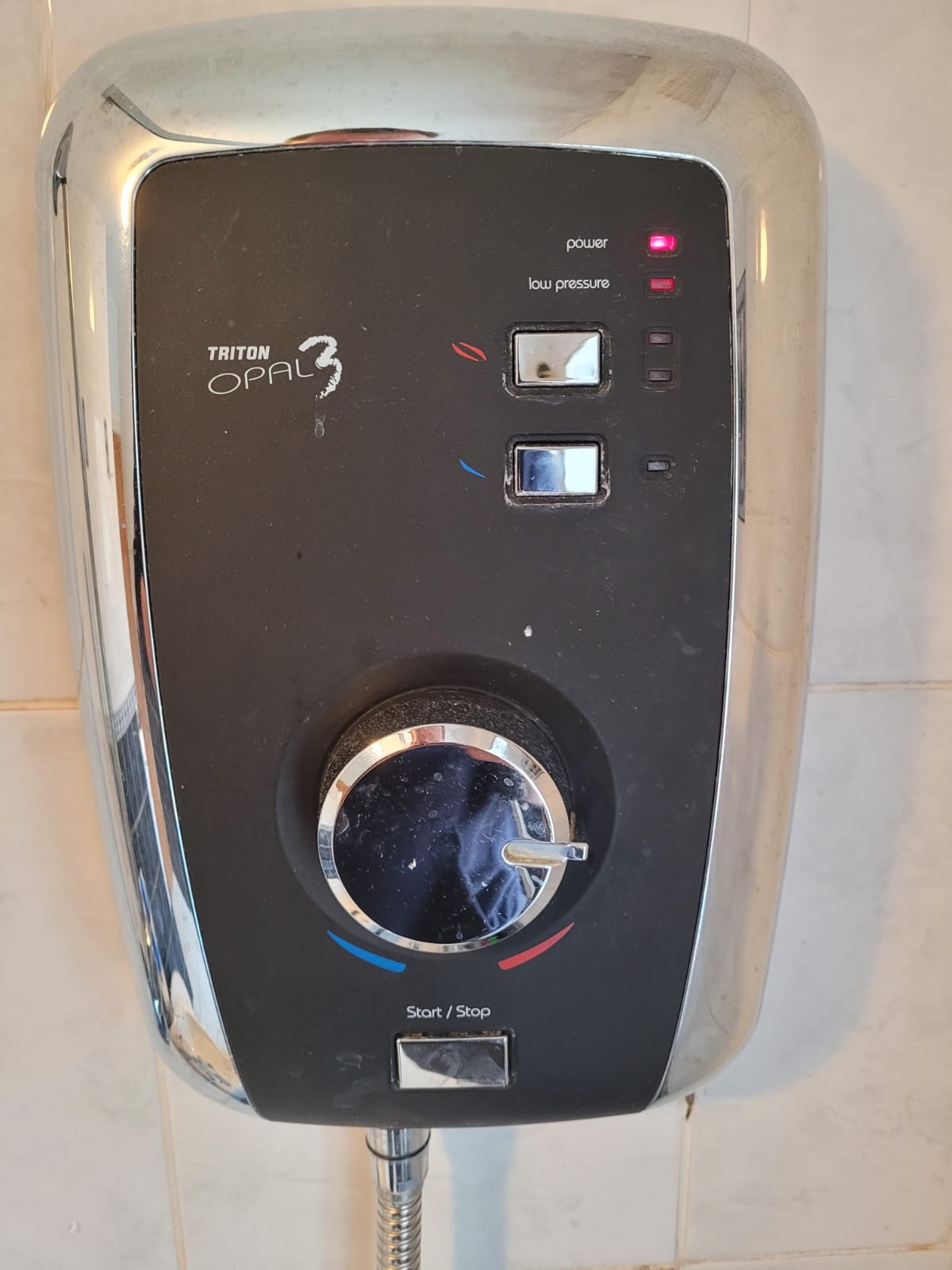

We have a triton opal 3 electric shower
Unsure what kw it is as there are various versions, is there anyway i can find out?

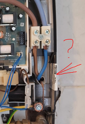

The wiring is it 6mm or 10mm? I think its 6mm?
The fuseboard is 5 metres away from the shower which has a 40amp mcb
What is the max kw shower we can upgrade to with the existing wiring?
Not 10mm².
Smaller than the internal cables. Hard to tell whether 6mm² or 4mm².
Should be 6mm² then.
9.5kW with 40A MCB.
10.5kW with 45A or 50A MCB .
Not 10mm².
9.5kW with 40A MCB.

8.7-9.5kW depending on the exact voltage in your house.

I thought it would be a specific kw rather than a range!
