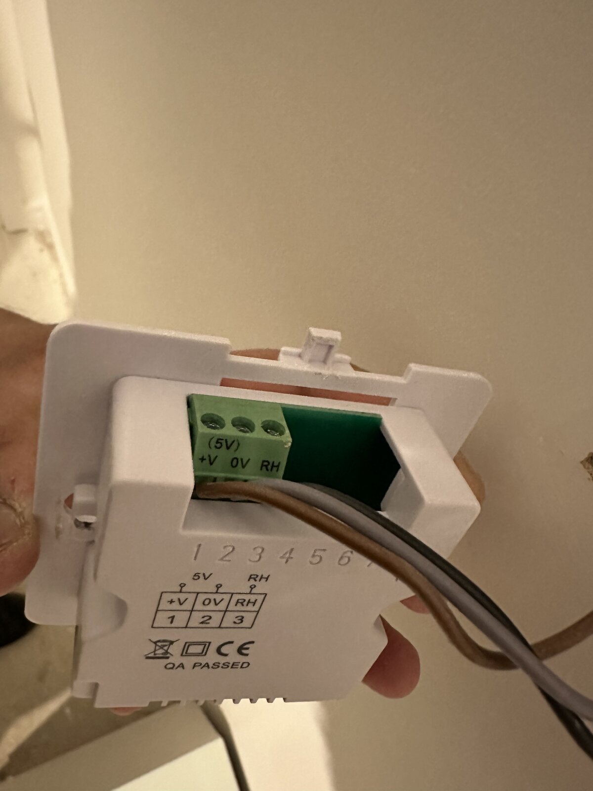

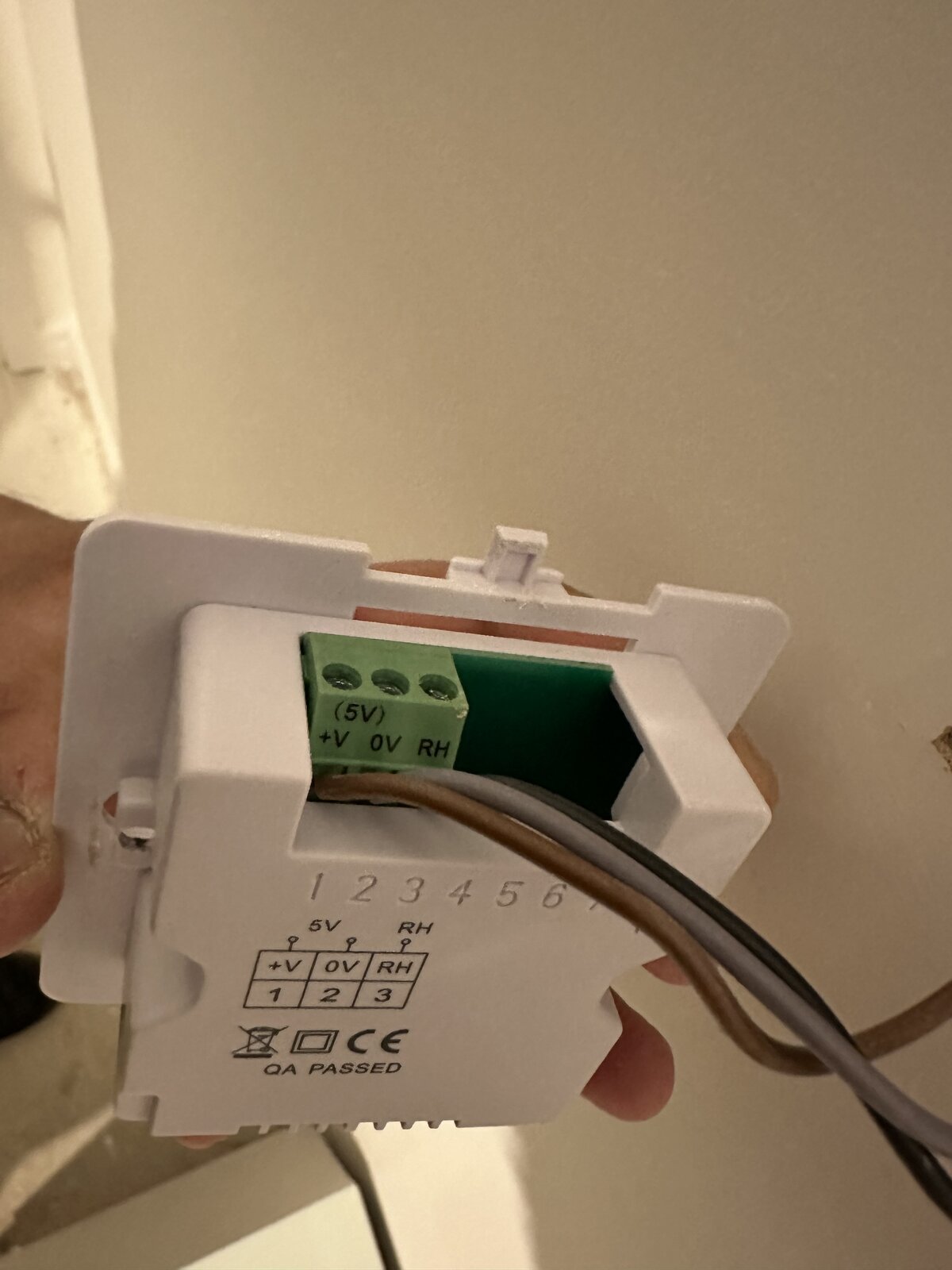

Hi,
I am planning on replacing the two thermostats in my new build house that control the dual zone central heating. The thermostats are ESI ESRTP6C are connected to a wiring system that is connected to the combi boiler and two valves.
The thermostats have the following wires connected: +5V, 0V & RH.
The wiring system has the following: N, E, L & SL and +5V, 0V, RH (Zone 1) & +5V, 0V, RH (Zone 2)
I want to replace the upstairs thermostat and keep it connected via the existing wiring system. Looking at the Nest Installation information I am thinking of the following for Wiring System to Heat Link:
L > L
N > N
but I am unsure about the SL and RH on the wiring system.

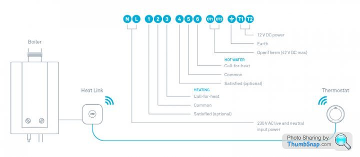

Heat Link to Nest:
T1 & T2 to Thermostat
Will the wire (shown below) for the 5V thermostat be sufficient for the 12V required for the nest?
The downstairs thermostat will be plugged in so that one will not need T1 & T2 for power supply.
Any help will be much appreciated.
L > L
N > N
It has been suggested elsewhere, that when your existing thermostat calls for heat, it is supplying 5V to the RH terminal on your 'wiring system'.
A simple test would be to disconnect one of your 'stats; place a small link wire between '5V' and 'RH', and see if the heating fires up.
Similar thread here:
If the test works, then the Nest heatlinks can replace the existing thermostats. The wiring system, including the 'SL', will be left as it is.
The heatlink connections would be:
L to L
N to N
Earth to Earth (for the heatlink you will use with t1 and t2 connections)
2 to 5V
3 to RH
Do not mix up the (extra) low voltage and mains wiring. No additional links will be needed on the heatlink.
It may be alright. It could depend on the length of the cable run. But it won't hurt to try!
There are eight separate wires in the Cat5e cable, you can split these up so four are in t1 and four in t2, to help lower the cables resistance (keep the same twisted pairs together!)
I hope that makes sense :)

To clarify, a test would be:
Remove the wiring from a thermostat at the wiring system and place a wire between the '5V and RH' on the board, as per the sketch below?
Yes.
The outcome of this test would be, I hear the valve kick in and the corresponding heating zone heats up?
Yes.
is there an earth on the heat link?
Yes, next to T1 and T2.
It is only relevant when you are using these connections to power the thermostat.
I am thinking of using the plug in version downstairs so T1 and T2 would be empty for that zone?
Yes.
SL is the wire on the opposite side of the board and this goes to the boiler?
Yes.
and no changes are required for the 4 wires block?
Yes, no changes necessary, except you can also use those terminals to provide the L, N and E for the Heatlink.
Is there a risk of putting 12V through the 4 ethernet wires?
No.
The distance is about 2m but that is plan view and doesn't count for whichever route it takes to get to the thermosat, potentially 6 maybe.
That should be fine, the worry would be if the cable was running 20m or so!
3 core cable, and use two for each heat link to avoid mixing 12V and the mains?
Yes a 3 core 0.75mm2 flex for the mains and a 2 core to carry the 5V between the 'wiring system' and the Heatlink:
2 to 5V
3 to RH

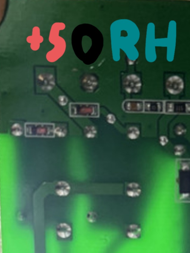

Hi @RandomGrinch ,
Mission complete.
Two nests installed, upstairs using the existing wiring to the old thermostat and downstairs is on a stand.
Thanks for all your help with this, I am really pleased with the outcome.

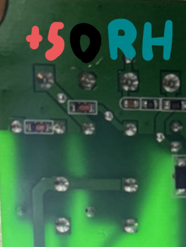

Below is a photo of the wiring system PCB as promised.
tantrum emoticons
Rich
Hi @RandomGrinch ,
Mission complete.
tantrum emoticons
Rich
Brilliant, well done! :)
...and thanks for the photo - only a quick look now, but the components on the bottom are mostly power supply related.
There isn't any protocol linked to the old thermostats, controlling the switching;
If it switches on when RH goes to 0V, that seems to be intended by design.
....I will have a proper look later to confirm, but it looks good for now! :)

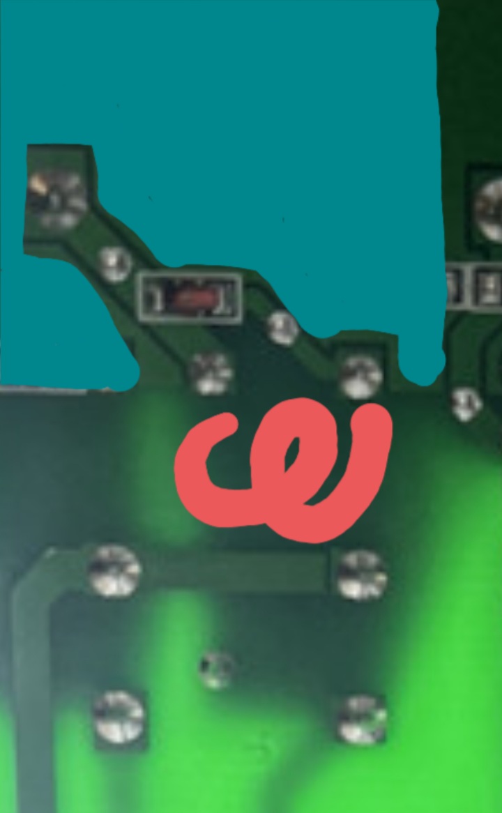

EDIT:
It's impossible to completely reverse engineer, as there are a few traces hidden under the thermostat connectors.
However, 0V turning on the relay can be (more or less :) ) confirmed:
The ground plane (0V - green), is completely separated from both contacts of the relay coil (red).
If RH switched the relay on 5V, there would be no reason to not have the ground plane connected to one of the coil contacts.
EDIT 2:
I was silly, noticed the flyback diode was facing the opposite way to what I expected - forgot to reverse the thermostat connections on the image :rolleyes:
5V is directly connected to the coil - the relay definitely switches when RH is 0V.
If you ever get any unreliable switching - you can try connecting:
+5V to 1 on Nest
RH to 2
And 0V to 3
No need to change anything if there aren't any problems though! :)

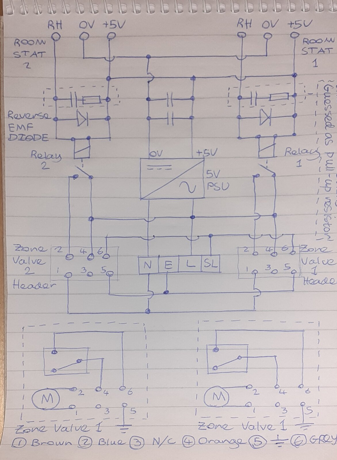

Just for fun, very simple really - it wouldn't be too complicated to remove the 2 valve PSU from the system entirely...
Some guesswork was involved - double check before modifying your own system! ;)

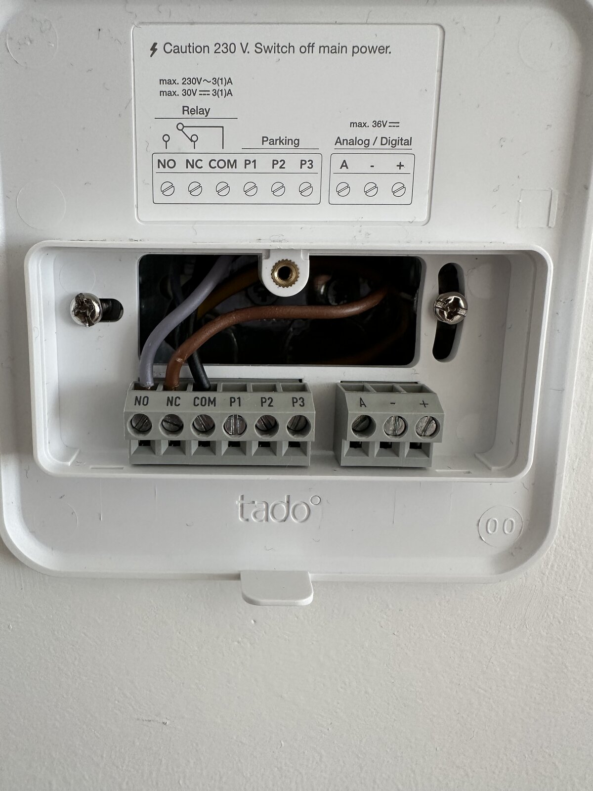

Hi @Chigurh - how has your system been performing with this new thermostat? Any random fires of the boiler?

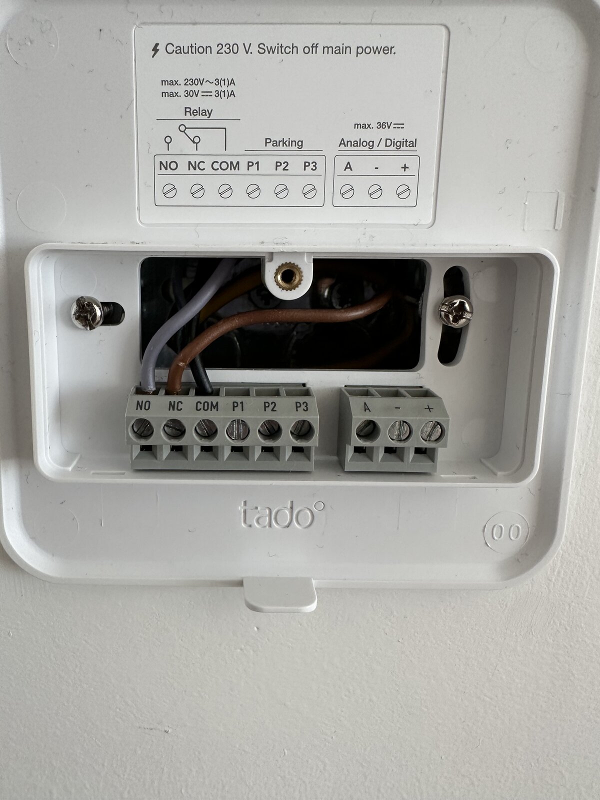

@RandomGrinch thank you very much for your extensive advice on this thread. I also mustered up the courage to swap out my ESI thermostats (same models and wiring centre as OP) for Tado thermostats. I’ve got:
Wiring Centre -> Thermostat
RH -> COM
0V -> NO
5v -> NC
Whilst the thermostats do successfully fire the system up, I do get random “calls for heating” on the boiler at times and I wonder if that’s because of additional circuitry in the ESI thermostat units (resistors or diodes?).
The system doesn’t fully power up but the fan does start and the heating symbol does show on the boiler screen.
I’ve currently put the old units on to see whether this was happening previously (newbuild, still getting used to everything)
