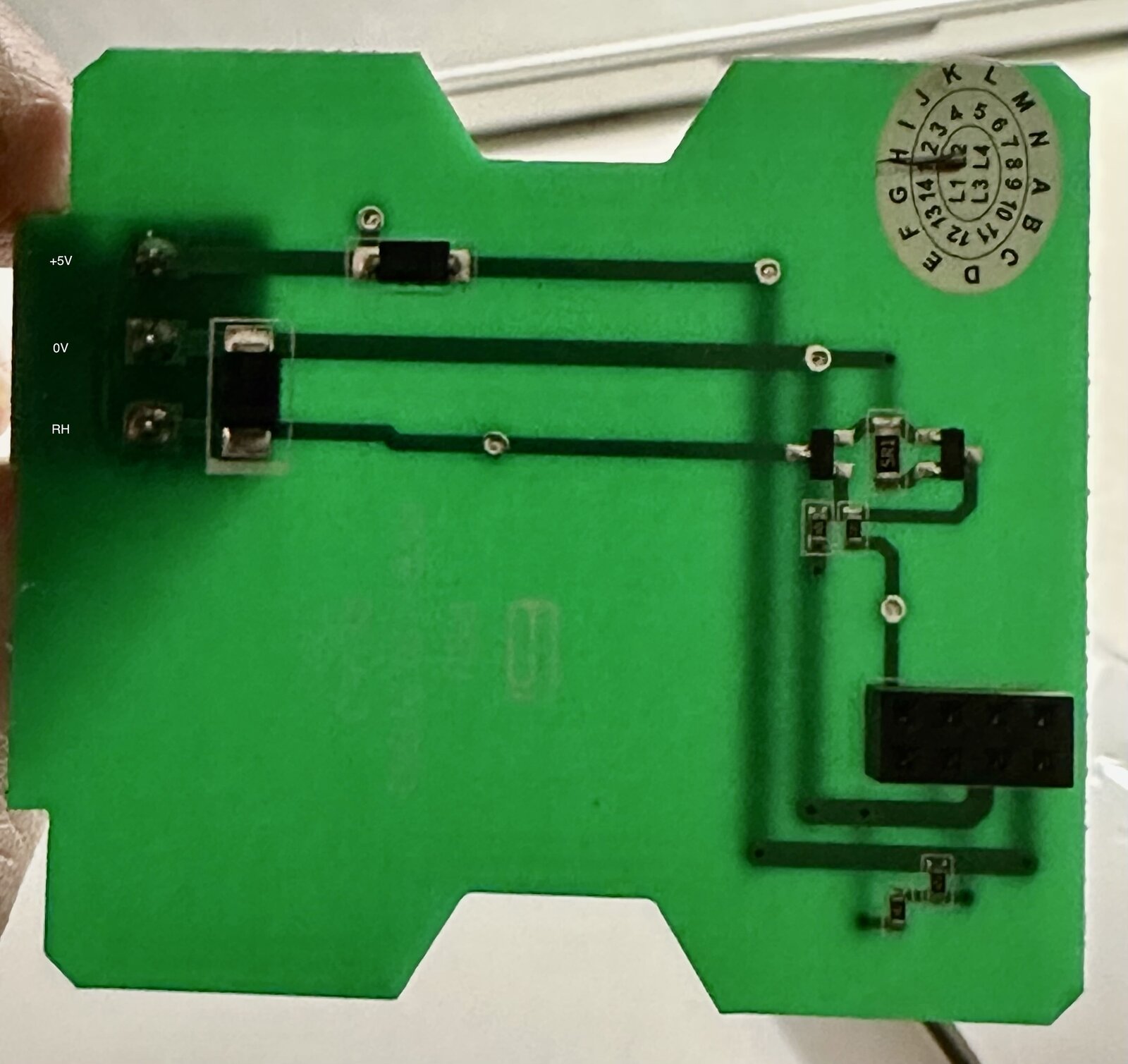

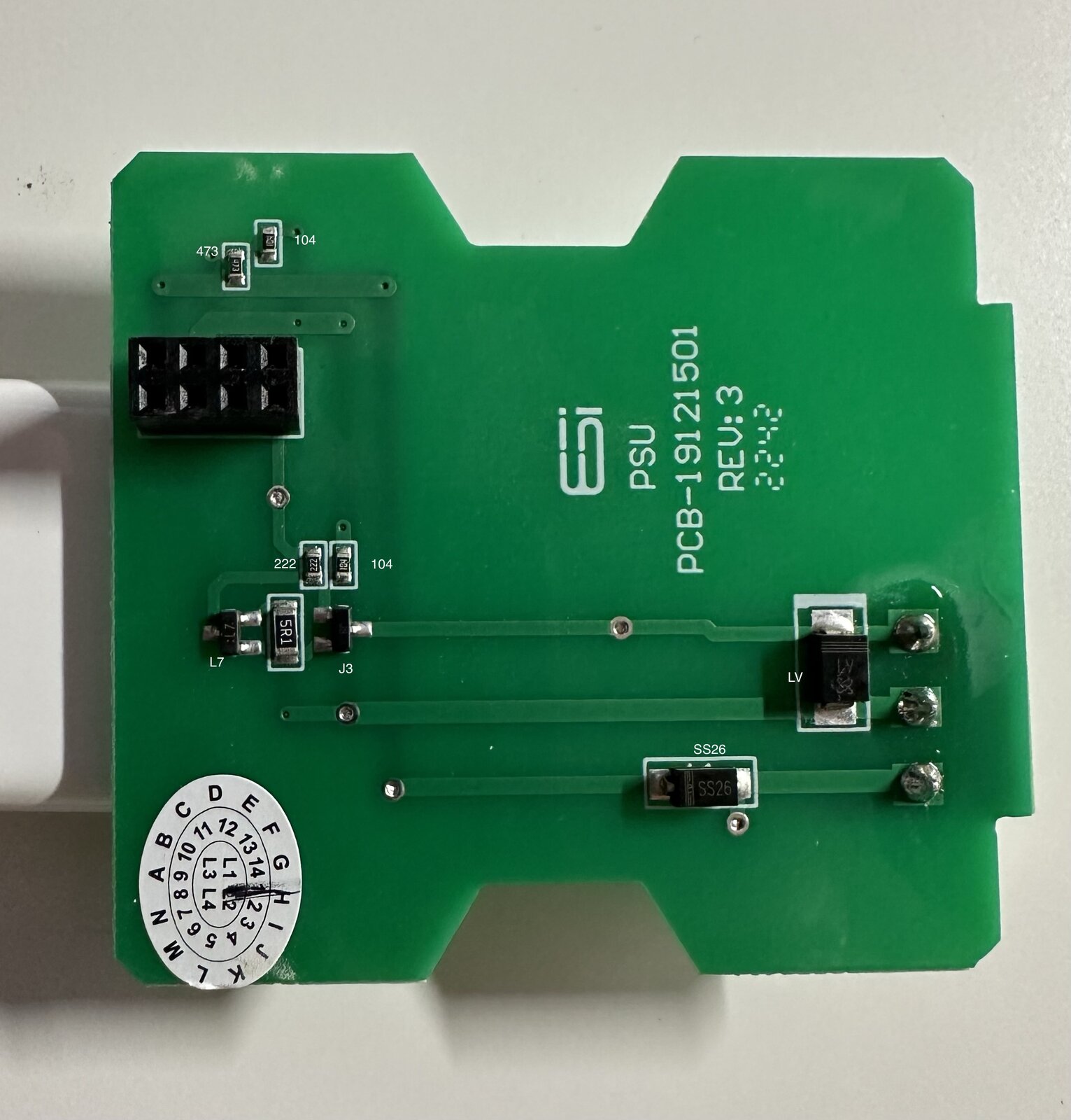

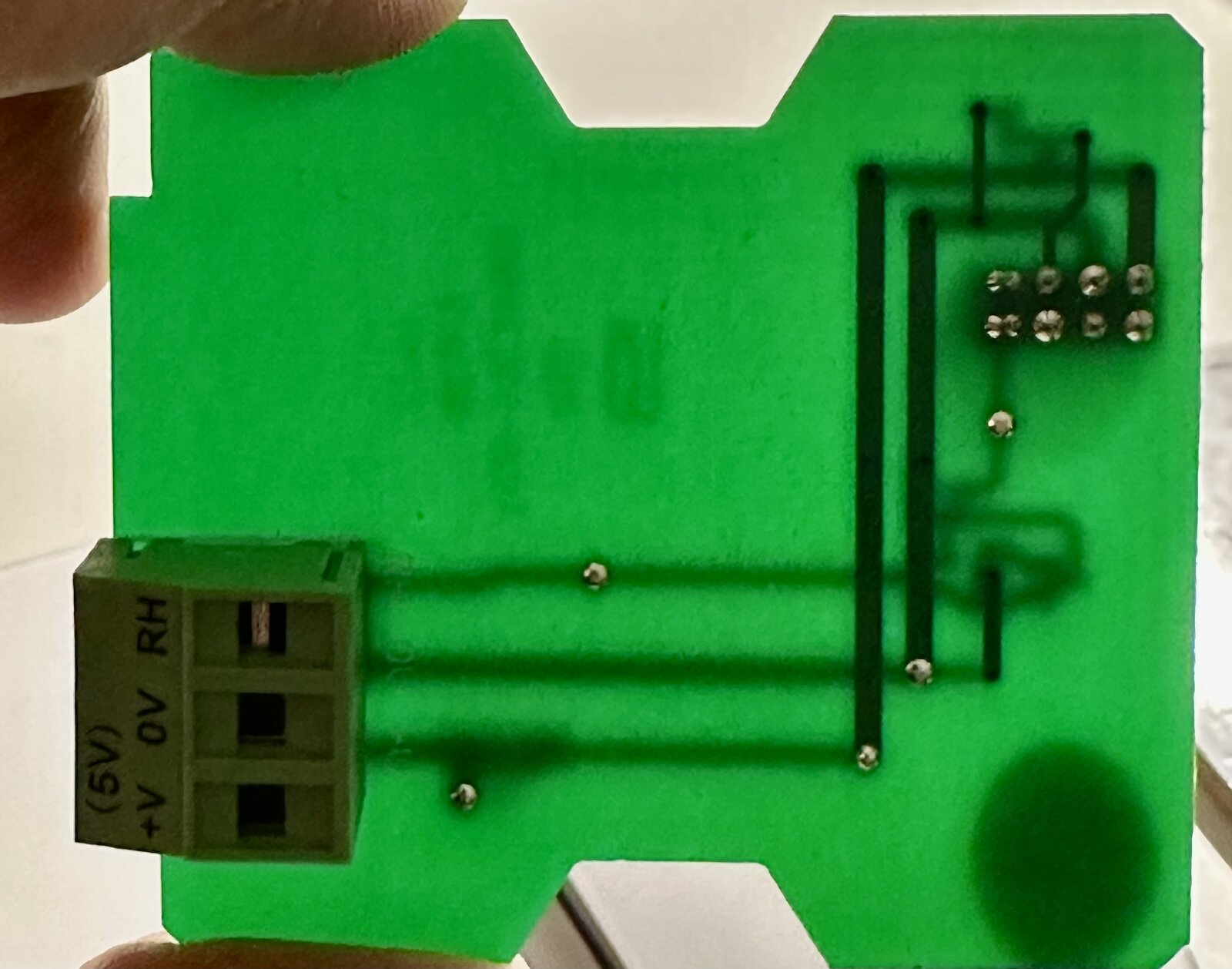

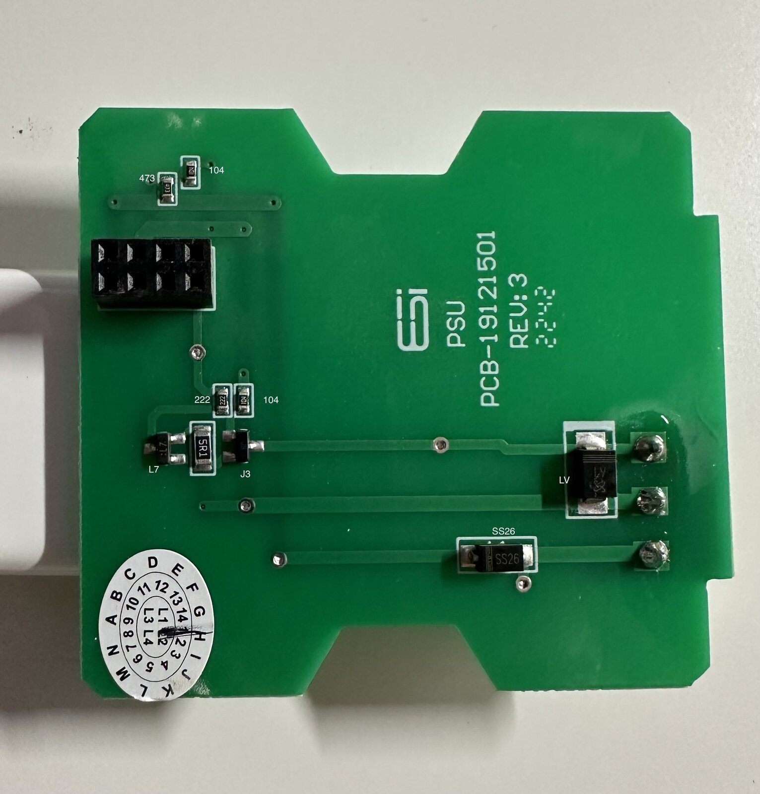

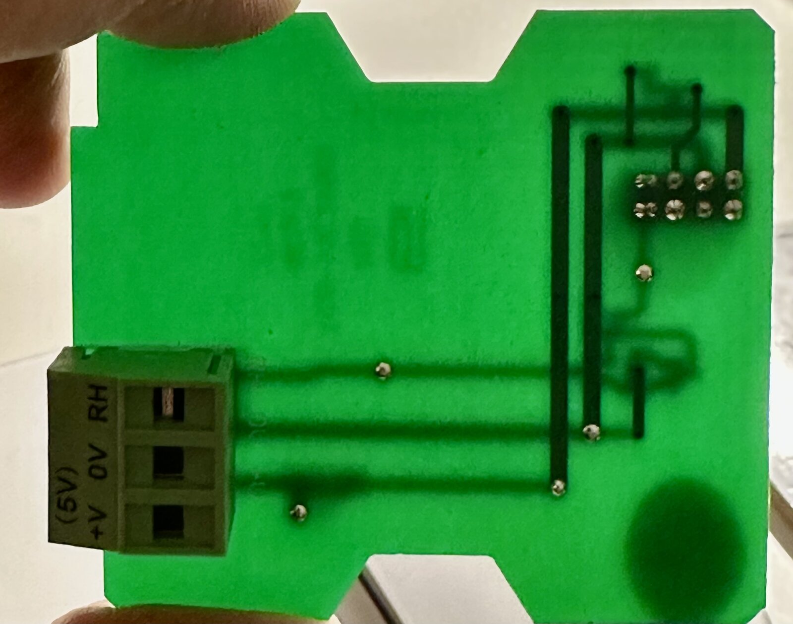

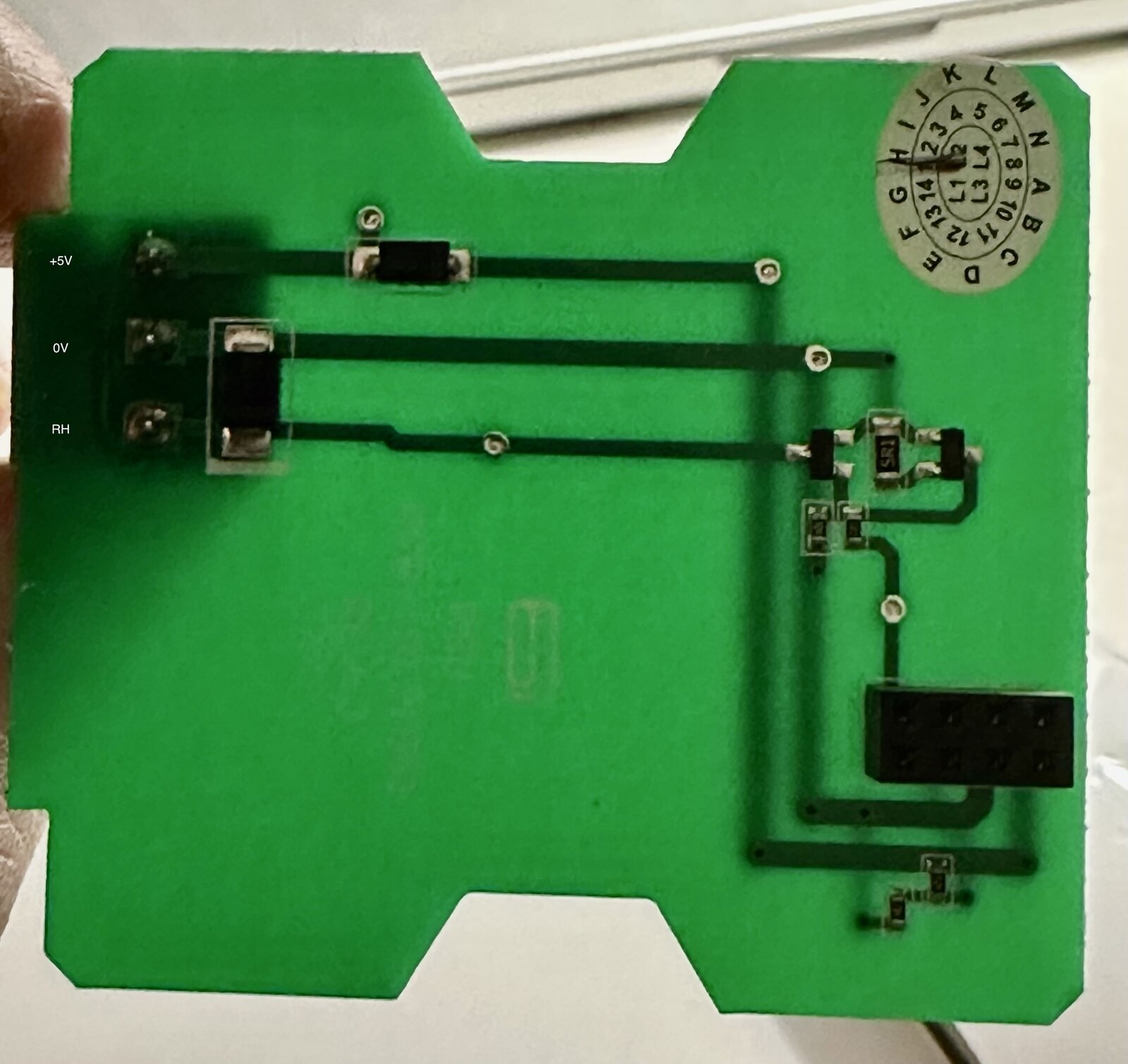

Before I did re-connect the ESI thermostats I decided to take apart the backplate PCB to examine its PCB closer (the thermostat plugs onto this base plate). There does seem to be a few components, I attached a few photos and labelled the components.
Agreed, there doesn't seem to be anything smart, just wondering if there's some passive components that stop RH floating.

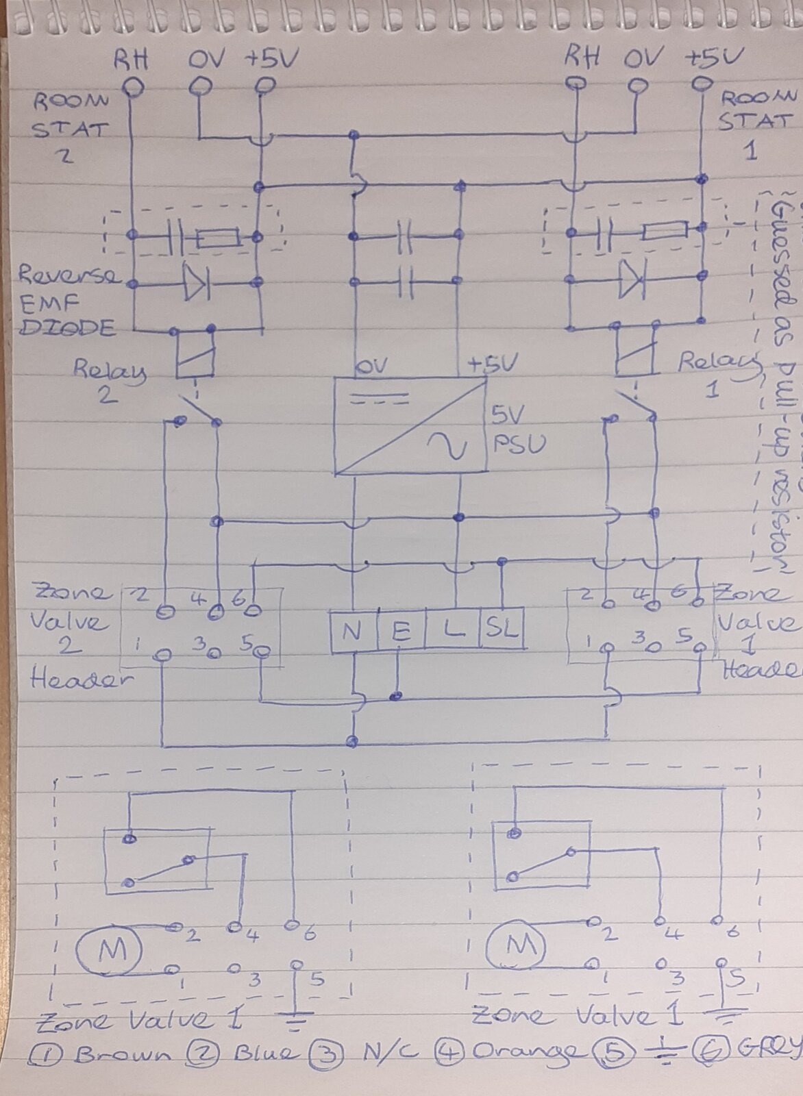

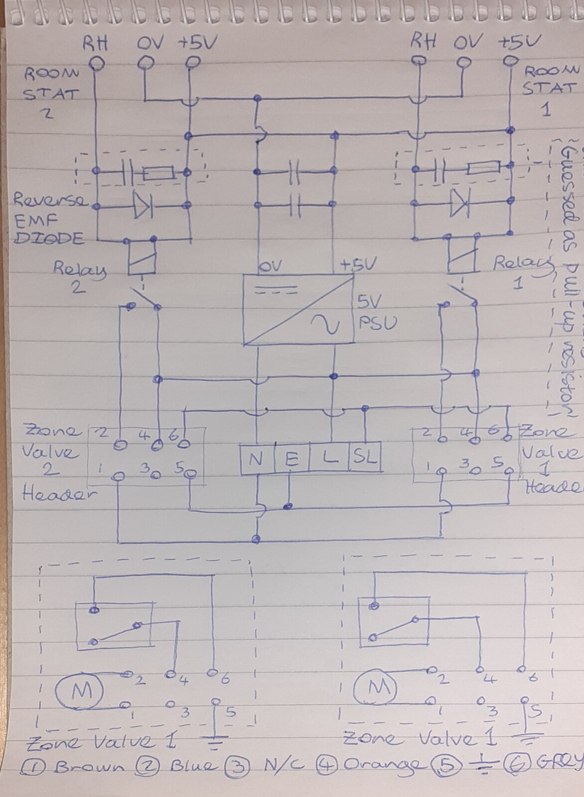

Having another quick look at the circuit diagram - post #12, the inputs to the controller go directly to a standard 5V DC coil relay.
On the PCB, there is a diode to protect against reverse EMF, but what I thought was a pull-up resistor, now looks like more reverse EMF protection. I.e. a pulse generated by the coil is then absorbed by the capacitor/resistor pairing.
So, no matter what pull-up resistors may be in the thermostat, all that we are dealing with on the controller, is a standard relay. Using a Nest ( or whatever) to connect 0V to RH should operate that relay.
Otherwise, you could consider rewiring the connectors on the zone valves for direct 230V operation.
Thanks for the PCB pic, I'm afraid I haven't looked into it properly yet.
The reason why I suggested the wiring to the Nest with RH on common, was to supply +5V to the relay when the heating was supposed to be off. RH would definitely not float, and with +5V on both sides of the coil, the relay should be off.
That's why it was a bit odd that you seemed to have problems.
As I said above, this is a standard relay - it isnt exactly a super sensitive electronic device! :)

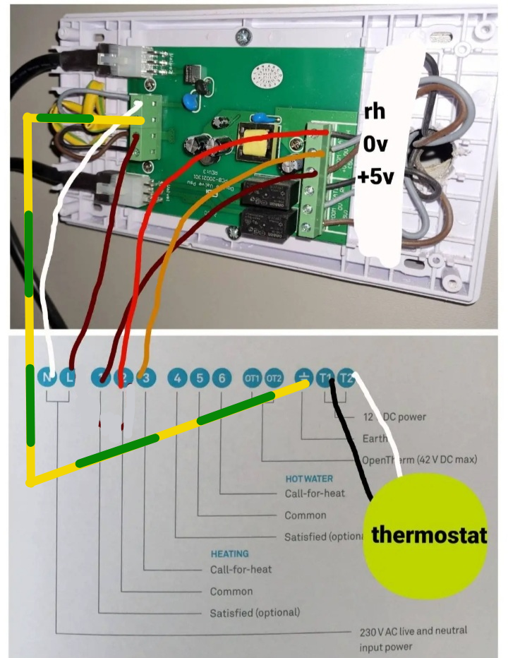

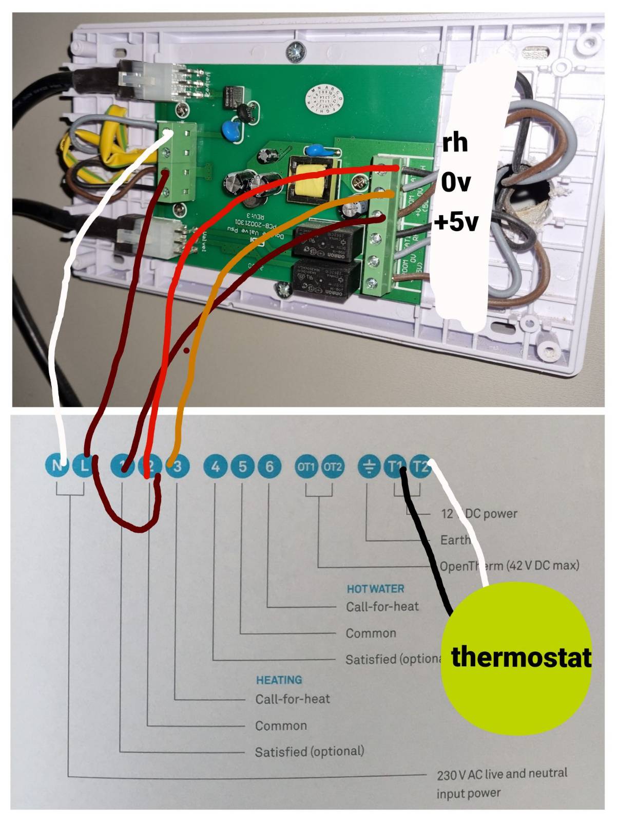

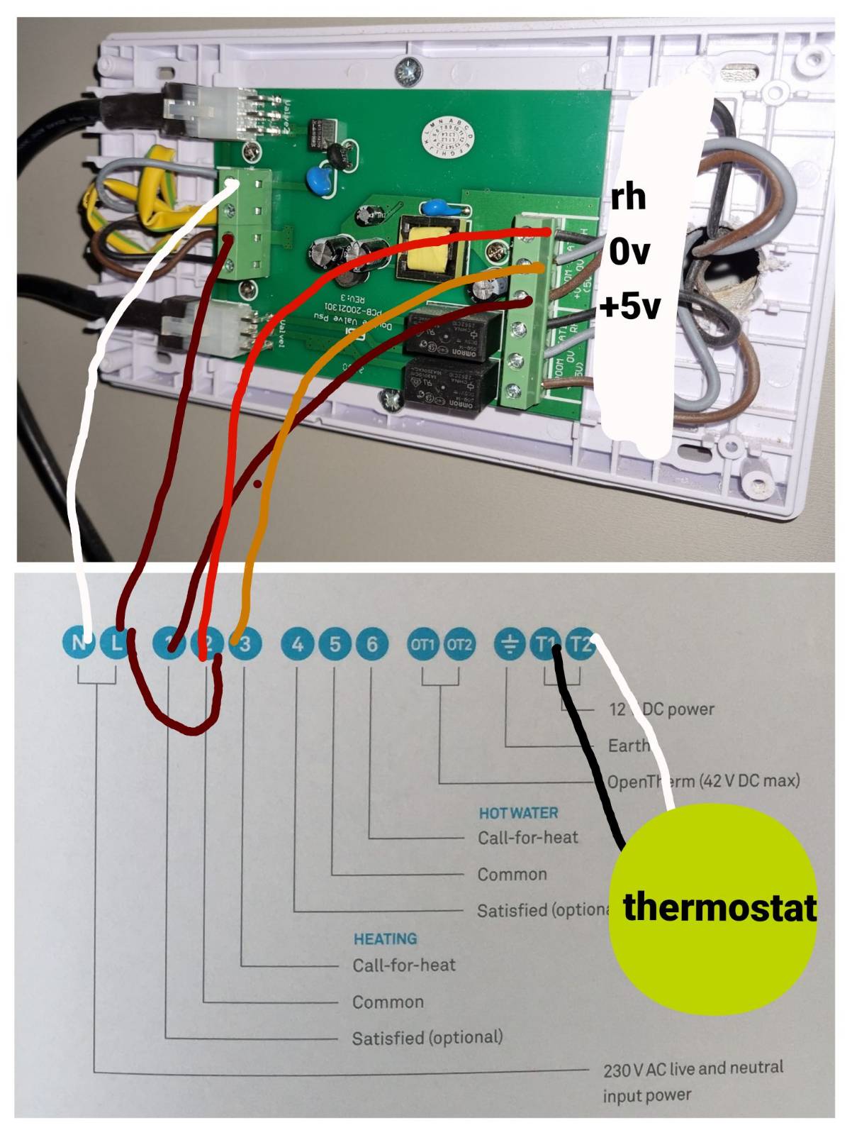

Hi all,
Very useful thread. I too have just moved in to a new build with one of these PCB board.
I think ive understood what @Chigurh did to get it working.
Just want to confirm that the end result was something like this.
Nearly, but not quite - with potentially damaging consequences to the PCB! :eek:
DO NOT add a link between Live and terminal 2 on the Heatlink - that would create a direct connection between live and the (extra) low voltage side of the ESI PCB - big bang likely!
Additionally, if you are using connectors T1 and T2 to power the Nest thermostat, the earth terminal on the Heatlink should also be connected.
If there are any problems, try removing the brown wire between +5V and terminal 1 on the Heatlink; this wire may not be strictly necessary.
Just for fun, very simple really - it wouldn't be too complicated to remove the 2 valve PSU from the system entirely...
Some guesswork was involved - double check before modifying your own system! ;)
Doh! Just realised, after all this time - the colours of pins 1 and 2, on the zone Valve connectors (in my schematic) are transposed :rolleyes:
Pin 1 would be the blue wire to the synchro motor, pin 2 would be the brown wire.
