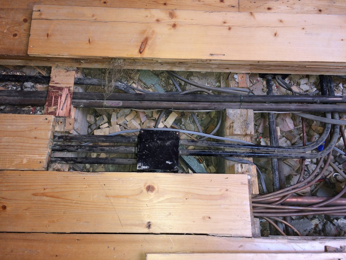

I have an old Victorian Edinburgh tenement flat. The floorboards in the hall and living room have been sanded and varnished, but are in a bad state after a rewire and re-plumb.
To make matters worse, in some places the joists have been notched such that it will be impossible to re-lay the flooboards.
So I'm thinking of replacing the floorboard with 2400x600x22mm MDF T&G floor panels. The current floorboards are 25mm thick, and 150mm wide in hall and 75mm wide in living room. I plan to pack the joists with 4mm stripwood so that the boards clear the old iron conduit belonging to the flat below (its a conversion ... and the conduit sits slightly higher than the joists).

Could we have a photo please? I personally would try to get 25mm ply with a 4mm channel cut out where the conduit sits, I don't like packing as it might allow movement/squeaks in the future, I also don't like MDF!

Good idea re. the 25mm plywood, plus the notching. I guess a router would be the best tool to take a few mm of the underside where the conduit it. Its really only the old conduit junction boxes that the the problem.

Have you removed the cover to the conduit J/B, or used a cable tester, and tested for live - i doubt it but is it possible that the conduit is carrying redundant cables?

The electrician did check all the old conduit wiring using an induction type tester (I things thats what its called ... I was so impressed I bought one myself). Its a conversion from a Victorian town house into lower and double-upper flats, so the lights for the flat below are underneath my floorboards. Not ideal, I know.
