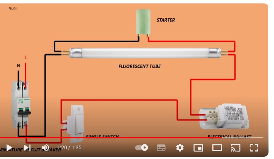

I have a fluorescent light in the kitchen that I want to convert into a standard candescent light. Looking at wiring diagram below, there is only a live and neutral cable that feed the fluorescent ballast and bulb.

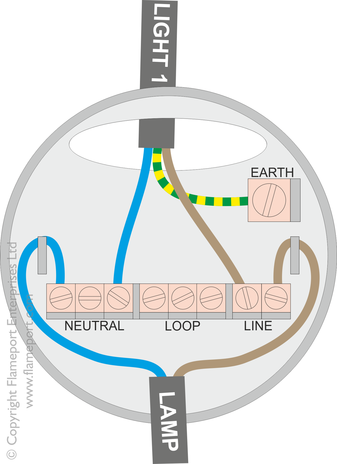

Can I disconnect the fluorescent fitting and wire up the new candescent bulb as shown in the photo, where there is no connection to the "loop" block in the celing rose?
So the live that went into the original ballast shown in the photo will go into the "line" block on the celing rose and the original neutral that went to the fluorescent bulb is going to be connected to the "neutral" block in the celing rose?
when i look at diagrams and videos for fitting a ceiling rose, there is always a connection to loop in and if there is another light after the one in question, there is a loop out so i wasn't sure if i could just skip this "loop" block connection as videos which show how to connect a fluorescent light don't have a "loop" connection and there is only one power cable with live and neutral on it.
most of the diagrams and videos that i see for flourescent lighting don't have an earth cable, just neutral and live. I haven't yet dismantled my light so if it is as shown in the diagram, and there is no earth cable, is it safe to connect the ceiling rose without the earth connection?
are all fluorescent light wiring without an earth cable as most of the videos have no earth shown?
the diagrams may not show the earth, but since fluoro fittings are usually metal, they certainly do need an earth - there's usually somewhere to connect it (to the metal of the fitting) somewhere near the point of cable entry.

Your florescent hopefully does/did have an earth connect, it is a requirement. A straightforward lamp holder and incandescent lamp, will not need an earth, so just ignore the earth terminal.
Your diagram for the florescent, is just to explain the operation of such a fitting, it ignores the need for an earth.
