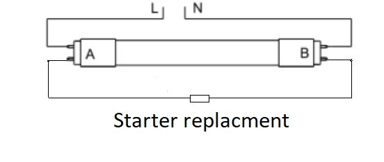

Does this mean the tube can function as fluorescent or LED, determined by the “batten” it goes in to?
Just to see what would happen, I tried it with no starter and it didn’t light. I tried it with the old starter and it didn’t work properly, can’t remember whether it flickered.
With the supplied starter it works fine, lights instantly without the traditional initial flickering.
Interested in any comments.

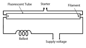

1A refers to your fitting type , your fitting has live at one end pin , albeit via the existing choke [ballast ] and Neutral opposite end pin , the old starter bridged the other pins end to end.
The modern led needs L and N at the same end, that dummy starter they supply is just a bridge from one end to the other to do that.
The design of that particular led in this case allows to be fitted either way round.
Either way round there will always be L and E at one end or the other.
1B refers to a led fitting that is already made with L and N at one end only and was sold as led only, never fluorescent, in this case simply bin the old LED tube and fit the new one, hence it needs fitting the right way round, wrong way round and you possibly short L and N together.
These units generally have a sticker at one end and a warning Led only.
As you later ask you can simply bypass the choke by simply cutting and jointing its 2 wires, however in your case unless you also divert the N wire from one end to the other, then your led lamp would still need the dummy starter to work.
