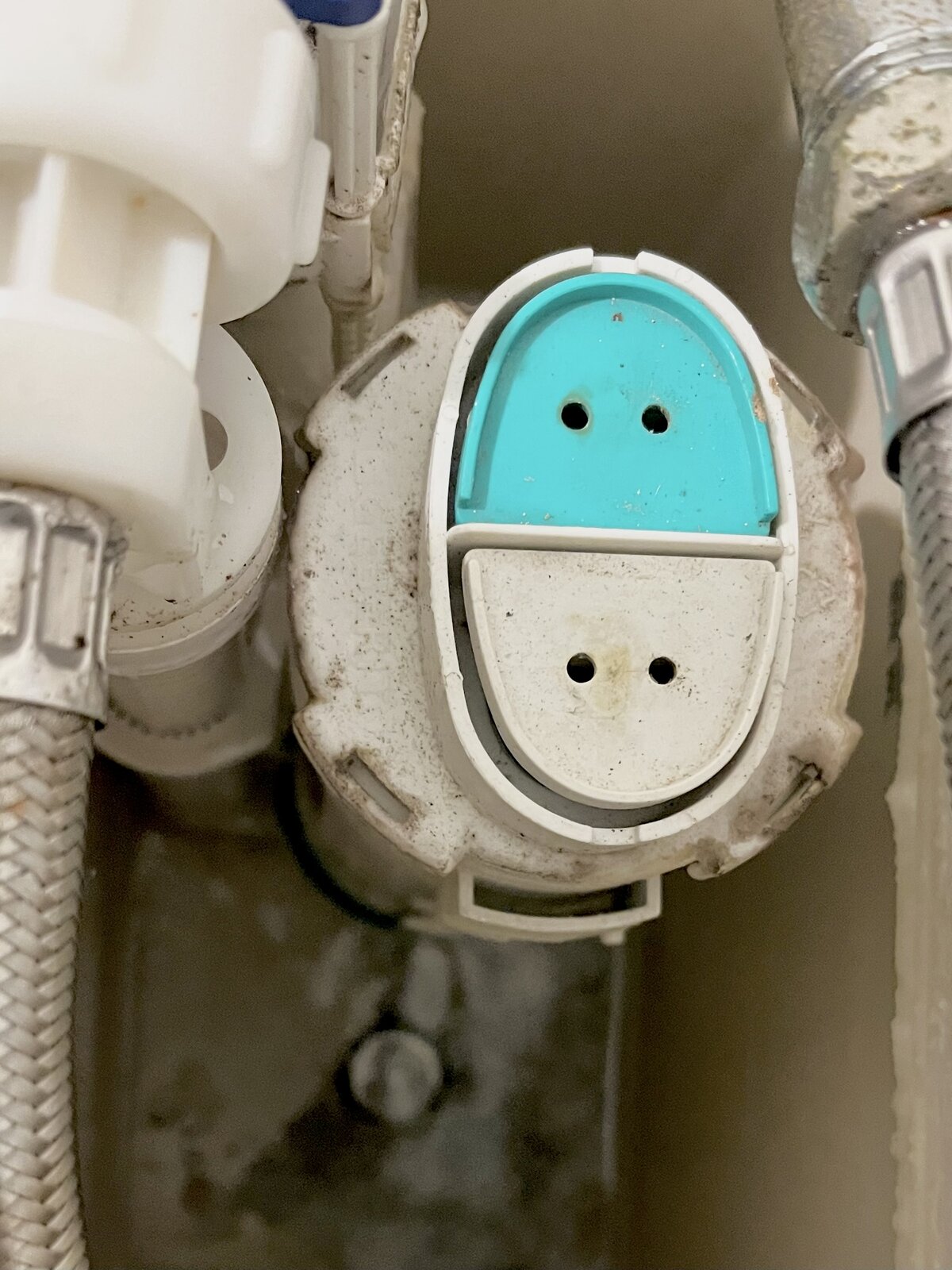

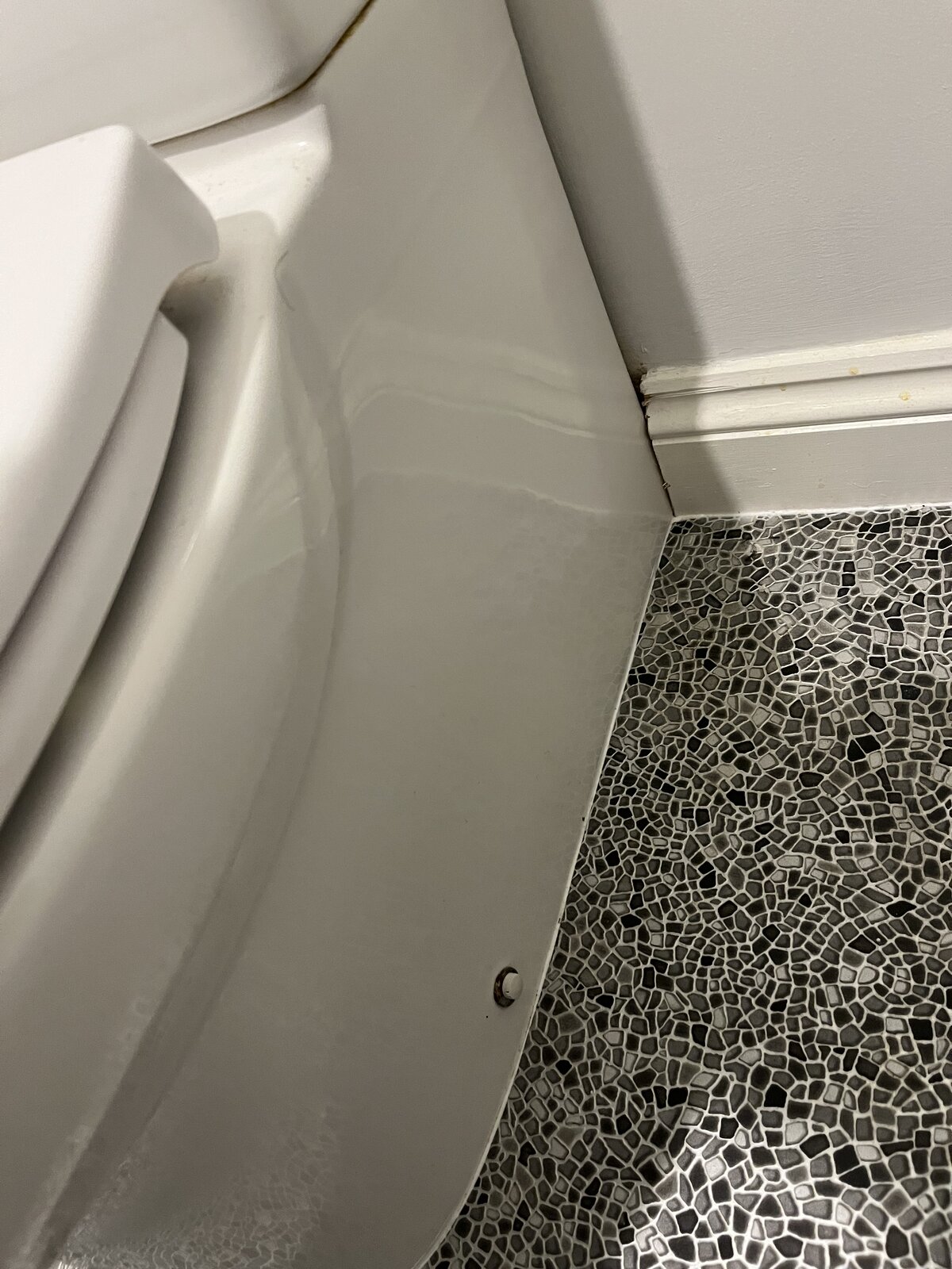

Hello.
I need to replace a flush.
Presumably the whole loo needs to come out ?...see two photos.
Regards
Phil
Yes, unless the body of the flush unscrews for maintaince/replacement.
Well worth trying 1/8th of a turn anticlockwise to release from bottom cradle.
Saves the hassle of getting joints leak-free on reassembly. (the seal between pan and cistern especially)
