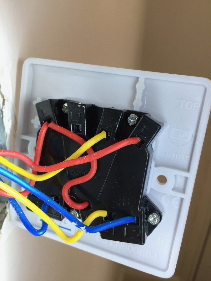

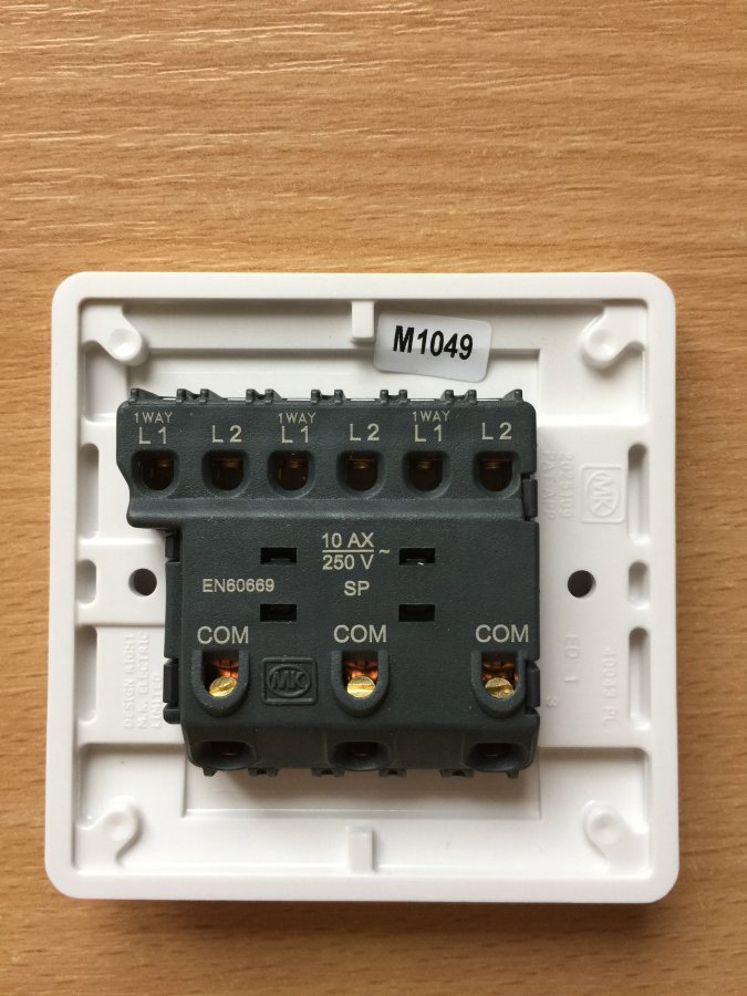

I would like to change the hallway switch in our house, but when taking the cover off the connections on the old one compared to the new one are different. Typically it's the last one in the house that I'm trying to change.
The new light switch attached below, doesn't have the same connector markings, can anyone point me in the right direction as to which wire from the old switch (IMG_2801) should go to the new switch (IMG_2802) please?
The old switch has the middle switch 'upside down'.
On the top row, L1 L2 and on the bottom row L correspond to L1 L2 and COM on the middle switch.
