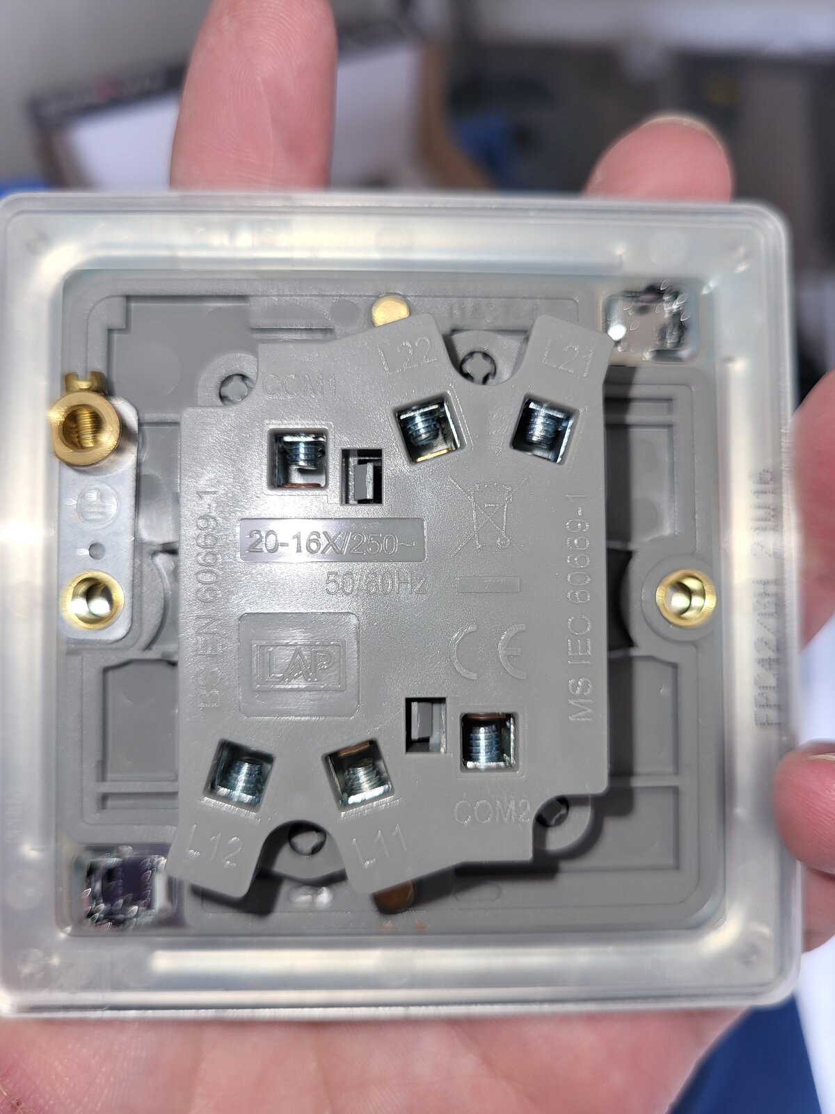

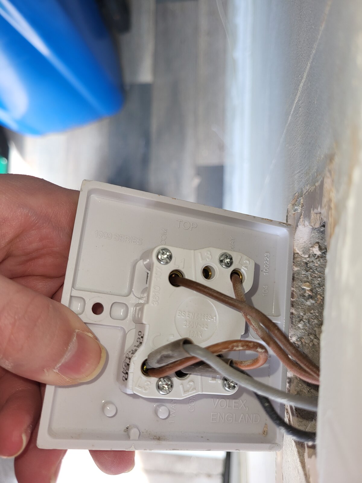

Hello I bought new chrome sockets and switches to change in my council flat and am having trouble changing the two two way switches I have. One is near the front door and switches the outside light and the hallway light and the other switches the bathroom light and hallway light but they are labelled up different on the new and the old switch I thought I may have got the wrong one in error any help would be greatly appreciated

Ignore how they are labelled.
The switches are both the same - two triangles.
Just transfer the wires.
The new switches will require earthing by connecting to the earth wires in the cables.

Are the original switches still attached?
or
Ha e you got a photo of the old connections?

To the person that asked for a photo of the original connections its posted with the question and to the other person that asked about reinstating. I can install new fixtures and fittings with the councils permission. If I ever moved out id just swap them back. Also to the person that said just put the wires in the same place are you sure? What about the common wire? Also I knew ypu had to ground the faceplate with a flylead connected to the earth on the backbox. All of the switches are earthed in the backbox I bought some cable to create some fly leads I read that its good practice to earth the switch as well as the backbox
Yes totally. All the terminals are exactly the same and in exactly the same places, the fact the lables are different is completely irrelevant in this case, it's just the way manufacturers have chosen different ways to describe them.
