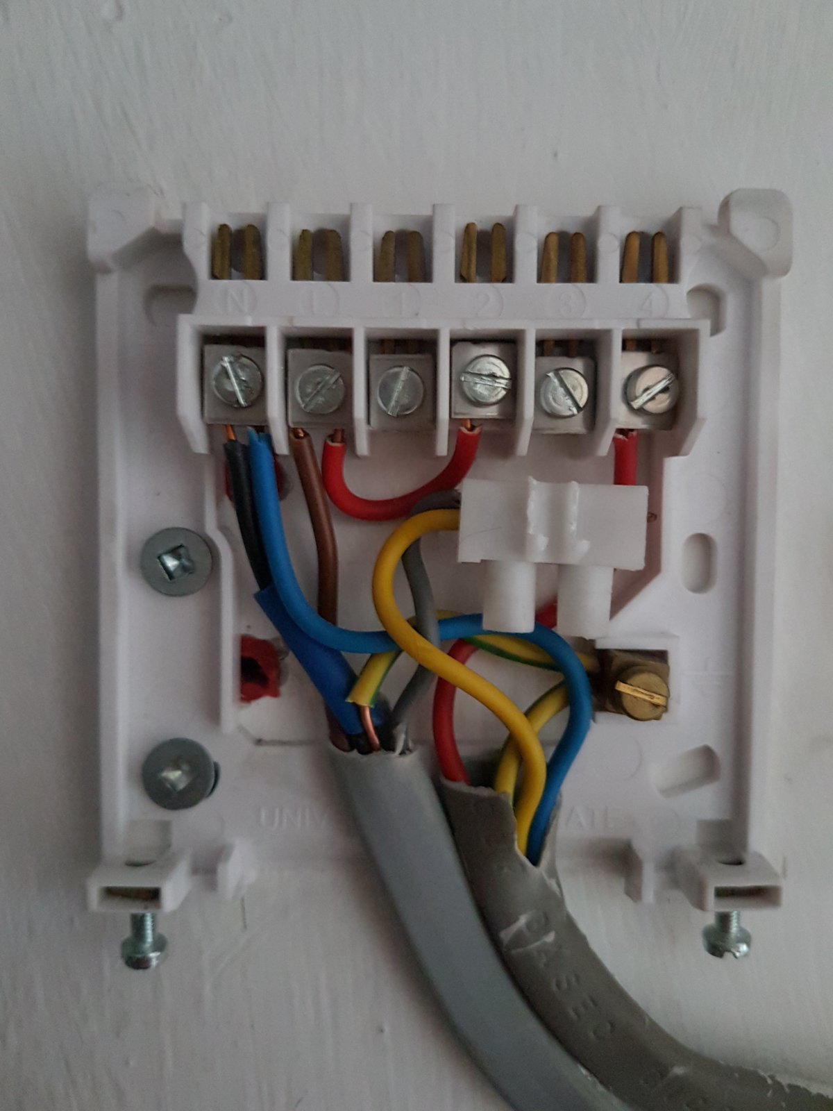

I bought a HIVE installation kit, and have spent several hours today trying to work out how the wiring should go within the receiver. The closest I found was here:
https://www.diynot.com/diy/threads/horstmann-to-hive-wiring-check-please.476261/
but it's not completely the same.
I have a room thermostat, the wiring within my current timer looks identical to the one in the post, which is for a gravity fed, part pumped system. I have a combi boiler in the loft (which is difficult for me to get to).
It looks like the wiring from the thermostat Sunvic TLM2253 goes directly to the current timer (would this be right ?), if this is the case, it will be easy for me to just remove it, as I can see all of the cable.
The current wiring within the timer is attached, and from what I can tell, the only cable going into 4 is from the thermostat. If the thermostat was removed completely, which cable should go in there instead ?
Do any adjustments need to be made in the boiler once the thermostat is removed ?. It's a Greenstar 24/28i junior.

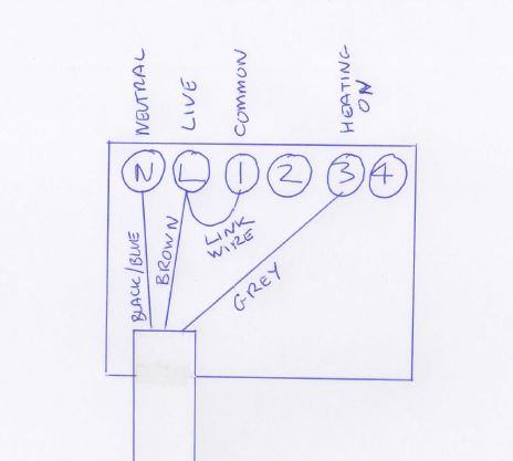

You are fortunate, yours is one of the easiest to change, all of the wiring is in one place.
The C17 is wired as below:
The Hive [You need the single channel version for a combi] has the connections below.
So the N (Black with blue sleeve) and L (Brown) move across easily from the C17 to the Hive, like for like
Then you need to link the Hive terminals Live (L) and Common (1)
Now you need to disconnect the existing room thermostat cable completely, which is the right hand cable red, yellow, blue.
The grey wire (currently in the screw connector with the yellow) connects to the Hive terminal (3) Heating on
Edit: Sketch added.

OK i'm a fool. I bought the dual system after reading that it would work the same, but would be more future proof should I want to move property and take it with me. I'm assuming I need to use 4 instead of 3, but what about Common ?. There is no common with mine ?
You can fit the dual version and not use the hot water settings, If you can swap it for a single channel version of the Hive, personally, I would.
However, if you want to use the dual channel version, you can. N and L are straight forward as before, and the grey wire goes to terminal 4, 'heating on'
No link is required, the dual version makes the link internally.
