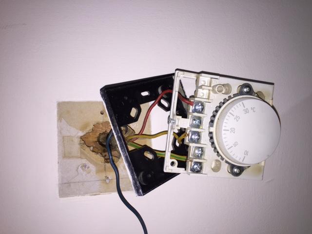

This is the existing thermostat which is in the living room wired as it has been.

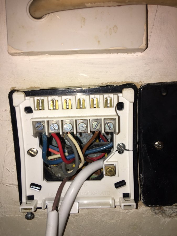

This seems to be the other end where the programmer is (the white cable with the blue wire with yellow tape around it)

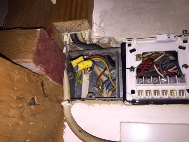

The Yellow cable from the Thermostat goes into a choc box which you can see in this picture connected to a white cable
That white cable goes off into a honeywell valve.
The red cable coming from the thermostat goes into the existing C27 programmer in number 4 on the white box

The red cable from terminal 4 of the programmer will no longer be required and should be removed from the programmer and made safe (unless for some reason you want the programmer to still have some control over the heating which the following does not allow for).
The Nest Heatlink will need the usual Live and Neutral, from the same supply as the programmer etc, for it's power.
A short wire Link is required from the Heatlink Live terminal to terminal 2.
The yellow wire that was connected to the old room thermostat should be removed from the block and instead a wire from this connector should go to the Heatlink terminal 3. This becomes the new feed to that white wire which powers up the motorised valve when heating is ON.

Just done that and its all up and running - Thank you so much - Saved me alot of money there getting it installed.
Reused the old Thermostat cable into T-1 and T-2 to power the Nest Thermostat.

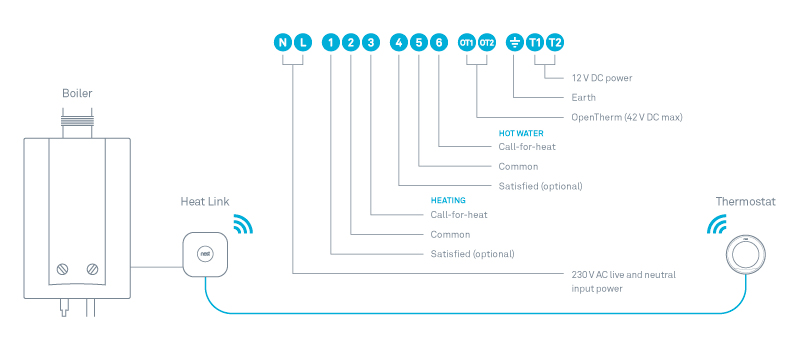

So here is the wiring layout for the new nest with hot water controls

1 in the c27 will go into heatlink 4
3 in c27 will go into heatlink 6
Then you need a short wire link from Live to 5 in heatlink
Great thanks sounds easy enough - currently there are 2 cables in 1 (the grey and white ones) - i assume i can put these 2 into a choc block and a wire from there to number 4 i the heat link?
Thanks for your help again!
If those two wires will reach and fit together into number 4 that's preferable. If not a choc block would be OK.
