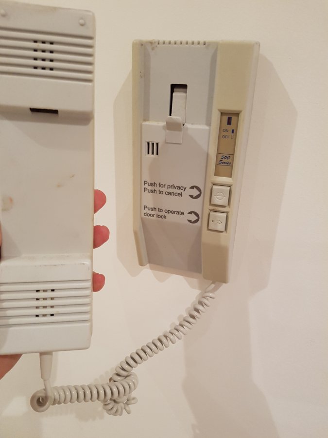

Hi All,
I am new to this site and I thought you might be able to help me.
We have two really, really old entry phones in our flat (block of 70+ flats).

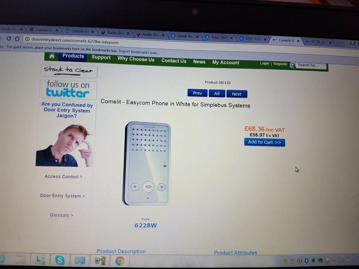

It is called 500 series. We would like to replace it with an comelit easycom phone or something similar to that.
Could you tell me how to find out if this is possible? I read somewhere that if you do it wrong you could screw up the intercom systems for everyone.
Really would appreciate your help.

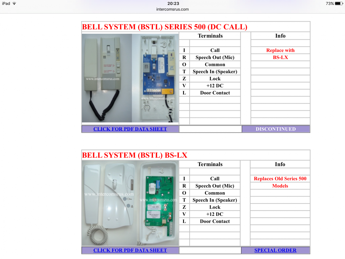

People think you can swop any handset for any brand.... This is not the case ....allways fit the replacement model or it may cause issues with speech quality or total failure . This handset is DC call , most handsets are AC Call ....

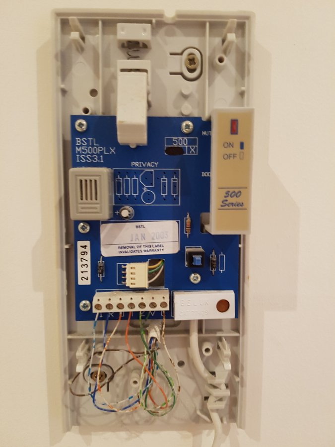

A picture of the internals of the handset would be better as I think that handset was also available as a 2 wire version
What's the exact model of the existing handset? Bell made several models in the 500 series all with identical or near-identical outward appearance. A clear photo of the inside would be useful.

Here the inside of the phone.

I just want to understand what I can have or not. So I need to look for DC and I presume it's not the two wire system as I can see 6 cables there.

Other manufacturers' handsets may not be compatible with the system and may damage it. Your intercom contractor will advise what you can have and take responsibility for it. Microphone voltage and impedance rating is not standard, speaker impedance is not standard, buzzer call voltage may be AC, DC, or audio tone, privacy switching especially can be non-standard. The handsfree type you showed usually requires a power supply and the sort of system you have often does not provide both wires of a constant power supply for flats use.
As for replacing the system, if your existing system uses 4+n wiring then that is fairly standard and could be replaced with another 4+n system, or there are 2-wire bus systems which would use two of the existing wires allowing some spares in case there are breakages etc.
