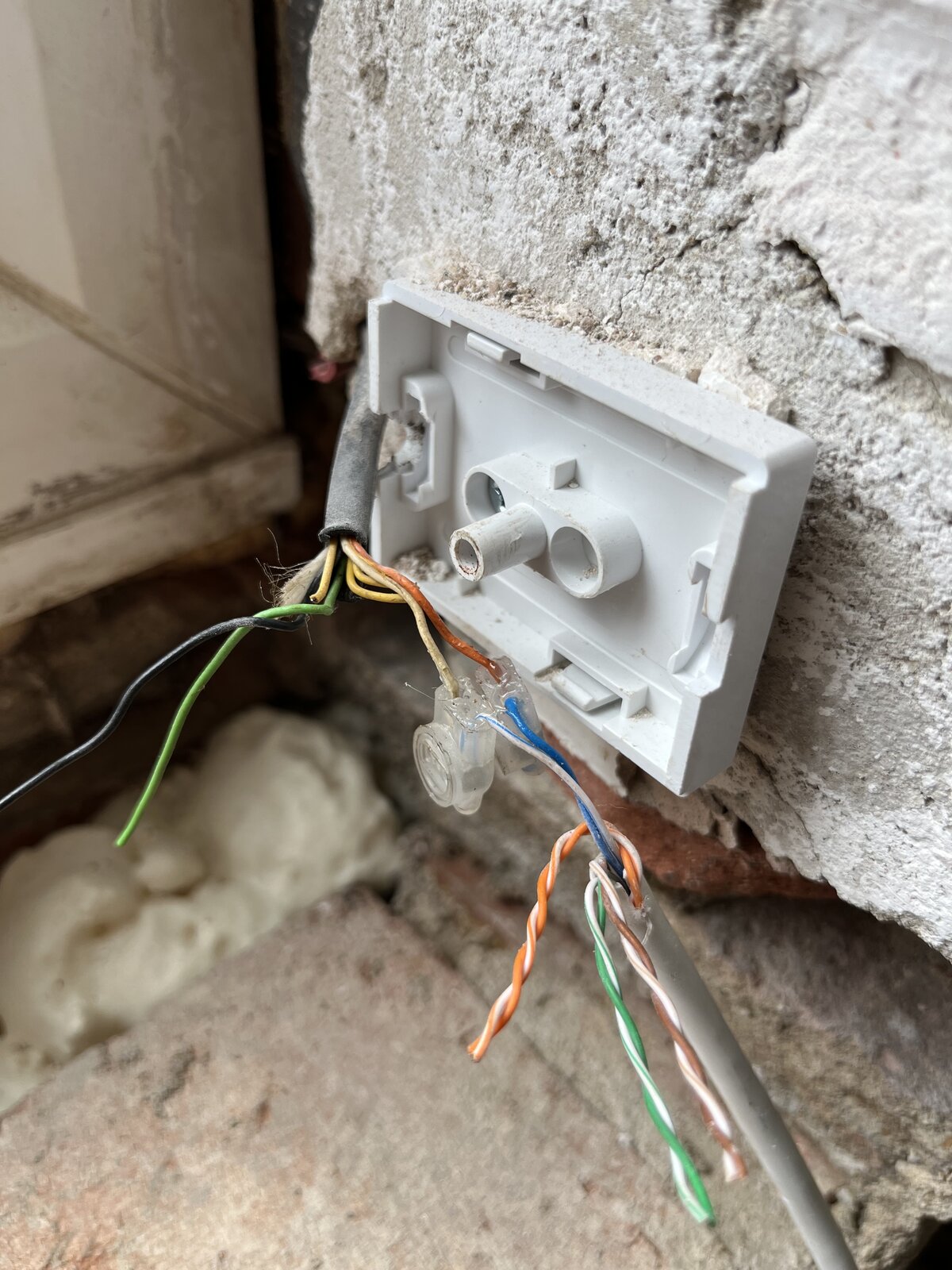

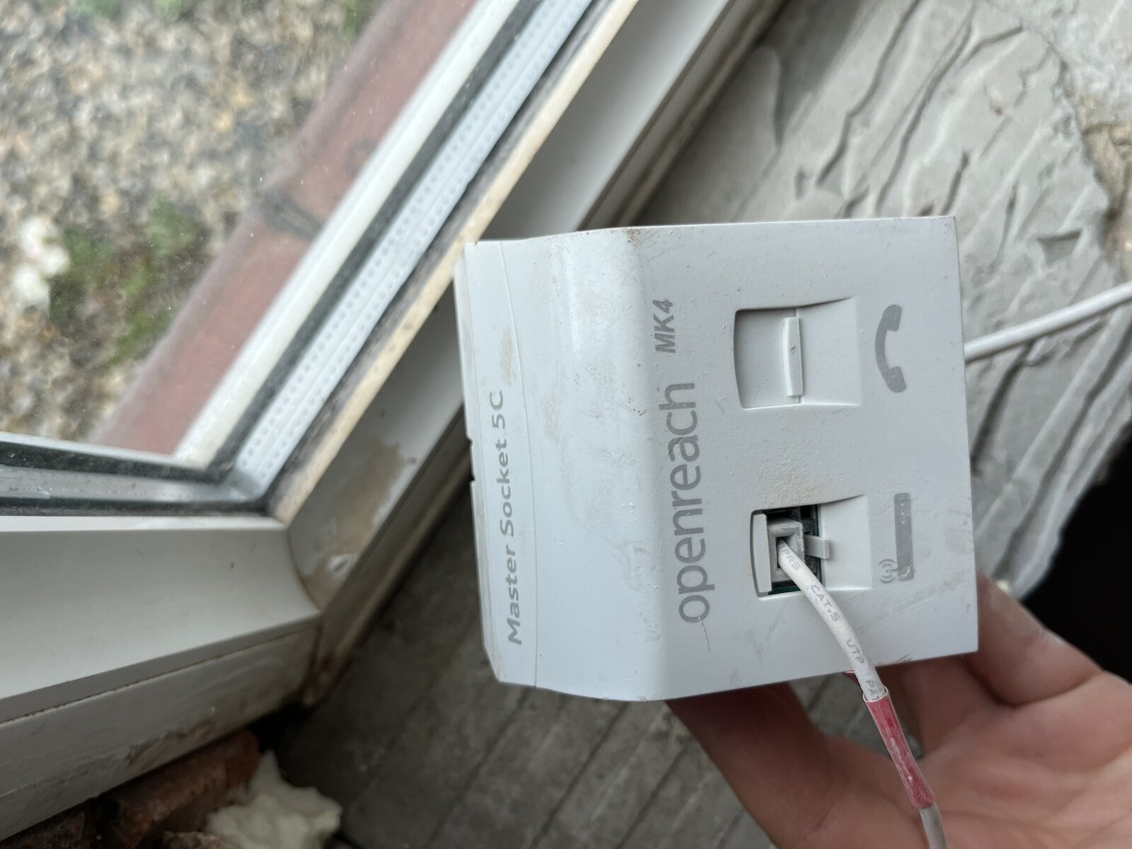

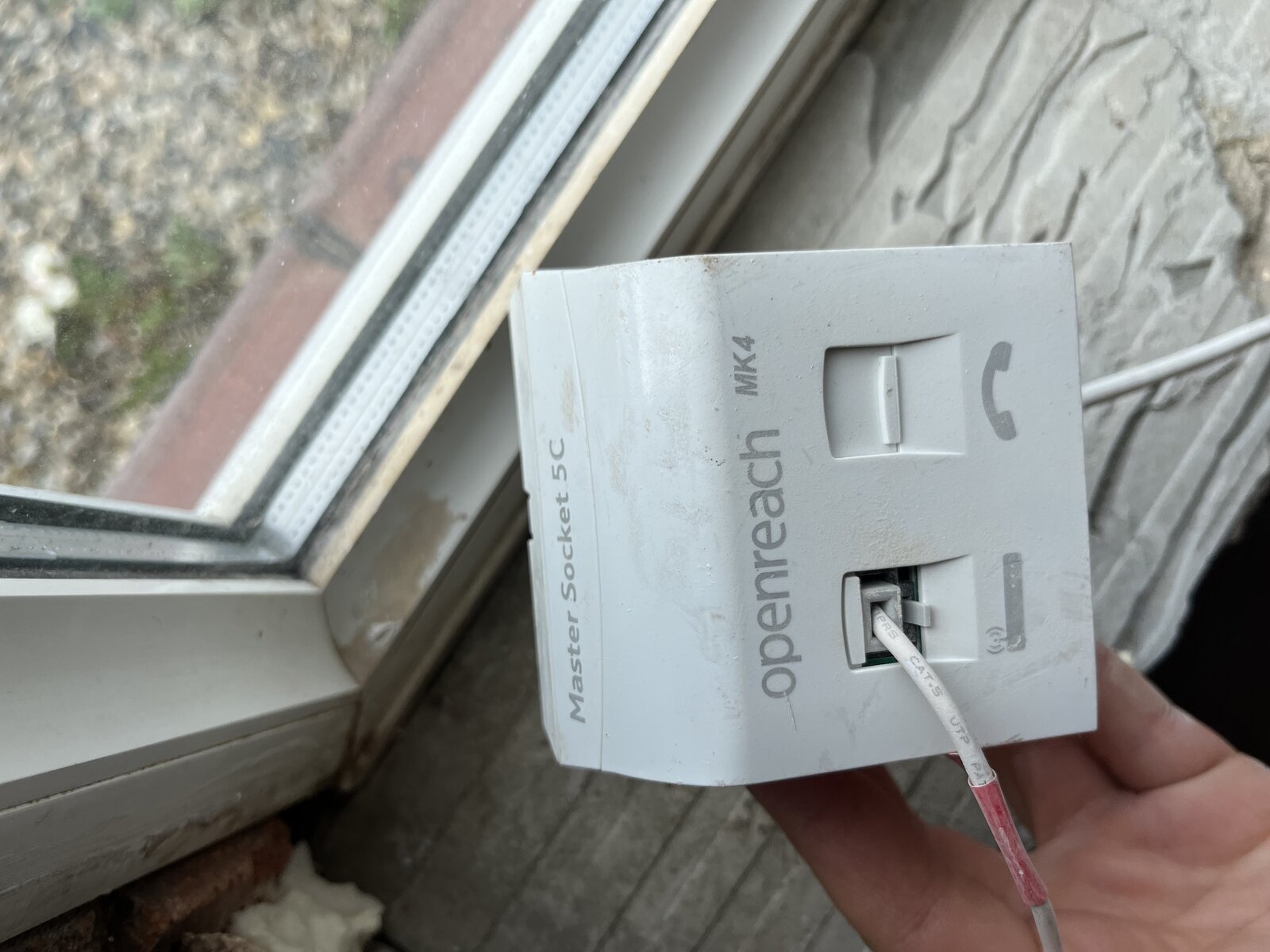

My phone line comes into my house in the lounge window cill. This isn't ideal and is ugly. When I moved in and had the wifi installed the fitter told me I could move it by installing a new cable from the point it connects to the outside of my house and run a new cable to wherever I needed. I was going to run the cable further along the house, in through the floor of the first floor and drop down to the other side of the room.
The problem is I can't remember what the cable was he said I needed?
Will I need to install a master socket still and what the cleanest way of doing this? I see you can buy an internet and aerial socket which would be good if it works.
From what I understand I also can't use a conventional phone, Its now a wifi phone apparently if this makes any difference but I don't intend on having a landline anyway.
Thank you.

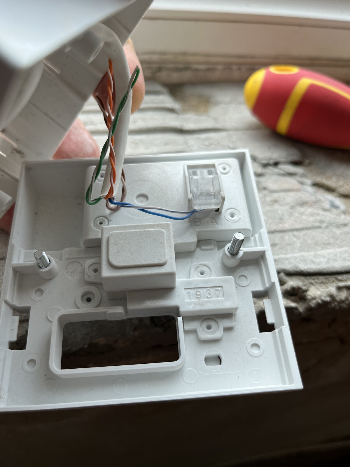

Doing a bit more digging it seems that only 2 cables are actually connected, presumably this is all I need for the internet and the others were for a landline?

Two wires is all that's required for phone AND internet
and strictly speaking you are not supposed to alter the wiring connected to the exchange side of the master socket.........
Strictly speaking you're right but I'm sure it won't be an issue in reality.

I am now after a way of improving the bulkiness of the master socket or swapping it for something else. I don't want it protruding as much as it does so after something I can fit in the wall and sit flush like a plug socket.

Oh yes - the cable it should be BT 2302 cable but CAT5 cable is perfectly acceptable - use the Blue-White/White-Blue pair as that is convention.

Use BT spec CW1308 https://www.tlc-direct.co.uk/Products/CACW1308slash4slash1.html
Using Cat 5 or Cat 6 for the feed to the master socket can degrade the ADSL ( broad band ) signal. This degredation is due to the impedance of Cat X cable being different to the impedance of the CW 1308 It doesn't always affect the signal but in some circumstances the reduce in down load speed is noticable.

DECT is the protocol used by cordless house phones. It has nothing to do with your internet connectivity. The gel filled connectors are for exterior connections, they are not required indoors. And to use the crimps, you need the special alligator crimping tool.
VOIP (Voice Over Internet Protocol) just means that phone calls are internet based rather than going through the old skool network, downside, if you have a power cut, your landline will not work.

The two are entirely separate, no connection between them. DECT is the wireless system used by your phones, to communicate in your home. VoIP is voice over IP - basically the calls are routed over the Internet connection, bypassing your local telephone exchange and most of the telephone system - instead, your call is handled by a distant VoIP server.

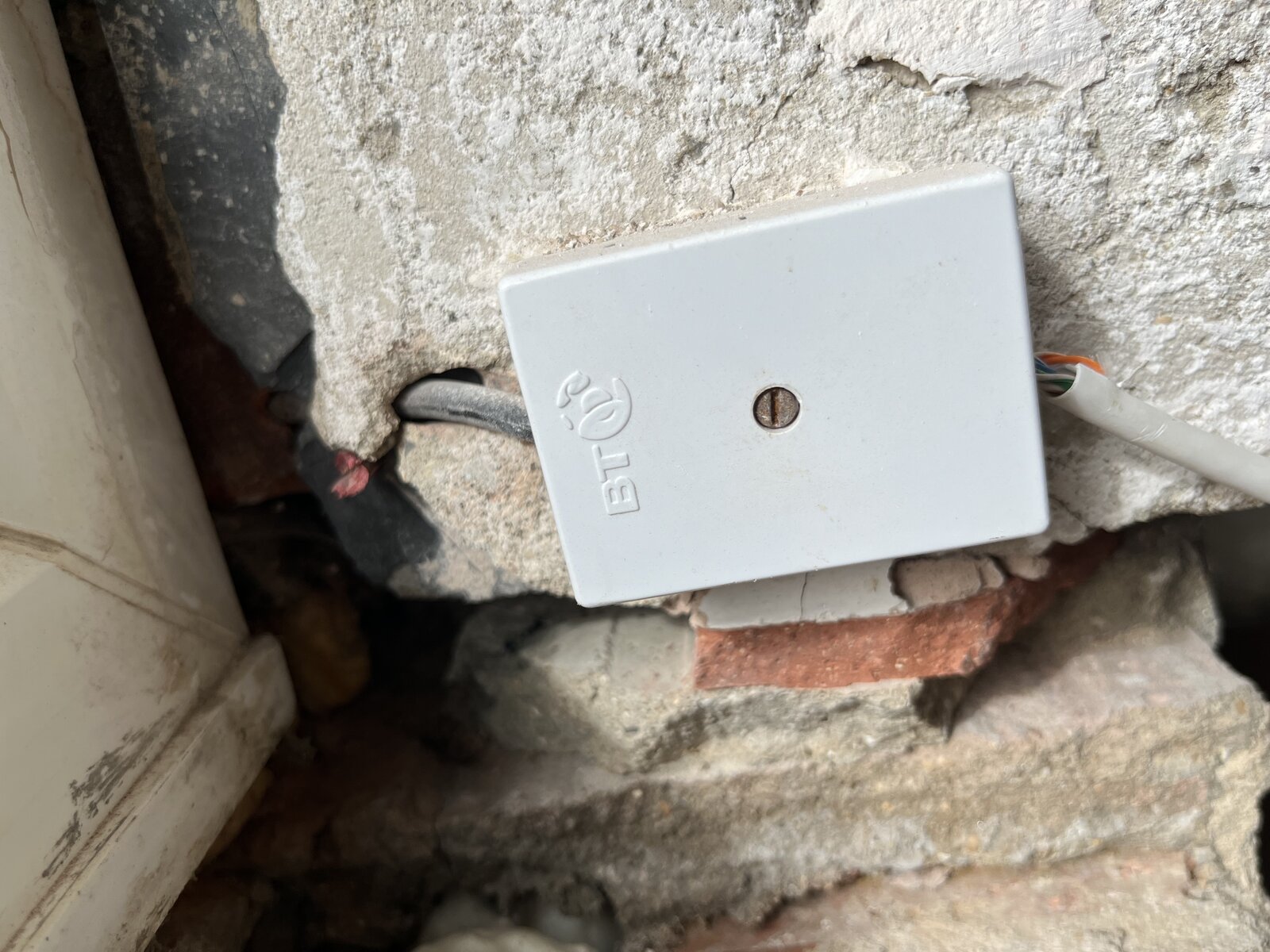

That junction box looks to be what I have in my window sill. The external cable comes into this and then a white cable from that to the master socket.
I may not have been all that clear but I want to renew the cable from where it joins the outside of my house down to the master socket, run a new cable around the house and in. would be half outside and half inside.
That is just a joint, possibly the Master socket, was located where the joint is now, but someone decided they wanted the Master where you have it now. Alternatively, the original installer simply terminated the original wire at that joint, and ran from there with indoor type cable.
Either way, it makes little difference - mount your Master where ever you want it, then run a pair of wires from it, from the A and B terminals, back to that joint.

Well, you will have to have that joint/junction somewhere, and really the best place is indoors.....
Does the cable enter below ground, or via a drop wire, from a pole. If it comes from the pole, a good place is to take it straight into the loft, then find an indoor route is possible, to where you want the Master. If it comes in via the ground, maybe take it into a cellar if you have one, or under the floor if you have a suspended floor. Failing both, you could drill a hole through the wall, at skirting level, fix the joint there, then run from there, under the edge of the carpet.
The cable you need, is just ordinary 2 or 4 pair phone cable, which is cheap as chips. Linking the two joints, to the Master, you only need to use one of the pairs - the rest are spare.

The cable comes from a drop wire and then around the house into the lounge window.
So I have to have that terminal box? I can't run the wire from outside all the way in to the master socket?
