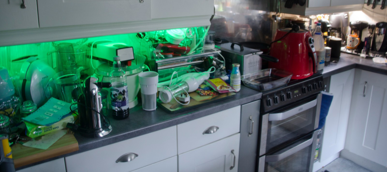

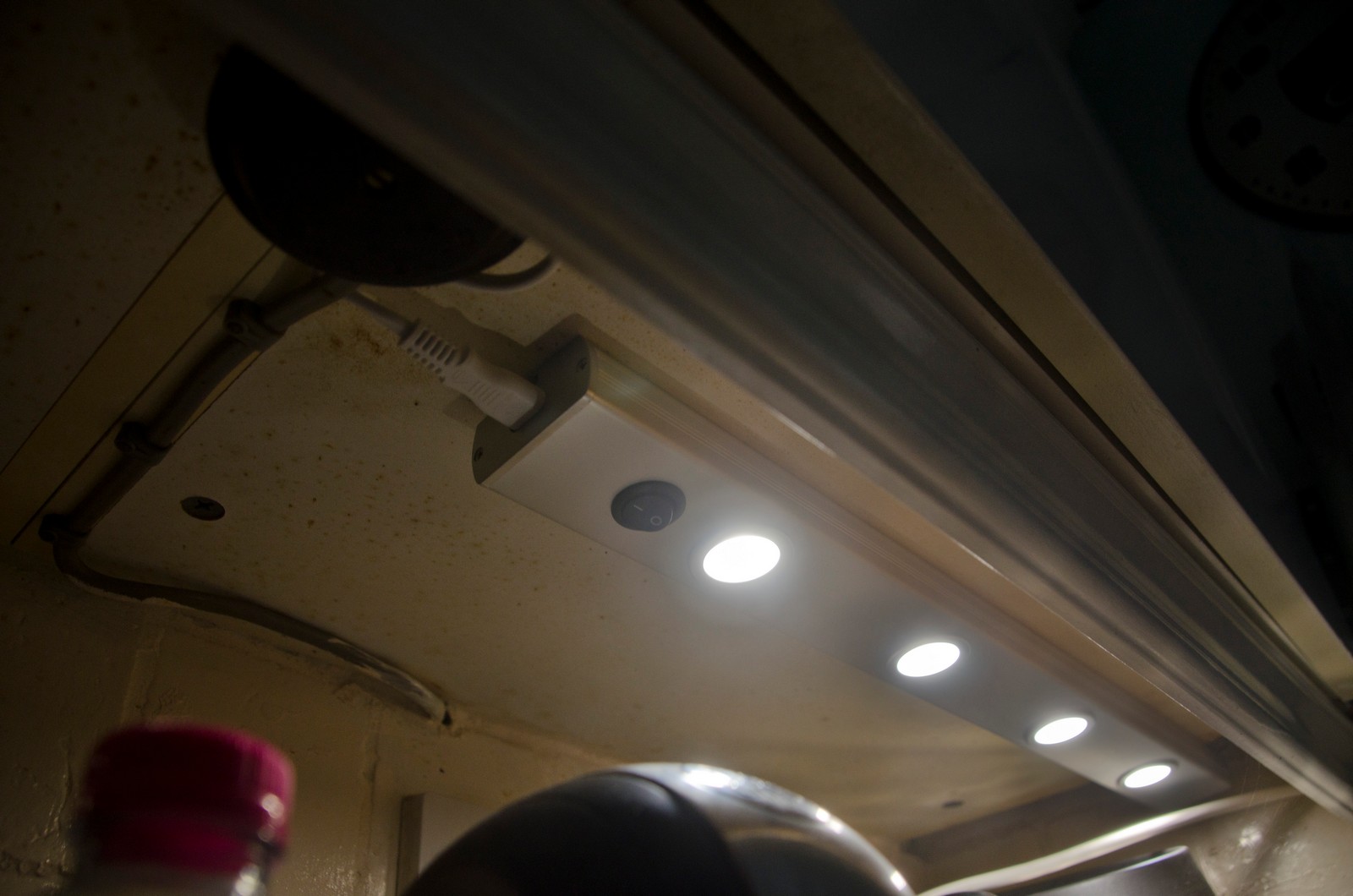

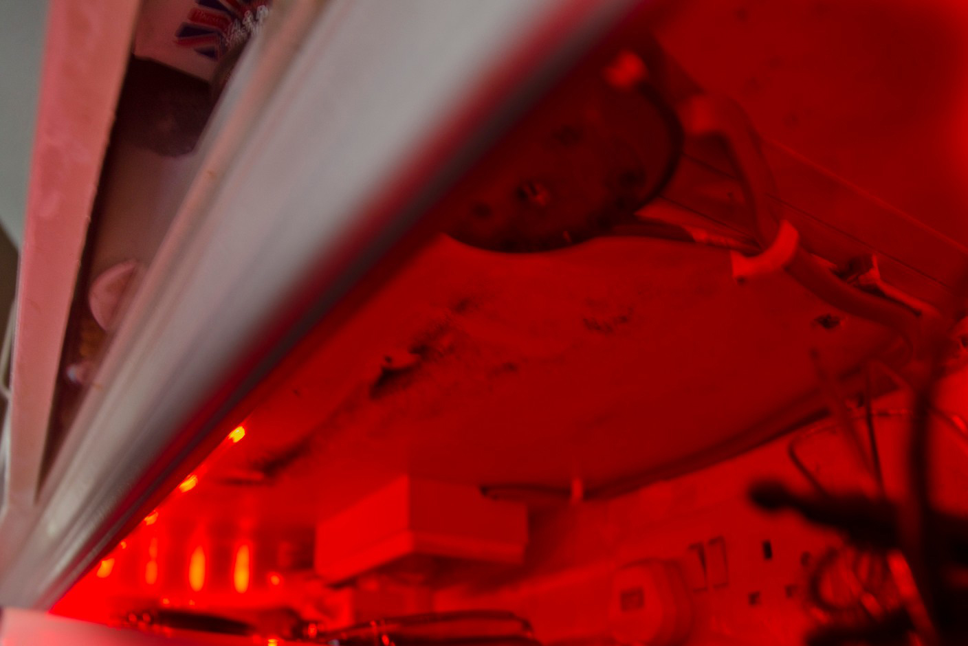

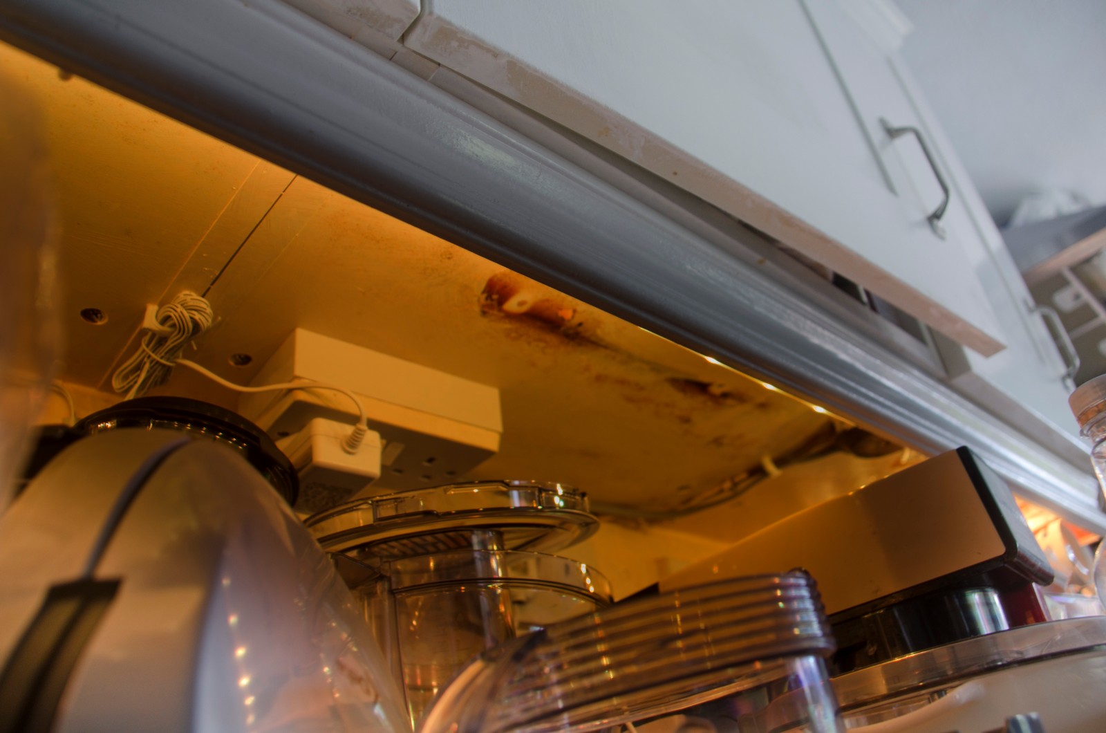

I also had connectors like that, I traced back to a junction box so right side of cooker DSC_5231.jpg fitted a light bar, but left was still working so that was done latter, same wall fused connection unit feeds both junction boxes but wanted to fit Lidi colour changing strip lights so fitted a socket where it would not normally be seen DSC_5235.jpg not really what should be done DSC_5237.jpg but since visitors will not know it exists unlikely to use it, and is protected with the fuse in the FCU, so net result DSC_5238.jpg however I know whole house is protected by RCBO's and who ever fitted the cupboards were kind enough to fit junction boxes, and the surround is low enough to hide the socket.
With most work it is a compromise, used water pump pliers to squeeze the cable clips in place so not relying on sticky back which came with strip lights. And there is the option to turn strip lights to white but needed phone. The big problem is so many lights come with wallmart power supplies so need a 13 amp socket, had I been installing the cupboards I would have put the sockets above the cupboards, but not the access, some day we will have a new kitchen and I will fit more sockets and tile around them, but not ready to remove tiles yet, so have to work with what I have.

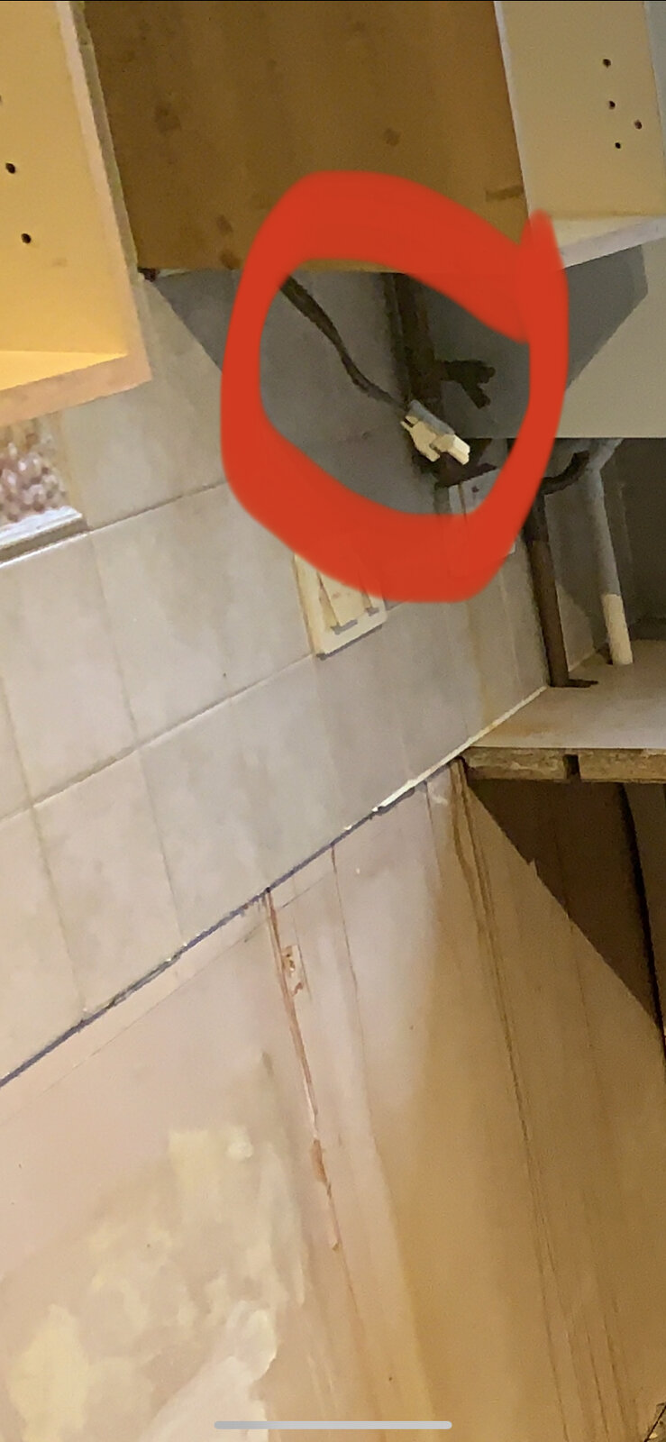

The old units are completely out now but I can’t see where the wiring is coming from. There are just 3 holes in the walls, each with a wire with connector on for the old lights.
My plan was to put a single socket on each wire and mount them above the new units if I can get the cable up that far, but I might also just push the cable back into the wall and get some battery powered light strips instead (there are some on Amazon that come on when they detect light which would work well).
In my opinion that's a good way to set the house on fire. I think you need to work out what is there first. You can't just decide that anything past that hole has nothing to do with you.
Genuine question but how is it a good way to set the house on fire? If the cables remain terminated with the connectors that are present, I don’t understand why that could cause a fire. You can see from the photo we are not talking a lot of cable, probably half a meter if that coming out of the wall at present.
It's not the specific case, it's the general approach. You do not want to end up with unknown hazards inside your walls. For one thing (regulation-wise) they are not in safe zones.
