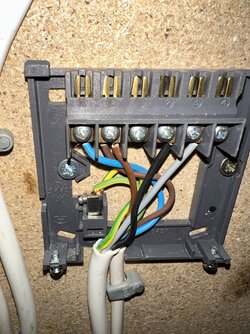

The backplate for the old receiver is below.

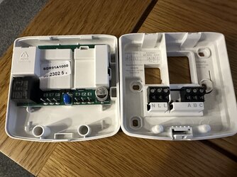

The new Honeywell DT92E receiver has a different backplate that needs to be wired in. It has a different setup - N, L, L, A, B, C.
Does anyone know if our existing wiring is compatible, and if so, which of the existing wires go in which slots?
