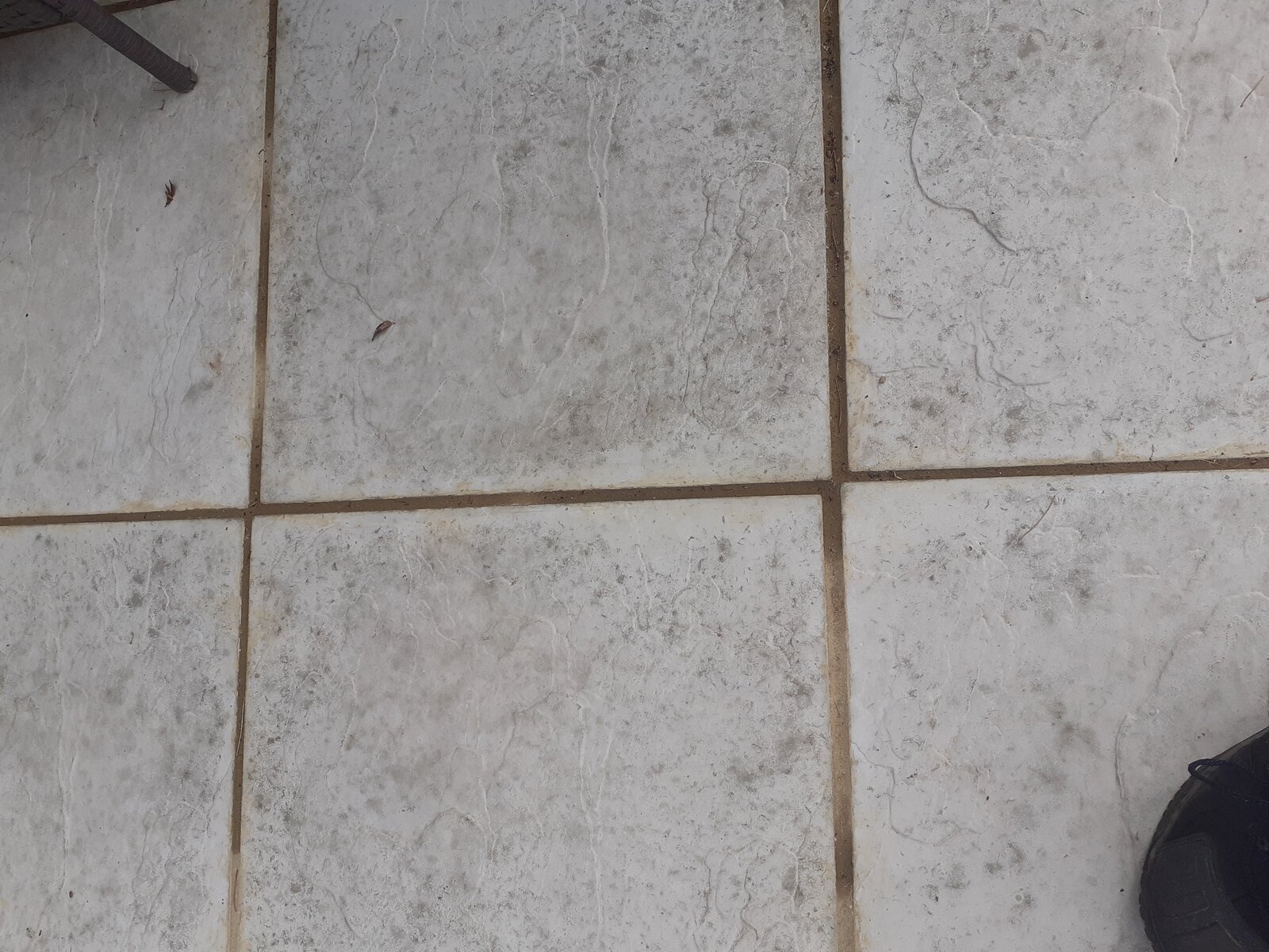

Is the best way to chip out all the old grout/pointing then use a pointing gun and bucket handle?

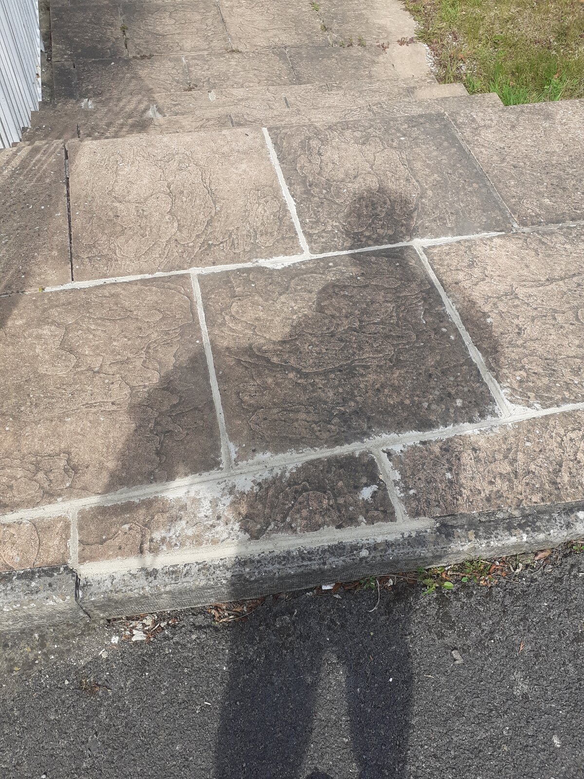

On the photo below someone (not me) smeared it on the slabs. To avoid this is it best to use two pieces of wood then use the gun to put say 5 to one cement/sand mix? Or how about the bags of grow (in photo below)?
You'll need to replace the slabs to get rid on the staining, unless you're happy to grind it off.
Then use a semi damp building sand to cement 4 to 1 mix, and pack it in and point with a pointing tool firmly.
Then sweep off the loose after an hour or so
Then keep it damp for a few days to cure.

He should of sponged it off before it dried I guess to avoid staining
No it should not have been such a wet mix and it could have been swept off. Any disaster like that would have to be flushed away wet before it cured and start again.

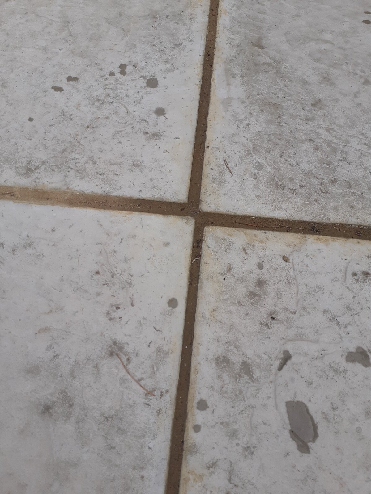

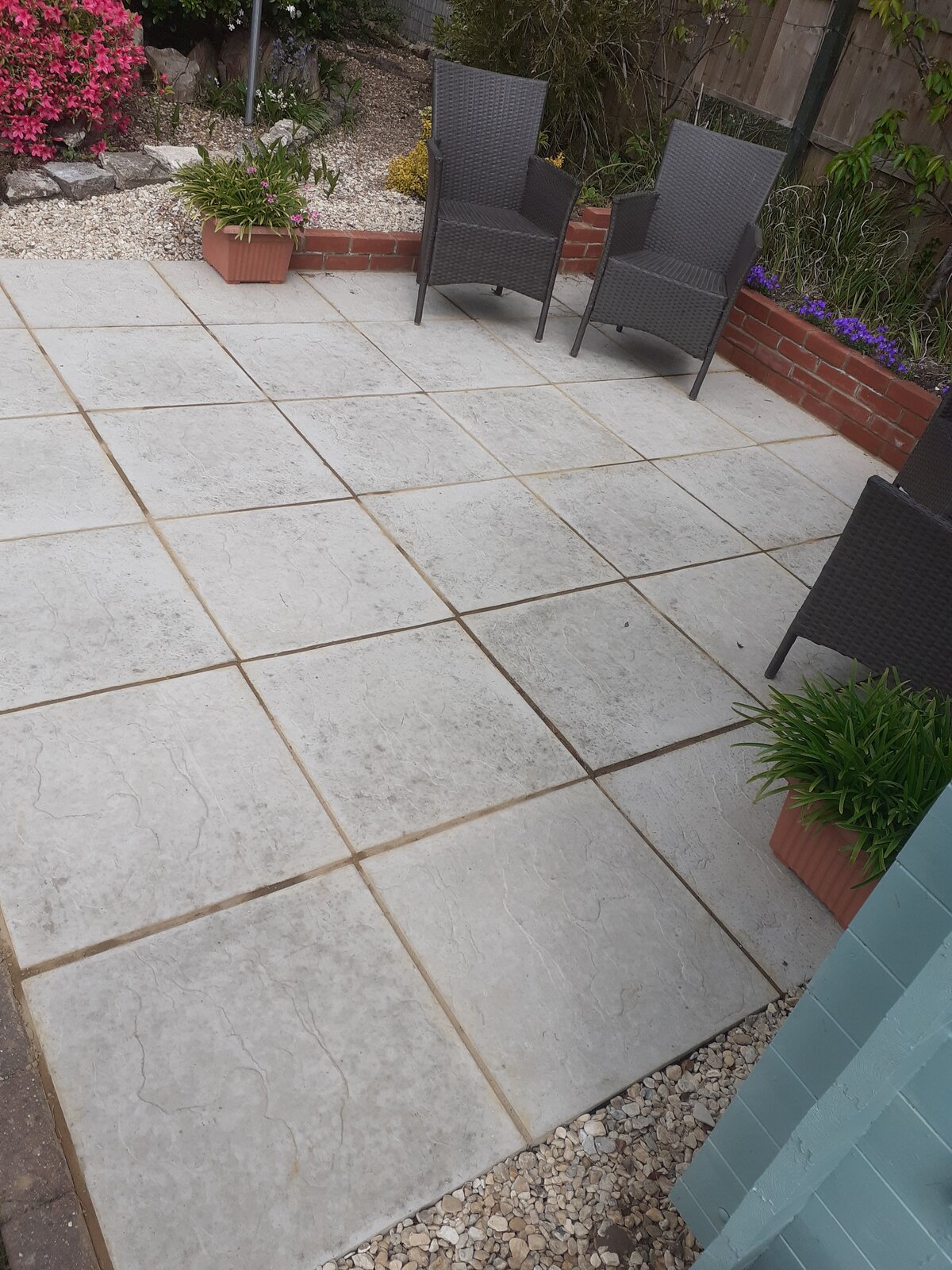

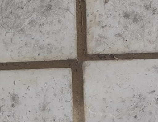

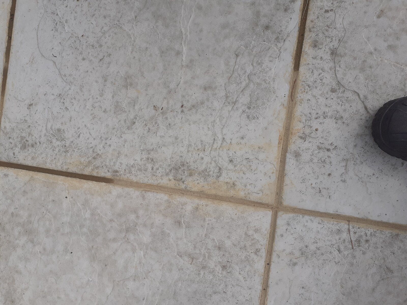

This is a patio I was labouring on for my mate, the pointing should be perfectly straight shouldnt it? And is the staining cos the mortar was too wet? I think only special cleaning chemical will remove it now. I'm asking because these two different guys caused stains and I've been asked to do some so wanna learn from their mistakes.
Water added but still crumbly (not like brick mortar) I guess
Might be safer to gaffer tape the edges
in my mind the main problem with that is the joints are all over the place! Not sure if that's what you mean by straight, but it's not a pointing problem, the issue happened when laying the slabs initially.

I meant not lined up
