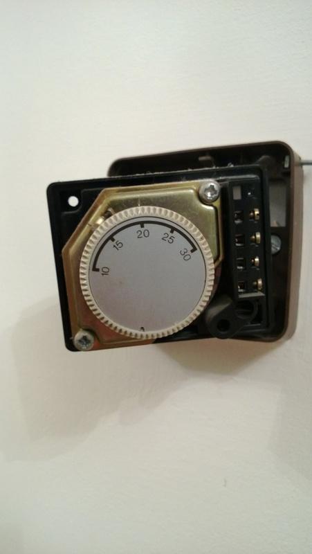

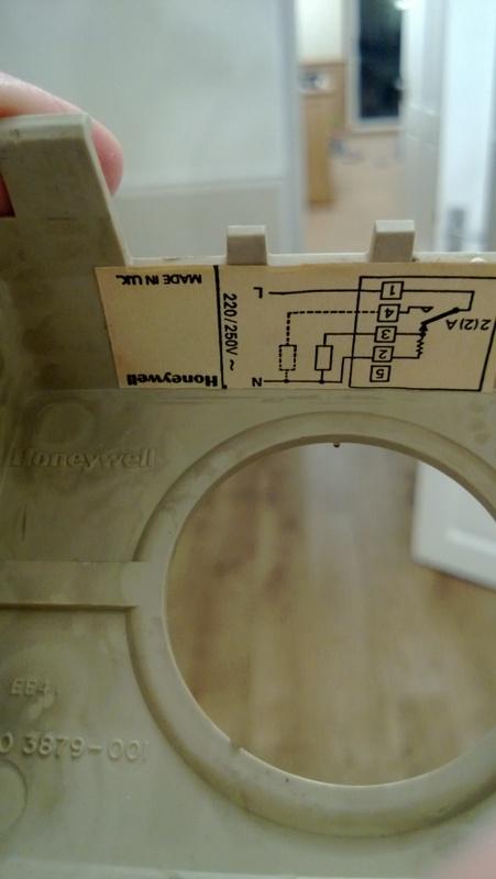

Here is what I have:
It is located at the entrance and next to is the the garage door. This means when the front or the garage door is opened, the temperature drops. Not a lot but may be enough to switch the heating on. Based on this I was wondering if it would be better to have a wireless room thermostat.
I am between the Honeywell 907 or 927. Do you think it is worth it to pay more for a wireless one just based on what I mentioned before?
Also do you think I any of both would work as replacement for my current thermostat?
thanks
Main issue with it is that it doesn't regulate the temperature properly so the house is a bit cold or too hot.
Not surprised. Old 1980's mechanical thermostat, probably well worn and well past it's 'sell by' date. A new digital one will give much better control.
Sounds like it's in the ideal position. The idea is to have the thermostat in the coolest place, away from sunlight and other heat sources. That way it won't turn the central heating off until all of the other rooms are up to temperature. If you don't have them, fit Thermostatic Radiator Valves to take care of the other rooms and stop them overheating. Your first post suggests that the bathroom maybe connected as a by-pass, so don't fit a TRV to that. Neither should there be one on the radiator in the same room as the main thermostat.
These are both programmable thermostats. If you fit them, you will need to set the existing programmer central heating function to be permanently 'on' and use the new thermostat to set the heating operating times. The existing programmer will still be needed to control the hot water functions.
Do you think it is worth it to pay more for a wireless one?
I don't think it would give you an advantage really. Wireless thermostats are normally used to allow the thermostat to be installed without having to run wiring, but in your case the wiring is already there. The only possible advantage I see is that you can try it in different places, however this can cause problems if you locate it in a room where there is a TRV fitted to the radiator as explained above.
Yes, but the 927 receiver will need a neutral connection, so if you plan to locate it where the existing thermostat is located, check one is already present, it should be. The 907 doesn't need a neutral as it's battery powered.
