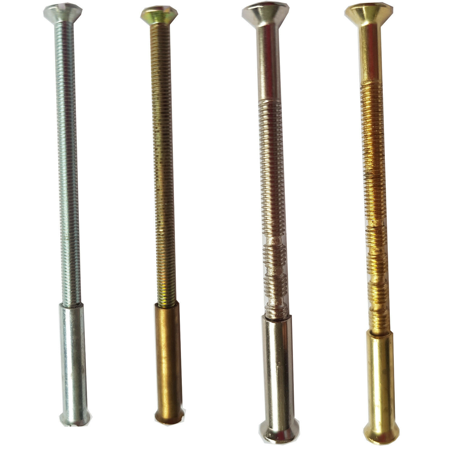

you can make out they have holes for two screws only. if you use screws with sleeve nuts they will grip through the door and you will not get screws coming loose.

The rose is not secured to the door but through it using double ended screws [often supplied with the handles].Pull force is through the handle which clamps to bar thru the door.

Lever handles on a rose backplate are a pain in the arris
especially on chipboard as the backplate screws sometimes pullout Grrr

screw from one side, sleeve nut on the other.

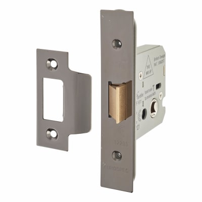

They do have a flat mortice latch in them with dimensions as follows:
Depth including front plate: 95mm.
Height (not including front plate): 38mm
Width: 12mm.
Distance to spindle from front plate: 75mm.
It looks a bit like this:
Looking at the handle on a rose design I'm interested in, the rose diameter of 50mm would mean that the screws for the rose back plate could not go very deep before they hit this latch. But does that matter? What keeps the handle on the door? The grub screw to the spindle or the depth of the screws into the wood on the rose fitting?
Last question? Could I replace this latch with a tubular latch?
Thanks again.
On traditional doors the grub screw(s), however the rose is fixed using the screws which go through it and as Notch says chipboard core does not give a stable or durable substrate to screw into. This is why modern door sets have a pair of sleeve nuts supplied with them (and to use them your lock or tube latch must have compatible drillings)

Cook Islands
The latch case in your picture is pierced to allow two of the long screws to go right through it. But is the one in your door?
If the grubscrews on the spindle are correct, and your pull on the handle on one side is transmitted to the handle on the other side with no pull on the rose or plate, the rose-retaining screws will not be pulled out.
