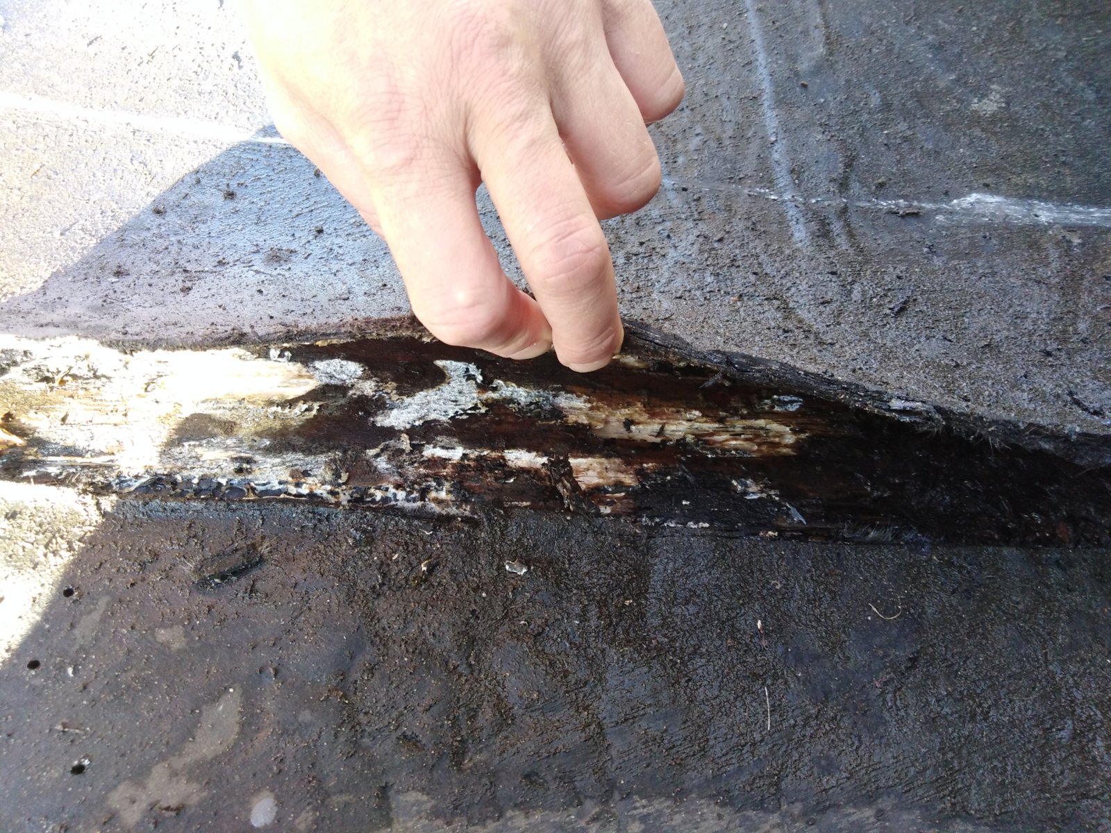

Hi All , I have inspected the spongy section of the roof and as I feared, the wooden board underneath has rotted. I believe this is due to the seam failing at the felt join.

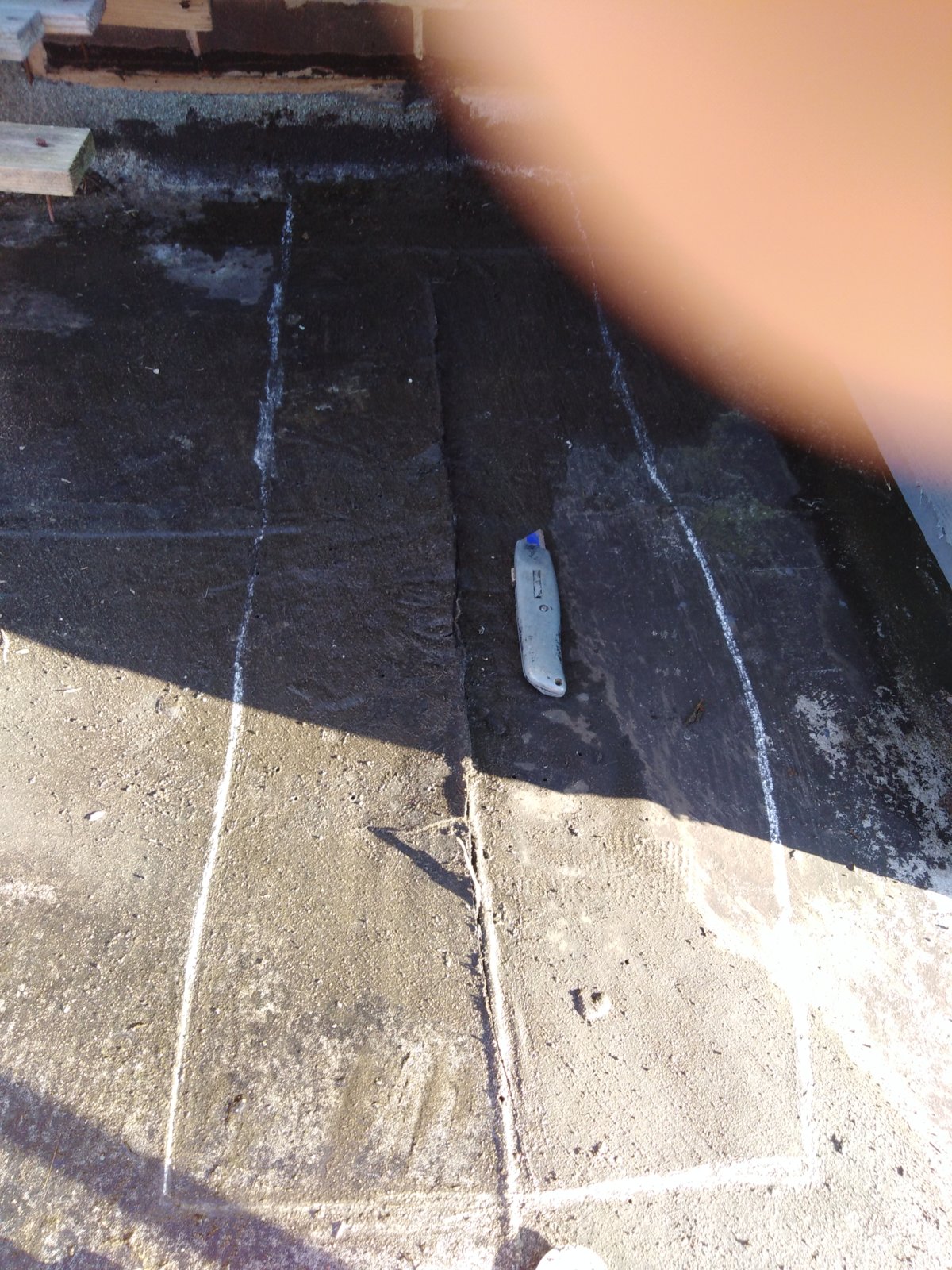

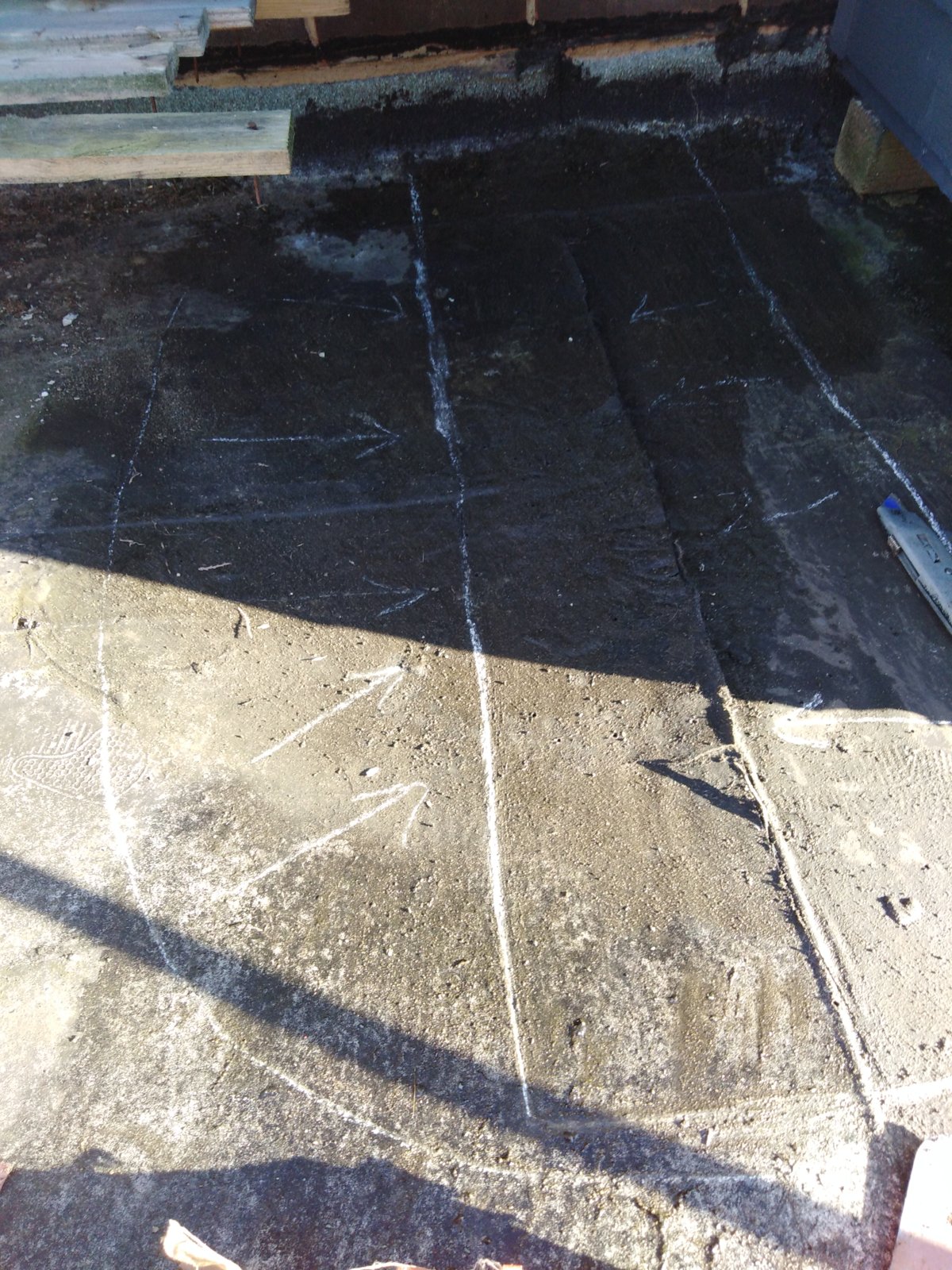

The area of rotten board is approx 4 ft x 16 inches (the area within the 2nd image white line)

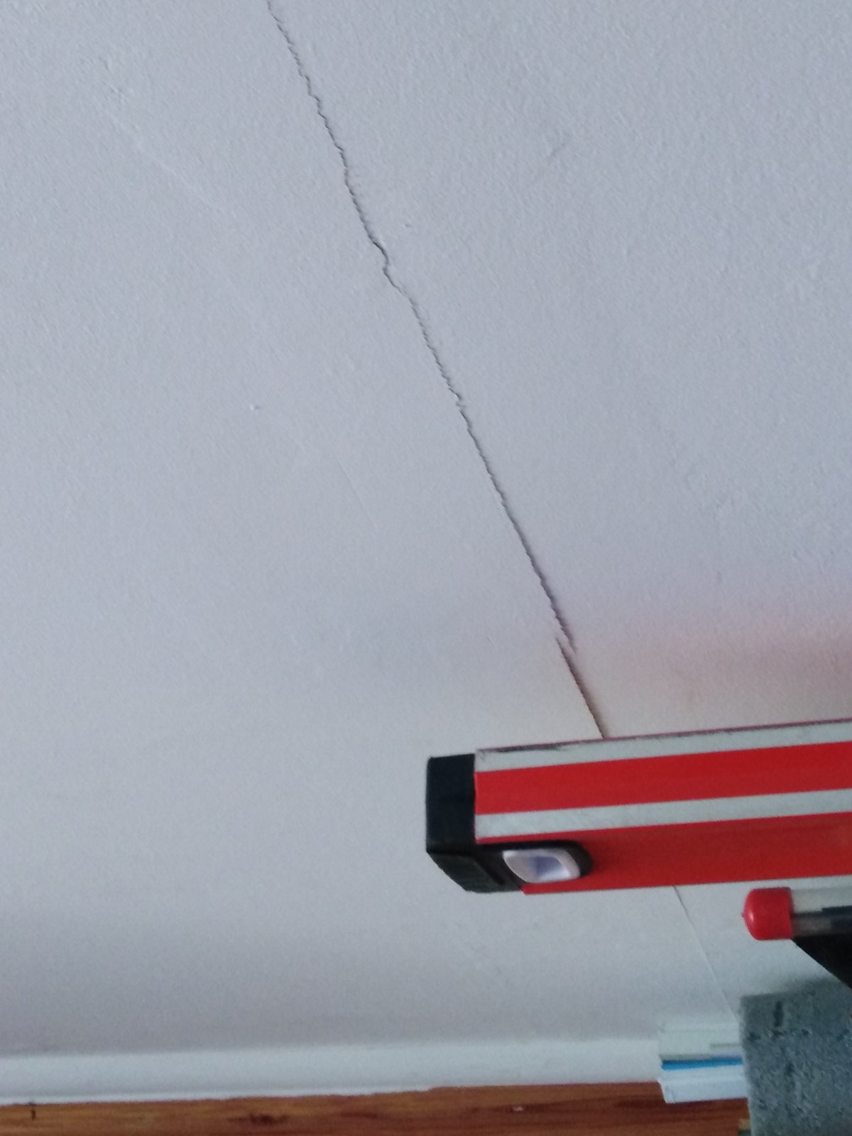

Third image shows direction of sagging towards rotten area.

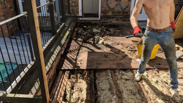

Hi bobasd, I have removed the boarding which was soaking back to second set of joists leaving an area of 1200x1200 to reboard, unfortunately the joist at the blown seam is badly rotten I intend to sister it on both sides after cutting away all the rotten wood and repairing it with a new timber insert .
What do you think
Cheers Glenn

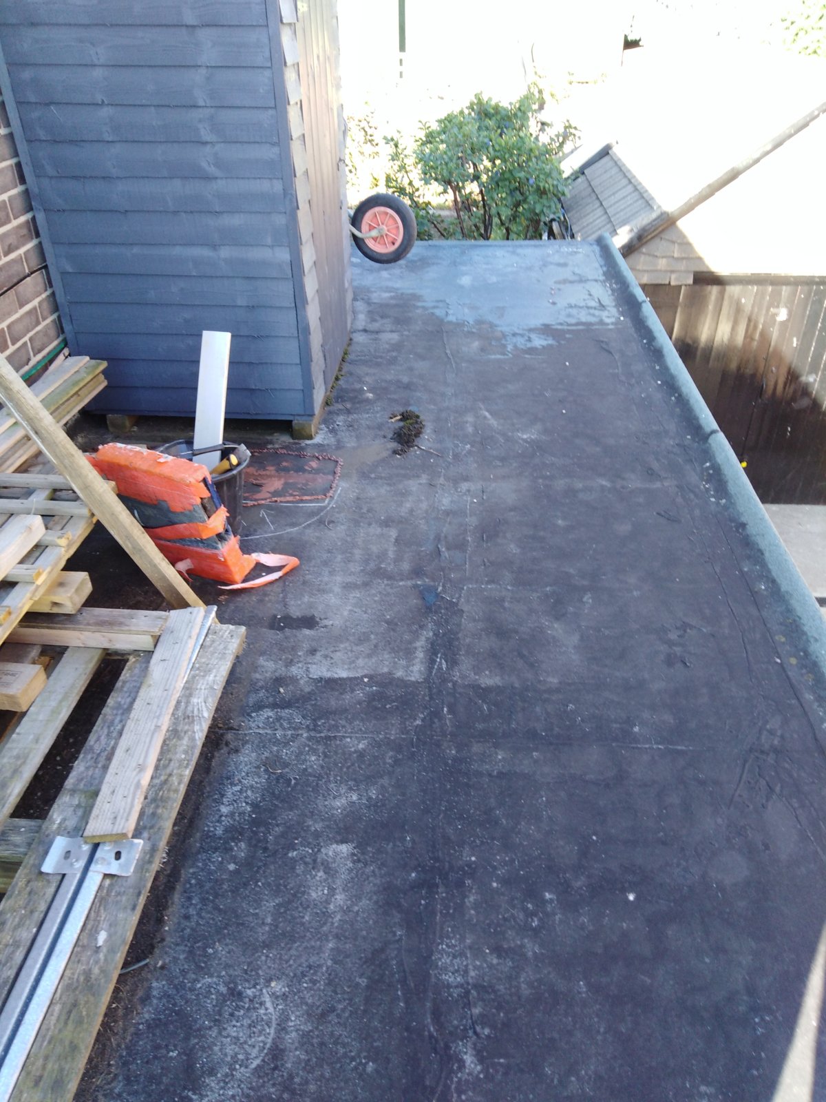

Hi forgot to ask you, would it be an idea to treat the replaced board with isoflex before felting over the top or will it affect the felt adhesive, added the photos as requested

i think your goin to have to go the route datarebal pictured.your roof has been worked on before an its time for a new roof cover.
as you strip the roof you could find more deckin an joists are affected?
storin heavy stuff on the roof might not allow for expansion an contraction an allows debris to colect.are you goin to keep stuff up there?
thers no flashin at the abutment but cant tell if its a problem or not.
Hi bobasd, I'm going to remove everything from the roof, there is some flashing and it's pretty sound, apart from where I have levered it up for access. I'm going to to replace the board and joist and then treat it all with a couple of coats of liquid rubber. Hopefully this will get me through the winter and then I think I'll look at getting it all done or put a new pitched roof on next summer,
