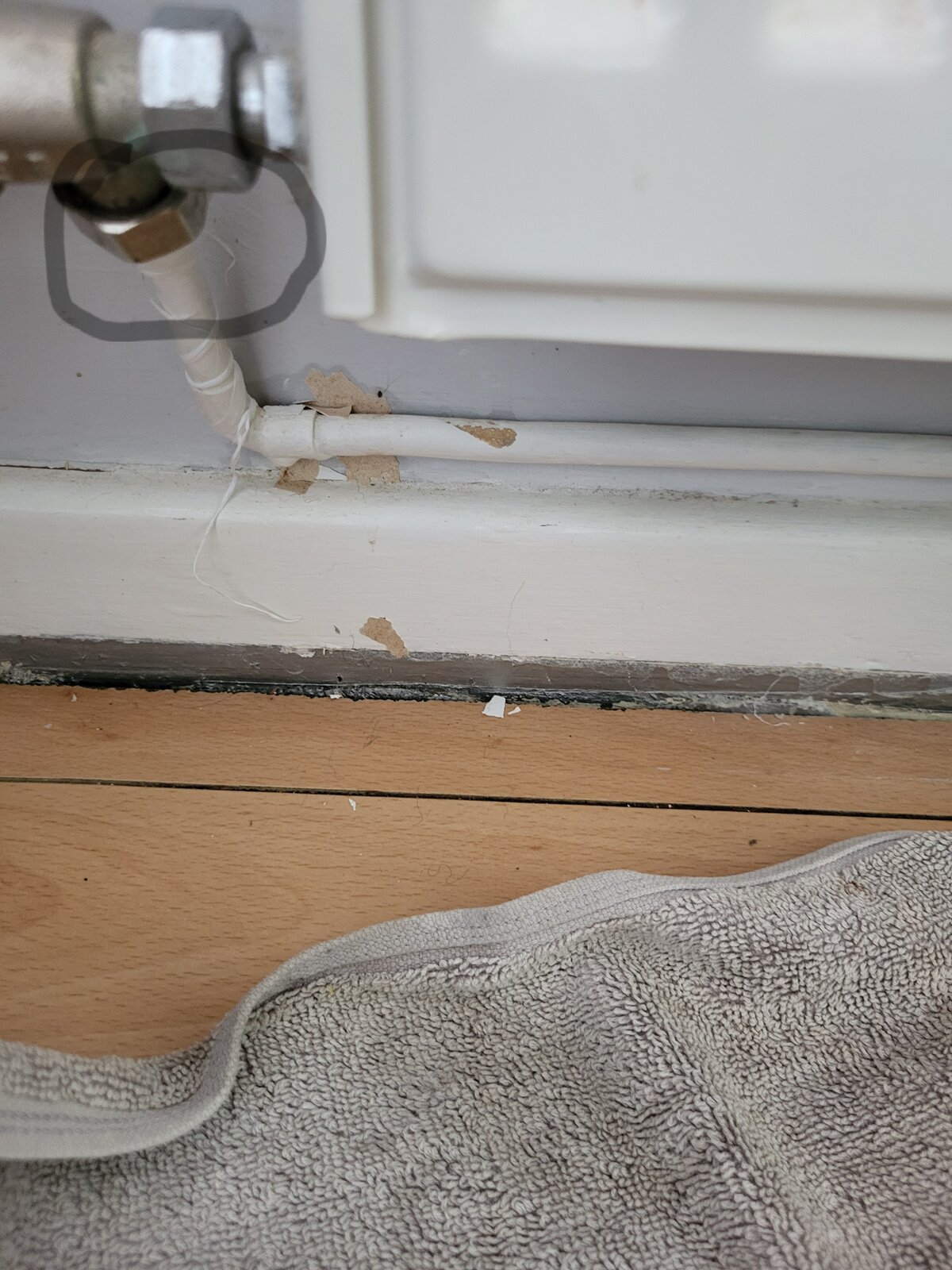

Hi, i have leak coming from trv valve see picture circled. Have had few people come round to fix but either didn't get bk to me or turn up. So I'm thinking is it do able myself? As it's leaking quite bad now and going under floorboards and need this fixing asap. Watched a few videos on YouTube doesn't seem overly complicated to replace just worried about the amount of water that might come out? Any tips on doing it?

If you release the pressure through a bleed valve be a few pints of water
then you should be able to change it with little to no water coming out , shut the valve off on the other side of rad beforehand

You’ve circled the connection between the valve and the pipe. You may not need to replace anything; just dismantle it, clean up, and reassemble carefully with some PTFE tape around the olive.
Personally, unlike @gaz112, I would not try to do it without draining the system to below the level of that radiator. But I’m just an amateur! The pros have some anti-gravity magic that makes the water not fall out.
It's called a vacuum - if air cannot get in to replace it, then the water will not leak out.
I would suggest closing both the lock shield valve off, and the TRV - your only possible source of water loss will then be via the disconnected pipe. any accidental flow from that, could then be easily stopped, with your thumb, or more permanently with a cork.

You’d expect that, right? Based on where the leak is, between the pipe and the valve.
