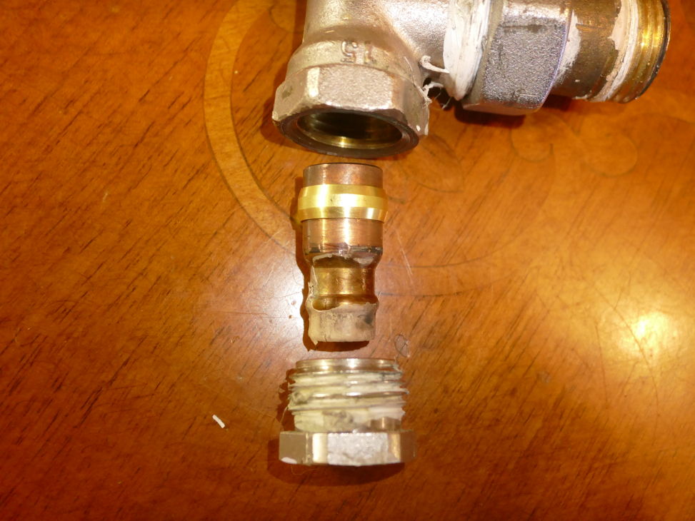

Hi,
I am looking to replace some TRVs that have stopped working on 4 radiators, however, the setup looks a little unusual. The pipework is 10mm but the TRV looks like it might be 15mm with some sort of reducer going into the TRV from the pipe. The reducer doesn't look like anything I can find on Screwfix/Toolstation and so I am guessing it is either a really old fitting, or I'm just looking for completely the wrong thing! I have attached photos of the TRV and the lockshield. The lockshiled looks to me like it is a 10mm lockshield as the pip is 10mm and it looks like the lockshield has been attached directly, so I think it is just the TRV side that is the unusual setup.
I just want to know what the current setup is and whether the "nut" between the pipe and the TRV is a reducer, and whether I can just re-use that and effectively do a like for like swap of the TRV. If not, then any advice on what fittings I would need would be much appreciated as I am not really sure what I need and want to make sure I have all the right parts before draining the system down.

My TRVs look like the one on the top, and even though the pipe is 10mm, there is a small adapter there that brings it up to 15mm. The adapter is soldered on to the 10mm, and you are right it is a bit weird because it has a 15mm outside diameter on one end, and 10mm inside on the other. Although it does not look like it, the bottom on mine was a compression fitting, and the new TRVs with have a nut with a female thread rather than a male. So you will need to get some 15mm olives and pull/cut the old olives off. If the fitting to the rad is 1/2 inch, then you are good to go, but if it is 3/4 (like mine) then you will need to change the tail as well. Usually the new TRVs come with a tail. You will need a radiator tail wrench to get the old tail out, you shove it in the inside of the tail (pipe sticking out of the radiator).
If you like I can post a some pics of one of mine taken apart.
Hi sirocosm,
Thanks for the reply - that would be really useful if you have pics of your one taken apart - that will probably help me understand better what is going on - I was looking at the valve not long ago thinking it would help if I knew how the parts of the current valve fit together.

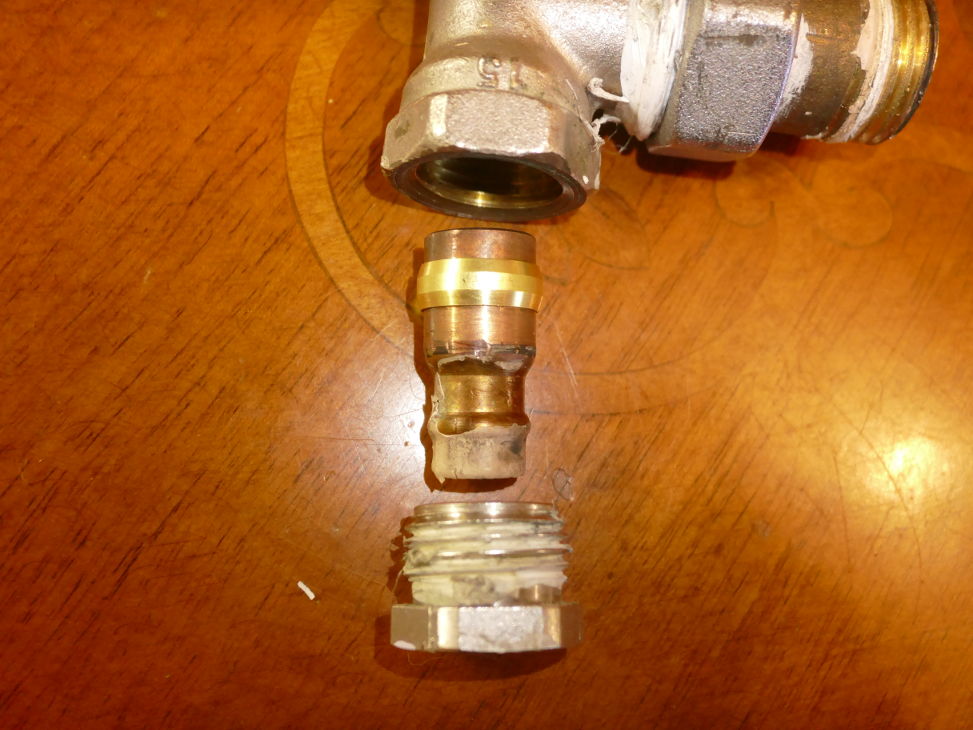

Here is what mine look like taken apart. The bottom of that copper adapter was soldered onto the 10mm pipe. It was the first time I had seen that type of compression fitting, with a male thread on the nut, and female on the valve. The new ones will be the other way around.

The valve in the picture I posted has a 15mm compression fitting, even though it doesn't look like it (note it has 15 cast in the brass), so a new one will swap right in. The only tricky bit is getting the olive off. I did a few at my place last weekend and there was no cutting or soldering involved.

What Savo has ,is nothing like what you have.
His lockshield has 10 mm pipe into a 10mm valve ,with 10 mm olive.
The TRV has 10 mm pipe into a 15 mm valve and a mechanical reducer.
What your pic shows is a Yorkshire 10 to 15 fitting reducer,which gets soldered onto the supply pipe. That's what I advised him to use.
That is the fitting reducer that was soldered onto your pipe. Nothing like what Savo has.

So if Savo takes that valve off, what are they left with? just a 10mm pipe sticking out? The TRVs I bought also came with little brass adapters for 10mm.
