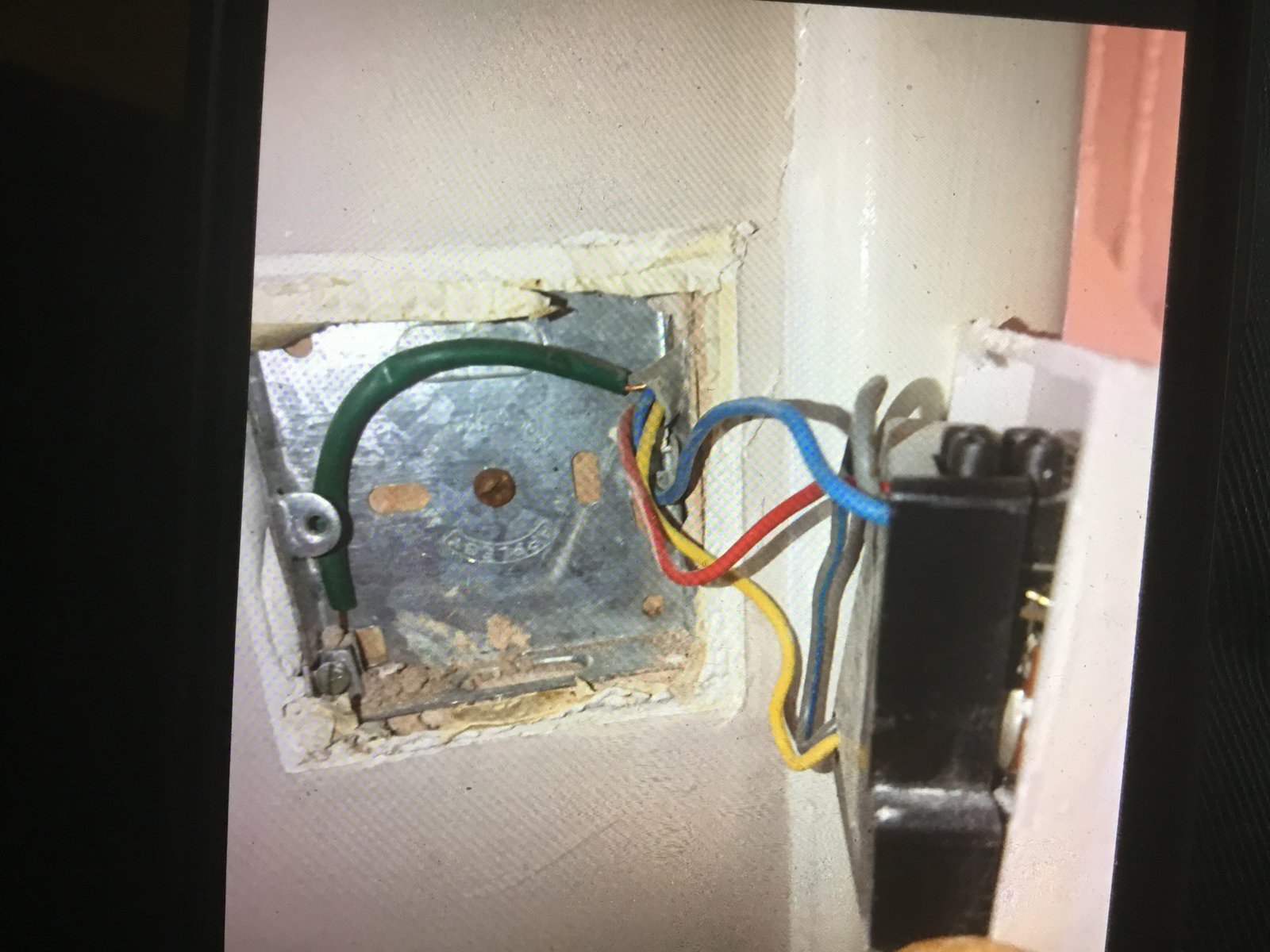

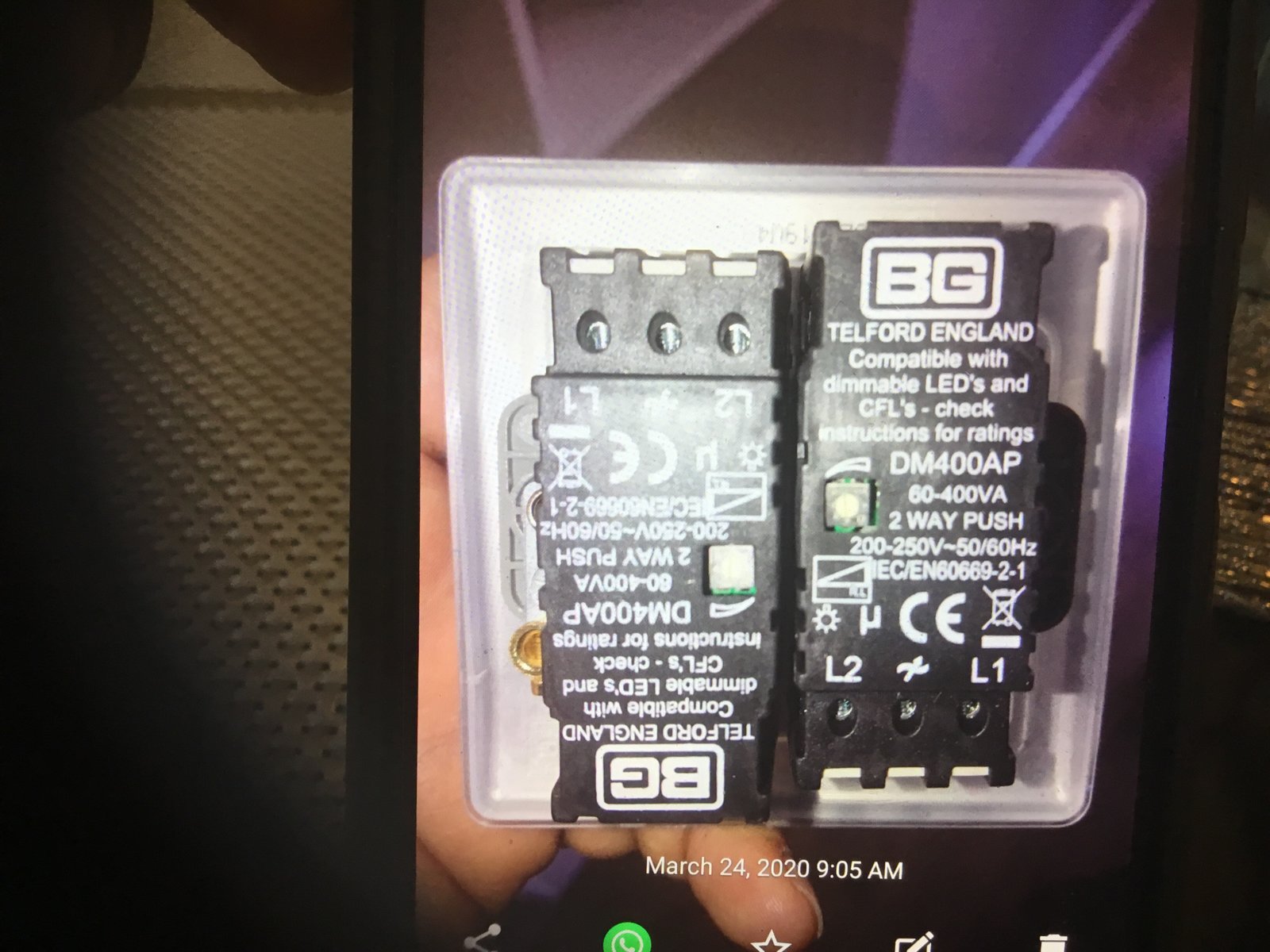

Good day all,
Wiring on current switch and new switch attached.
From what I can see for the new switch, the live in needs to go to common on block 1 and
a connecting wire from this to common on block 2. The neutral IN needs to go to L1 on block 1 and a connecting wire from this to L1 on block 2.
This should complete the loop so each switch turns on and off the different lights.
Ights
Oh and the and the EARTH IN to the earthing point on the switch.
Am I missing anything ? All replies gratefully received

If you connect live to COM and neutral to L1 as soon as you operate the switch you will trip the MCB and probably damage the switch.
But do you actually have a neutral? To me it looks like a live (red) looped to both switches (grey) and two switched wires (blue and yellow).
27 Jan 2008
19,509
1,856
Llanfair Caereinion, Nr Welshpool
It does seem with BG the
means common, this is not always the case, so link to commons with red and yellow and blue to L1 terminals, however this is not how it is always marked, it varies make to make.
As far as I can tell there is no neutral it would seem all cores are line.

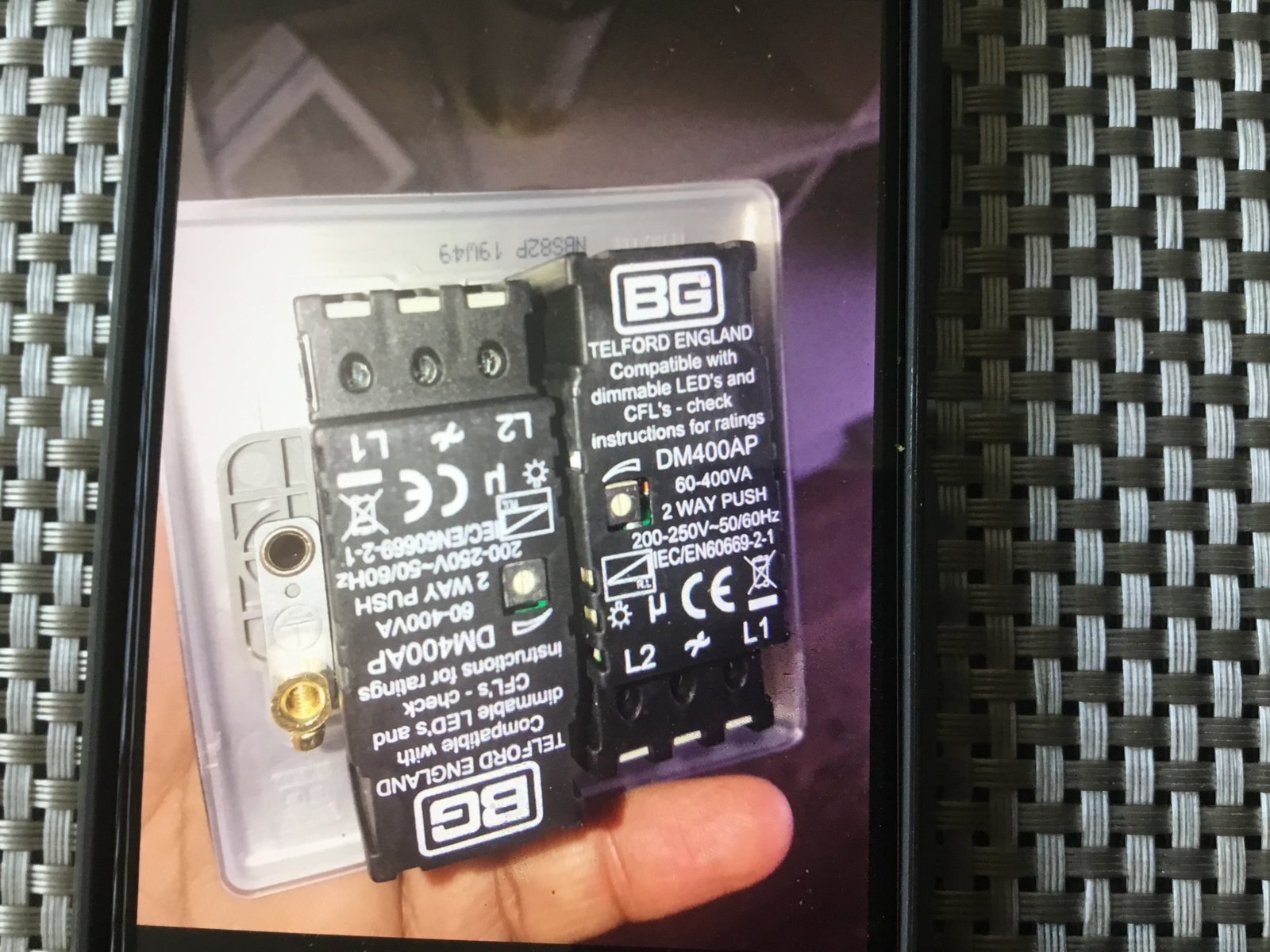

Thanks Guys,
It looks like you are right ...I was trying to go by colors..
So yellow to L1 , blue to other L1, red to m
Which will be connected to the other
With the grey.
The earthing looks like it’s taken care of.

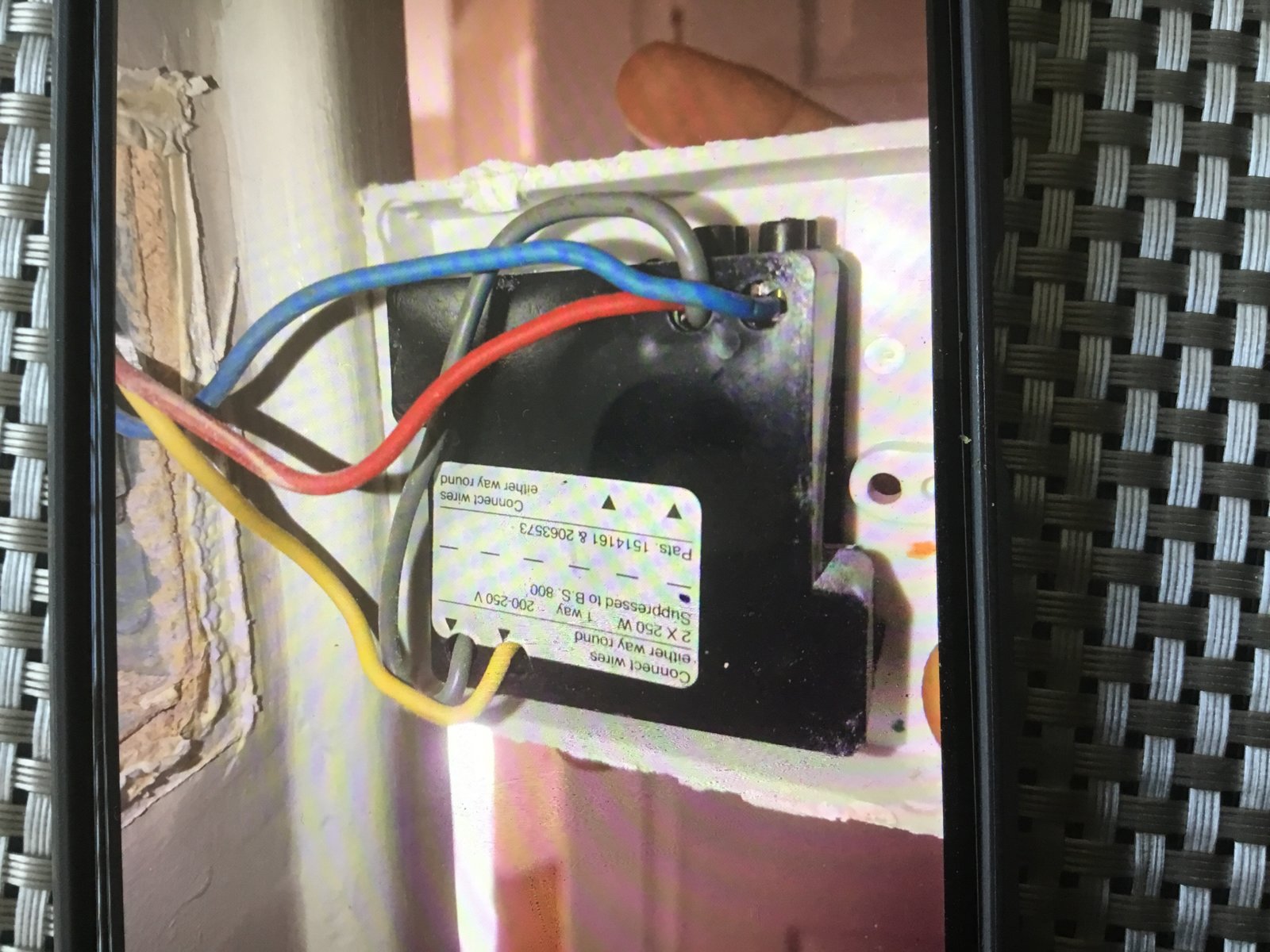

The last pic is that of the existing switch and it’s wiring.
Trying to replicate that on to this which is the new switch :

So yellow to L1 , blue to other L1, red to (common symbol that won't quote) Which will be connected to the other
With the grey.
Yes, that'll work.
I would move the earth from the backbox to the faceplate terminal and add a link from it back to the backbox.
